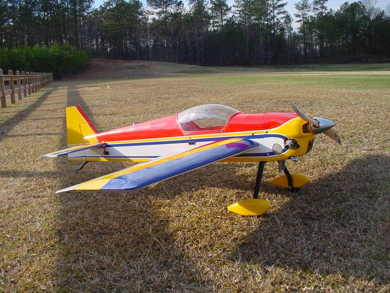

THE BLING! You can see where the pitt mufler comes out flush with the cowl.
Serge

Very nice looking Bling. Great job on the cowl.

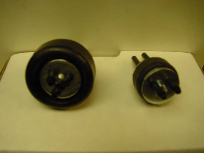

Does Seagull Models have a different fuel tank stopper for gas and glow? The Dubro tanks do!
Here you see two Seagull tank stoppers, seven days ago the one on the left was the same size as the one on the right.
I placed the left one in a small amount of gas and after a week the gas turned black and the stopper got three times bigger.

Serge,
Will a gas dubro stopper work on theseagull gas tank?

woah[X(] im surprised you pulled that stopper out of the tank without splitting the tank! that is huge, try using a Dewey Broberg Stopper (Du-Bro for those of you who don't know) they work great on all tanks.

I'll check on that tomorrow and get back with you.

BTW, I'm taking the Seagull tank out and replacing it with a proven DuBro one with a gas stopper.
I don't need a swollen stopper leaking all over the place.

No it doesn't, It's the correct diameter, but not long enough.
Serge

What size dubro tank are you going to be using. I think the one from Seagull is around 24oz. Is that the size dubro you are going to be using. I to want to change the tanks becasue I don't want gas running around on the inside of the plane if the stopper from seagull is no good. I am going to be using a Brillelli 366GT and I want to use a least a 20oz tank.

its even weird that since this plane was designed for gas, seagull mentions to use silicone tubing! this is what is weird with foreign company planes, that going with what i said earlier about the manual and instructions.
