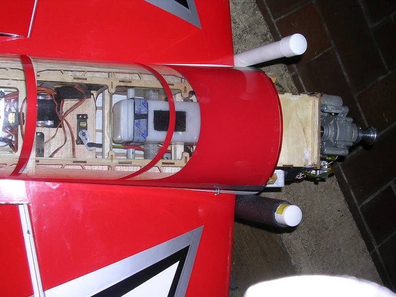

i dont know if you guys have made this change or not but putting the tank on the cg turned this plane into a whole new animal, i changed it after the first maidens...with the tank in the nose even balanced at behind 6" she wanted to nose over...i would reccomend the pt prop the finish is not quite as nice as the mejzlik but its a little quieter but it doesnt come balanced...

CG on this bird is front edge of wing tube. How do you mount the tank centered on that?

some people have done it under the wing tube i did mine on top. i had a problem with my wing bolts not tightening so i glued the bolt ,cut the heads off and got threaded spacers with cotter pin to hold the wings on much better now built the tray with 1/2 inch balsa then pinned then from the outside...pictures were midway through but youll get the idea..she balances perfect now full tank or empty...and you can hover or knife edge at low altitude and see how much gas you got left....

Very cool, great pics. The access to the wing retainers was my main question. I always have preferred a tank on CG....may have to mod this one to copy yours. Thanks!

if you do it under you have to cut away some of the landing gear area i wasnt into that...i just cut that small top brace wich was basically replaced by the piece of balsa..also under the tank is a piece of bass wood between the balsa strips

i would say the only drawback is you have to unstrap the tank and slide it forward before and after to get the wing nuts on but it only takes a second...glad to return the favor you helped me alot on the qq build
