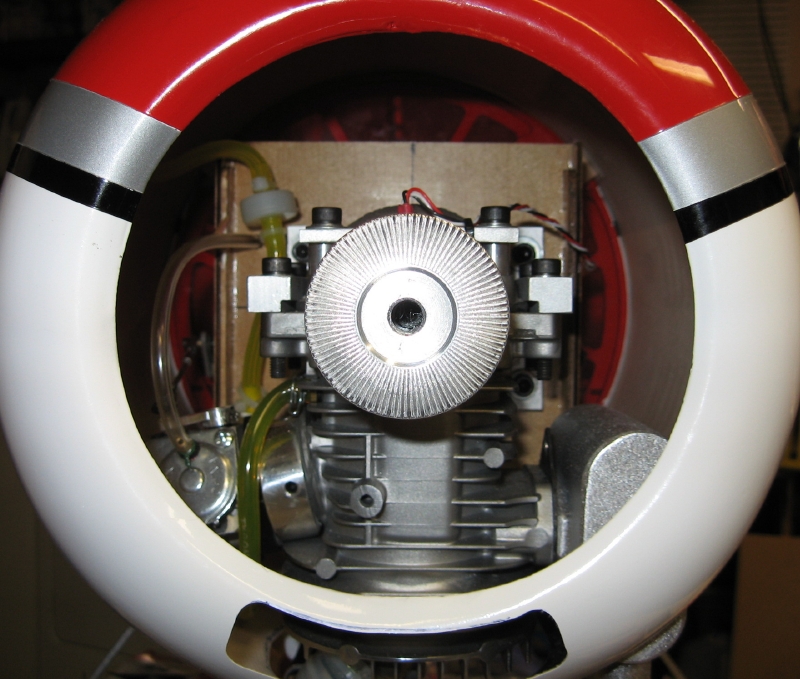

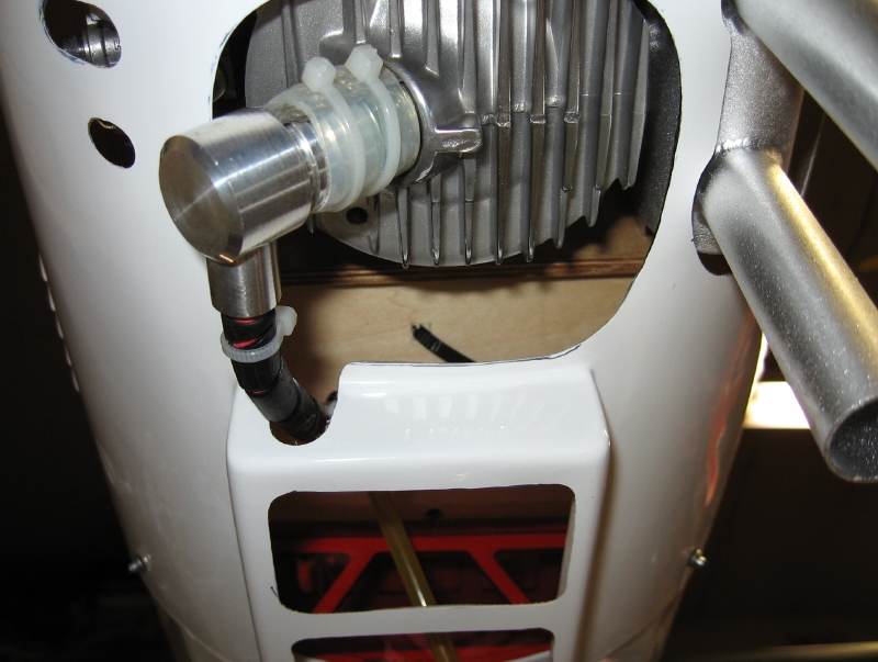

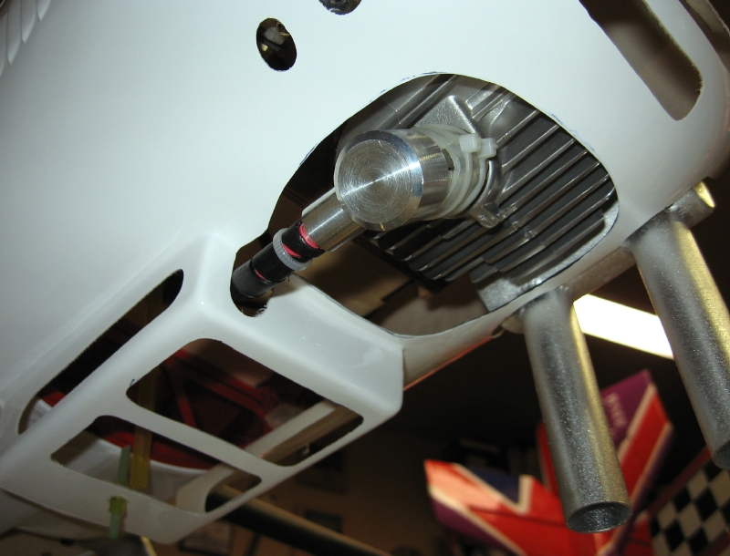

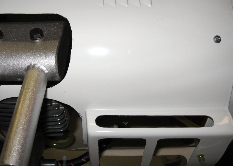

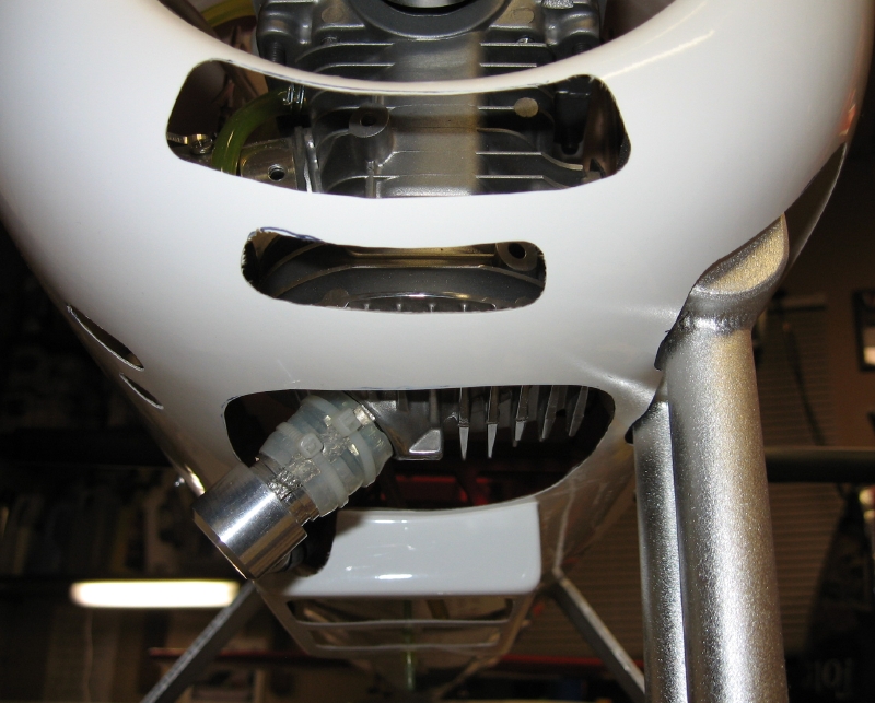

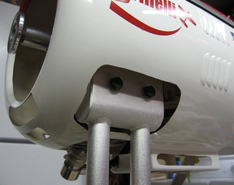

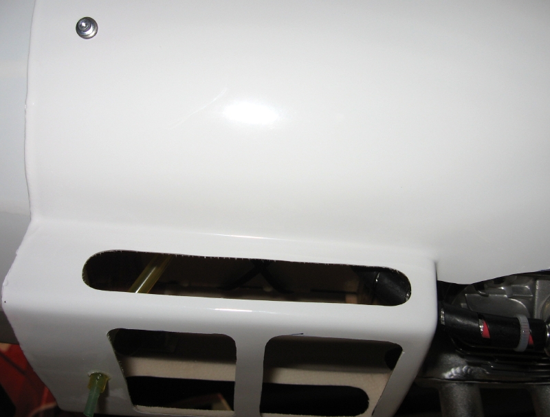

Bob - I'll be happy to do more detailed pics (supposed to, anyway).... and will. Some of the answers...
1. Engine mounted flat to firewall, no spacers, at about 6". Cowling not a problem going back further
2. HEAD *DOES* clear inside the cowl. Plug cap connector, choke, and muffler need holes access.
3. Operate the choke with a small, straight blade screwdriver. I cut off the "arm", slotted the nylon shaft, glued on a small "collar" of brass tubing so the screwdriver wouldn't cam out when turning. Accessed through a hole in the cowl, it doesn't protrude. Neither do the carb adjustments, just a hole to get to them.
4. Carb arm - clears just fine.
I aligned the motor per the measurements in the manual, life is good. Fits very well.
Cuttting the cowl is very important; there needs to be air getting OUT of that big bowl, and heat build up could be a problem. My pics will show how I addressed that, I hope.
Thanks for the comments.

Allright here are some pics. If this doesn't look "elegant" enough for some, please skip this post. I'm not after "form", I'm after FUNCTION, and that means air exit opportunities. And reasonably-directed IN flow....so here's mine. Very similar to how I did that "other" 73" Yak (RIP)....
ORIGINAL: RJConnet
aerobob,
Enjoyed your web site covering your work on the Yak 54 Brillelli 46 combo. I have done about all I can on mine before tackling the job I hate worst. That is mounting the engine and cutting the cowl. What I would really like to see are some close up pix of the cowl and the cut outs required to clear the engine head, the side-mount muffler, and possibly the carburetor. It looks like the carb will be very close and there will definitely be a clearance problem with the choke lever as supplied and no room for that nice inlet horn that comes on the carburetor. Also, to avoid weight in the tail and tail mounted battery packs it looks like the engine could mounted about a half inch closer to the firewall than called out in the instructions ( 6 inches instead of 6.5 inches to the prop drive washer). What do you think about that? I just can't stand the thought of cutting up that beautiful cowl and making a mistake that will make it ugly.
One other thing, I could not see how you are operating the choke, maybe another close-up of that area would be helpful. Thanks for all your comments thus far, keep them coming [8D][8D]......Bob C
aerobob,

Aerobob,
Thanks much for your efforts, I,m still not going to enjoy cutting up that cowl but your pictures will make it much easier.
Thanks again.[8D][8D]......... Bob C

PM me if you need more exact dimensions. The muffler opening APPEARS to be too wide, but that was needed to allow the cowl to be installed WITH the muffler on the engine. The angle of the cowl front/engine hub down to the rear-most exhaust tip is what drives that. Difficult to explain, but hope this helps.
FWIW - Carving on a cowling is also WAY DOWN on my list of "things I enjoy".... also....
It seems just so WRONG to do....

FLYMIKE, the total muffler weighs 2.3 oz, so there isn't much weight savings in cutting the pipes.
Bob, the Bisson mufflers with the rolled tips BEG to have the pipes cut. That is ONE good reason to cut the pipes
This muffler with straight pipes doesn't obstruct flow the way the tips on a Bisson muffler would.
