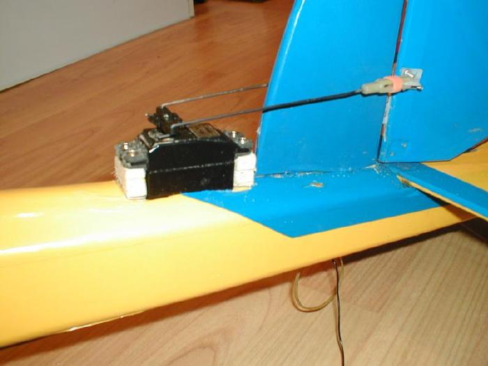

Default Aft mounted rudder servo!!
Here is a pic of my rear mounted rudder servo!!!!!
Old 02-01-2003 | 02:34 AM
citation X's Avatar
Posts: 228
From: Arlington, TN
Default another pic
one more pic of the rudder servo...
