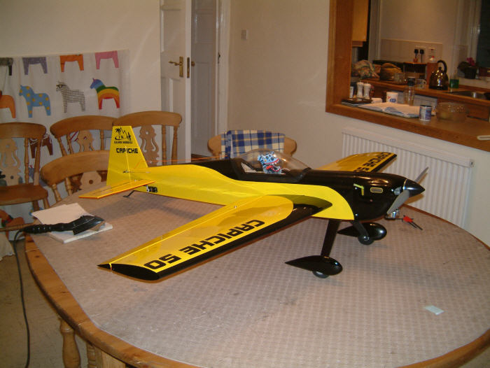

Squeezed in another hour and a bit tonight (girlfriend was washing her hair :stupid: ). Now finished the rudder, fin and stab. Still need to be sanded and beveled, and have the hinge slots cut. Shouldn't take long.
Not a huge amount to say. The rudder comes out very stiff like the elevators. Weight of all is 63g (about 2.25 oz).
I am surprised that the fin and stab are sheet and not built up, not a problem, just a surprise. I do recomend putting on the cross grain capping as suggested in the instructions/plan. I noted that the fin could bend quite a bit. Fine once the capping in place though.
I'll try to post the photos when I get a chance.

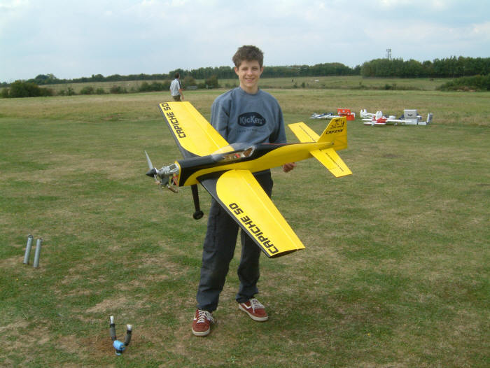

It Flies!
I am really pleased with the Capiche 50.
The Saito 72 hauls it skywards like a rocket!
Even though i am not at all comfortable 3Ding it yet because i am unfamilliar with it, it is very precise in rolls, and knife edge is fantastic!
Mine will do 45 degree descents in knife edge!Thats almost a knife edge elevator!It needs a liitle bit of coupling- when doing knife edge using right rudder you need a bit of right aileron and down elevator, but mine wont yet fly dead straight like The Boys Capiche yet.
Archie's comments about it being slightly more unstable than a 3D funfly in the hover are bang on.
Once i get used to this, and get the setup right, its going to be a briliant performer.
I havent got any low knife edge pics because i didnt feel comfortable bringing it down low yet. It will do a very good Knife Edge vertical eight.
The very light wing is perfect for snap rolls- the wing stops moving round instantly when you centralise the sticks.
Blenders on 3D rates are absolutely mental!
It didnt want to harrier though(it was rocking its wing quite badly)- I had 40 degrees movement on the elevator with the CofG at 130-135mm back.
Maybe i need more elevator movement.
Need to tune the Saito 72 though. The idle at the moment is too high(3500 to 4000 rpm)- it will quite happily cruise around at this idle speed. Looks like i might have to do deadstick landings at the comp tommorrow.
So far though, what a class plane!

good o, turn the idile needlt in! my west needed to be fully closed on the bottom end for it to idle below 2k, maby yours the same
Is that person in the back of the pic fetchina a deadstik model? LOL kinda randomly walking away!
