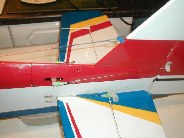

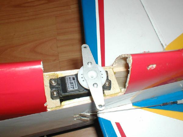

This is what I did, and at the same time was able to gain access to beef up the sides of the fuz where the stab passes through.
Had over 50 flights now with no problems

Another pic

Pilottx,
Cutting away rear portion of airframe. Didn't that
weaken the structure ?
It actually strengthens it, putting in those servo bearers makes it very rigid. If you look closley you may also see where I have added extra balsa inside the fuz where the horizontal stab passes through.

My reason for doing the rudder was because in a hover the Hype would always drop to the left even with loads of right thrust on the motor. Fitting the servo in the tail cured the problem, much faster and much more powerfull rudder action.
