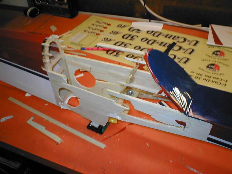

Posts: 219
From: Oregon,
OH
here are some pics of the ucd im repairing. this was a friend of mines plane. his rx went bad and hit pretty hard. he gave it to me because he was moving to florida for the winter and didnt want to take it, and repair it. the wing wasnt bad looking. just a broken rib and broken wingtips. have that repaired and covered already. im working now on piecing the fuse back together with the parts i have. im re-enforcing about every break there is. i will also be re- enforcing the lg mount with fiberglass cloth. ill keep the updates coming. jeff
#600
Joined: Aug 2003
Posts: 497
From: Grove City, OH
you're a good man easy2fly,
I'm glad to see that you are actually repairing the fuse yourself. I don't think as many people do that as I thought they would. I always figured that it was just balsa wood and if someone put it together in the first place then just about anything could be repaired. I have noticed a lot of guys just scrap the plane after that kind of damage. It's tempting with a new fuse only being about 50 bucks. But, good luck with the repair, I believe that after a repair like you're doing, it will be more robust.
I sheared 1/3 of the wing off of mine during an encounter with a tree on landing. I went ahead with the repair, but also decided to give the plane an entire new color scheme. I have about 70 bucks in covering and paint, plus, I haven't been able to fly it for the last four weeks (I cover SLOOOOW) so I probably would have been better served to purchase a new wing for 50 bucks from Tower. I'll post some pics soon.
