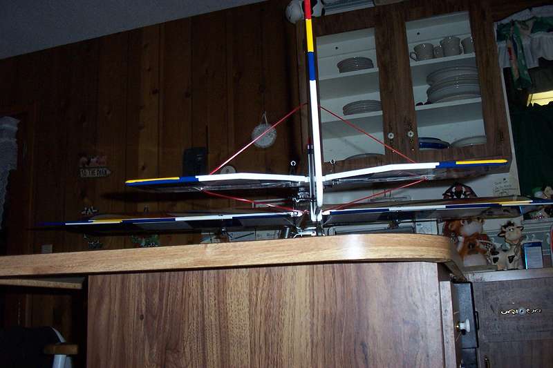

Still in the process of getting my UCD together, setup is going to be with an OS 91 Surpass 1 turning 15x4 prop.
What concerns me is the amount of tail stabs coming apart in flight, has anyone used flying wires on this, i was thinking of using a Sulivan flying kit to help strengthen up the rear end... any inputs
Cheers

if you look close at mine you might just make out the red weed trimmer line on the stab. I wasn't going to take a chance.

ORIGINAL: expresspilot
EXPRESSPILOT....
How did you secure your line???????
Im going to do the same..but im going to use kevlar line
Old 02-24-2004 | 03:43 PM
  #829
expresspilot's Avatar
Joined: Feb 2004
Posts: 40
From: avon park, FL,
Default RE: U-Can-Do 3d 46?
Drilled .080 holes to match the .080 line pushed it through then pullled it tight and hit the holes with thin CA. Works like a champ.

I added weight inside under the rudder servo to take me to 6 inches on my CG thanks for the feedback. Here are the pics of the tail brace wires. I would make sure to fiberglass the gear block as recommened in previous posts. I think the saito 91 with a cline regulator and a larger tank under the canopy on the CG is a kick *@# combo on this plane. Nothing taken from the 100 but the 91 gets the job done with guts on this plane and the engine isn't even broke in good and running very rich. I think the suggestion of a 15/4w apc was right on the spot it seems like the perfect prop for what I wanted. I'll let y'all no how the new CG works out this weekend.

Express Pilot I see on you pics of you plane you have guy wires on the stab and tail. Have you had trouble in the past with the tail section?
Chuck

Nope. But I don't won't any problems. Not much meat back there for all the stress that I put on it.

My stab broke about an inch and a half out from the fuse. This was on my second flight, plane destroyed. Thats why I was asking aout the guy wires. I had gap seals and the whole nine yards. It broke in level flight at half throttle with a .46fx and a 12X6 Zinger.
