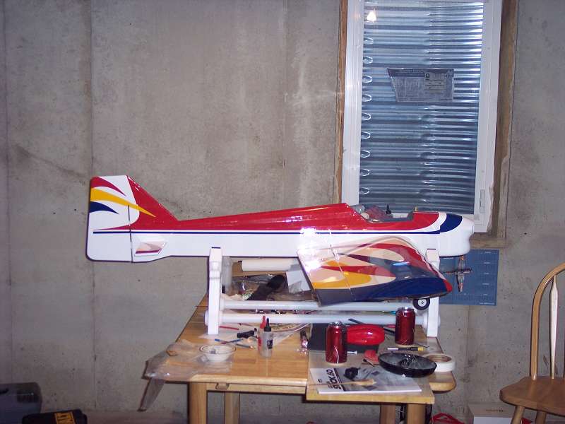

ok here's a pic of the beginning....this model was full of wrinkles ....tookme a long time to get em all out...this pic is just before I finish installing the hinges to elevator..a sullivan tailwheel will be installed tonight.

hockeyrules99, She looks to be coming around just great!!! Great Job!!
Just take you time and do all right the first time and she will treat you
well!!! Keep us updated...

Hockyrules99, Looks great. I bet you can't wait to get it into the air. Looks like from your picture you have an Ultra Stick 60. How do you like the stick? What engine are you putting in your UCD?

I maidened the ultra stick 60 on Sunday...did'nt fly it enough to get a great feel for it....need to rework the throttle linkage...anyway back to UCD...thanks for the comments..I'm taking my time with it..I will putting a Saito 82 on the nose of her..did get the control surfaces on the tail last night...ran out of time for the tail wheel[&o]. Where does the time go when you're working on these things huh?

In many ways the building is the best part. Dreaming about how good it's going to fly. Waying away the hours. This is a great hobby. Your plane is looking good. Makes me want to start building my 4th one. I better get on it. Afterall, only a month or two until the snow is gone and I can fly again. Anyways, great looking build. Take your time, do it right. You'll be glad you did. Make sure and double/triple check all servo screws, linkage, CA hinges, axles, etc. I've had several problems totally because I left something loose. Sometimes when you're building you say, "I'll get to that later" Later comes when your doing the repairs in the basement after crashing because you forgot to tighten the axle nuts.Thanks,

Hockeyrules99, One thing to think about is when you start flying it, I would leave the cowling off for the first several flights. It's easier to adjust and tune the engine if you do and also with my Saito 82 it shut off on take off on about the 4th flight. It was about 20 ft. up and nosed it and broke the landing gear block and snapped off the engine mount. It would have destroyed the cowl. The engines aren't all that reliable when new. Just a thought......

Very good points!! I always go over everything twice, like all the little screws and misc. before a maiden..after it lands (hopefully under full control) I'll pull the wing off and go over everything again!!!! I'm sure it sounds like overkill...but I put far too much time (and money) to risk a crash on something I could have prevented!! I figure I have a hard enough time keeping them in the air with my thumbs I really don't need an extra challenge of trying to fly with something loose or falling off!!lol

That's a great practice to get into and it WILL save you!! Don't forget
to tug on your flight surface, wheel collar's and condition of horns
and arms.. Can't beat a simple preflight check, It saved me a few
times on CA hinges and loose wheel collars.. My battery got me
once... If I can help it....Never again!! Have Fun!!!
