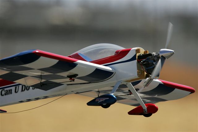

This is the second plane, I have adjusted the throws to the 50 to 60 degree range, my first one flies better, this one had a twisted wing straight from GP, their quality lacks and the customer service lady was a pain until I put my foot down. Included are somr airburne pics.
