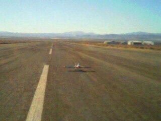

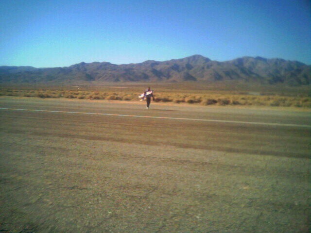

WoW Gary! Nice runway! [X(] It looks like one of the space shuttle runways....[X(] That's it! I'm moving to California....[8D]

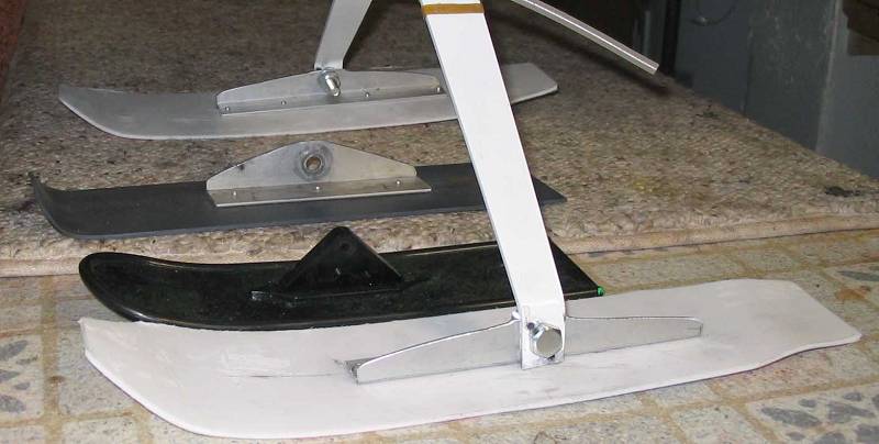

Okay, I promised some pix of skiis for planes. The pix include: 1) two 13" x 3" white skiis [on the UCD 60, heaviest plane I have], made from a plastic bucket side, then straightened and bent again using a butane torch; the pic includes a Dubro ski and another I made from some special PVC we got last year, gray; 2) skiis, cut from the blue TOP of a drywall goop bucket. This bird is light so didn't require much length or breadth to support the plane; 3) two of the PVC skiis, one not yet put on the front wheel of a tricycle Dart. I used it for the Big Stik, too.
The skiis are attached to the gear with a simple aluminum angle iron available at most hardware stores. The angle irons are secured with rivets. The rivet gun and rivets are reasonably cheap, too. Drill a hole through the aluminum and PVC to match the rivet diameter, install the rivet and squeeze. Easy--and MUCH cheaper than the Dubro equivalents.
Nice thing about the Dubros are the springs which keep the nose of the ski up in flight. WE use rubber bands--standard. You can see where I drilled holes to accept a small dia wire, then put the band through it, voila.
THIS year, though, I've attached skiis on the Twist and UCD 60 with toothed washers so they won't move at ALL. I'm thinking that will work fine. The alternative is always trying to get them to look right, symetrical angles, in flight. And you only need a very little "up" in the tip so the ski doesn't dig in and upsot the plane.
Deciding on the width and breadth is a function of the type of snow you fly on, obviously, but the samples in the picture serve me in all conditions of snow, though in DEEP new snow you tend to throw it around with the prop. Fun!

That runway looks like a road to me. You got it made right now. It is 20 degrees and snowy here in Ohio. Need to get me a winter job out there. Is there any work out there? UCD is hanging in garage looking really sad. Anybody heard from Barry?
Time to get the hanger stocked up for spring. Would like to get another UCD just in case. I 've flown 20 flights on lower rates and its time to put the bigger servo arms on and crank up the throws so I can do thse low inverted passes. My knife edges need more throw on rudder .
