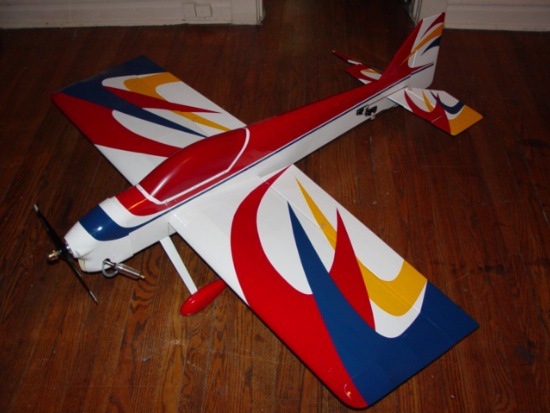

Mine ... painted and trimmed the canopy as per pic. Looks very nice.
Magnum 80 4 stroke for power. HITec BB high torque's across the board.
Breaking engine in with 13x6 Master Airscrew. Have 14x4 APC ready to put on after 10 flights.

Nice touch STLPilot, with the red canopy. What color red is that and is it sprayed or brushed on underneath?
It's flame red monokote paint. It's painted on both sides. Then hand cut white stick on monokote for trim. Then screwed down instead of using canopy glue, which I never use.
