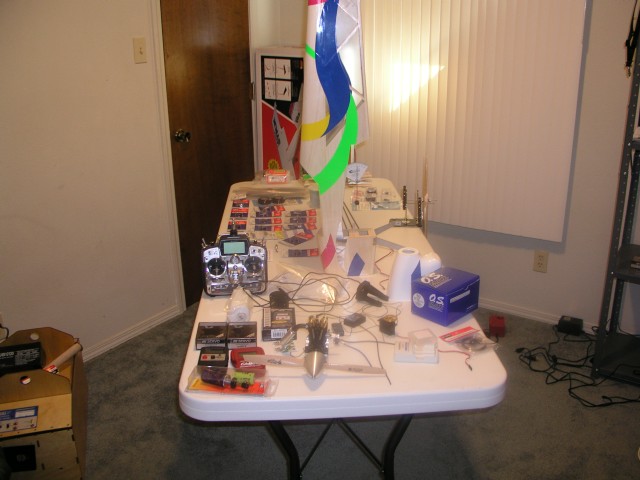

I will have to try to put it on again, it really wasn't much of anything other than the FLIP 3D that now I am debating on finishing because of the work needed to add dual elevator servos, now that the new UCD 46 has them this may go on the back burner...I just wanted to post the pic to show all of the extra goodies that were purchased, it may be over-kill with the
ball bearing links, carbon fiber rods, aluminum servo arms and all but my big worry now is the weight of using all of this on the UCD...I hope that I will not have to relocate the rudder servo on this one too but if I do at least I already have all the stuff...I am not buying another motor..It has to be either the OS 50 or Saito 72.....

Nothing but a big mess right now...but i have reason to organize since UCD 46 is on the way...anyone want to buy Flip, lol

Don't give up on the flip! Put that thing together with the elevator torque rod and fly. You'll wish you had finished it right away! I had the 60 size 'It can't do 3D' and the flip can fly circles around it!

I might consider taking the flip off your work table. Let me know what you'll take for it. Rodney

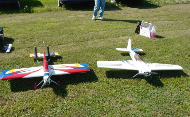

Birds of a feather ....
UCANDO 46 / Funtana

what a combo!!!!
