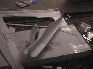

I have built a mini sukhoi and am going to do a build thread and flight video over the next week or 2. I Built this in about 2 hours, so It went fast! Il do a brief overview today and then tie up loose ends later. Il try to be as thourough as possible, IF YOU HAVE ANY QUESTIONS PLEASE ASK! Here we go...

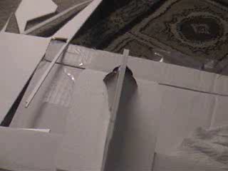

pict 1: Here are all the parts layed out.... The setup is going to be a Hacker A-20/34m falcon 3s1p 380's and a castle creations 10 amp speed control, 4 hs 55 servos and GWS RX (dont give me crap about having a 9Z on a foamy, ive already gotten the riot act...

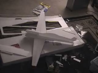

Pict 2: Here are are about to laminate the nose...this is very different from most foamys and increases motor strength emensely!

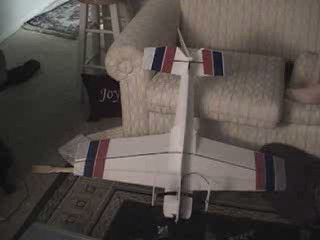

pict 3: Nose laminating. Lay out center part and embed provided carbon fiber into the precut grooves and glue. Then put laminates on, The laminates need to have one long laminate on one side and short laminate on the other. Long is for the top and short for the bottom side rail

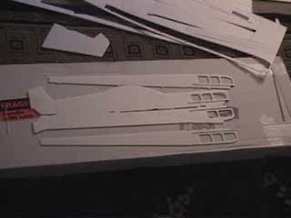

pict 4: laying down the laminates

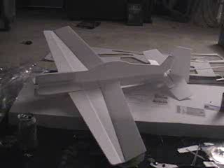

pict 5:Nose laminating almost finished, Be sure everything is straight, look twice glue once.

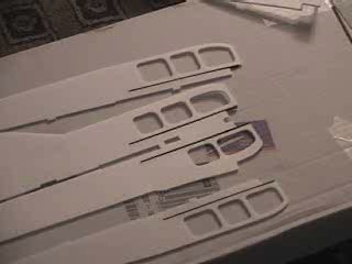

pict 6: After the side rails are laminated then insert into the interlocking grooves in the fuse. Glue the side rails into place and ensure that they are 90 degrees to the fuse!

not to contradict anyone but I would recomend the lightest setup possible!
I ended up using a new motor from www.2dogrc.com its a speed 300 motor.
CC 10 speed control
falcon batteries 3s1p 380's this will bring the plane in at around 8 oz with 28 oz of thrust and 5-6 minute flight times.
Best of luck and I would look into this setup. Best of luck.
