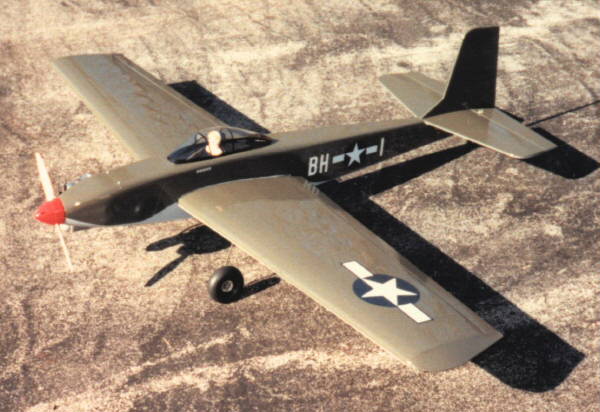

I am scratch building a small .15 size plane just because I have an engine sitting around. I like the look of the sig lil something extra and or the herr little extra (I think they are the same plane, both no longer available) however I though about making the wing with a wing tube more like the sig something extra 40 size plane. I looked at the building plans to the something extra and it looks like the wing has a straight leading edge and has a tapered trailing edge. The way the instruction read, it sounds like it has a constant wing depth (from top spar to bottom spar) for building ease. Perhaps I am wrong but the sheer web in the kit are 1.75 inches tall and the instruction only say to cut to width not hight so I am assuming that the spars are a constant 1.75 inches apart.
Questions:
1. Is this commonly done this way? 2. How will this affect aerodynamics (tip stalls, slow speed flying, ect.) to have a constant depth, tapered wing?
Questions:

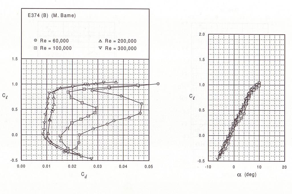

It can also go against you.
When a wing section has more percentage thickness, or more percentage camber (or both) then its critical Reynolds Number increases. By that I mean the Reynolds Number (Re)below which the section has a big jump in drag coefficient and sometimes an early stall.
Check out various sections in Selig's books of wind tunnel tests and you will see what I mean. He tests at a range of Re, and you will clearly see the effect of reducing Re.
I have tried to attach a scan of Selig's test of the Eppler 374 section, from which you can see that changing Re from 300k to 200k makes little difference, but consider what happens if the root section re is 200k and the tip is 100k or 60k. Buy Selig's books (Soartech Publications), well worth while.
It is often best on models to reduce the section's thickness and camber when Reynolds Number is reduced.
On a tapered wing, the tip is obviously operating at a lower Re than the root, so this idea of keeping the top to bottom measurement the same while reducing chord will work SOME of the time, but at other times is asking for trouble. You need to check the performance of the section at the reduced Re (and who among you bothers?) or you could have problems.

As I recall the Somthin' Extra has a constant chord and constant thickness wing with tapered full span ailerons. And the amount of taper isn't all that much. So really while techincally it's not a constant chord I suspect you'd really have to be fussy to find it truly behaving like a tapered wing. Which is very likely why it is so successful a design. The reason that the webbing isn't tapered in width is because the main portion of the wing is simply a constant chord and thickness.

If you build a .15 powered RC plane with a RTF weight of 28 ozs or less and 300-400 square inches of wing area the only concerns about the airfoil are about how fast you want the plane to fly.
Most old designs I've seen that made their way to publication have wings that are unnecessarily thick.
A 8-12% airfoil will produce carefree handling at all speeds if you hold the plane to the 28 oz RTF limit. You'll end up with a .15 powered plane that has excellent vertical, top speed and will land at walking speed.
A pair of 1/4"x 1/4" hard balsa spars in a 36 inch span wing that is 1" thick is all the strength a plane like this needs. I've tested .15 powered planes in this size range to the point of wing failure and 1/4" balsa spars are all you need.
1/8" balsa sheet for the fuselage's box with 1/32" or 1/64" ply doublers that extend back to the wing saddle is all that is needed, with a 1/8" ply firewall.
Keeping the weight of the model down will make all your aerodynamic concerns about the wing pretty "moot". Once you see your plane in action, it will become obvious.

Sorry guys, I did that post above off the top of my head. In fact, a CL stunter on 60' lines would have about 49' of straight line to fly from the 45* location to the 5' AGL location. (they follow that path when doing wingovers and the vertical sides of square loops) So from the top of a square loop is actually a trip of about 49' to the bottom of that same square loop.
If the stunter only turned 20' radius turns, then it would be able to fly about 9' sides for it's square loops. Unfortunately, there wouldn't be room for any straight line along the top. There is a fair amount less than 49' of distance up there.
If you've ever seen a decent pattern flown, you know it's quite possible for even average CL stunt flyers to do square looking maneuvers.

Thanks for all the responses. What I am trying to make is a miniture Sig Somethin Extra. PTERODACTYL, the wing tube is just a aluminum tube that goes through the center of the fuse and holds the two wing halves perpendicular to the plane ( it allows the wing to be center mounted and be able to be removed, it will also give me more roome inside of the center of the fuse to put my electronics) , the tube only extends into the first two ribs of the wing. BMatthews, I have been looking at a lot of the pictures on the internet and have seen a few from the top view and although the alerons are tapered, the wing is also slightly tapered. I was thinking of thinning down the wing some and building up the tail surfaces with sticks instead of solid material to make it lighter.
