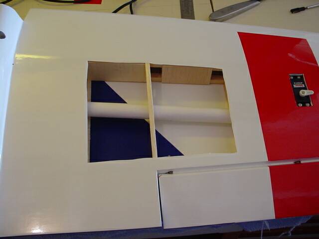

I finally got the guts to cut a hole in my still-fresh covering job to see what opportunities I have. For reference, I've attached a pic...the servo tube is somewhat in the way and will limit my flap location as far as servo mounting opportunties go, but I think it's still do-able...

Another posibility is to install the flap flush with the inboard section of the wing and allow it to hinge down to give inboard lift. I don't know what the effect will be while flying, but you should get a lot of drag and inboard lift when deployed.
Posts: 332
From: Greenville,
SC
If I'm understanding your description, that's actually what I'm calling split flaps even though they aren't at the trailing edge of the wing. I'm wrestling with how to hinge it, but once I get that figured out it should be smooth sailing...

OK, I understand. If you put that at the leading edge, you are going to have a spoiler effect and loose all laminar flow on the bottom surface. You will have to slot the front of the flap to make sure that you maintain some laminar flow!
I know you already know this. One question that I do have, how are you going to maintain strength at the hinge line of the flap. If you are flying at any reasonable speed, you are going to have problems with the servo or flap. You will be moving a lot of air!

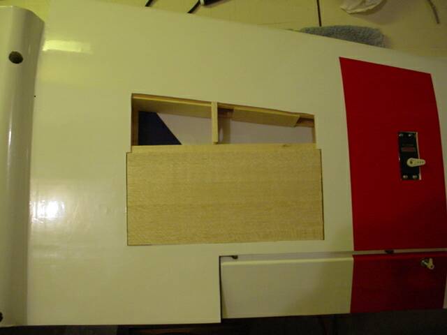

The hinge line will be around the 60% point of the chord...the picture will illustrate what I'm getting at although the structure is far from finished. The uncovered balsa sheet will be the flap surface and will pivot at the top edge some predetermined angle.
That was my concern with Monokote hinging...I'm working on a way to either put pinned hinges or CA hinges. CA is probably the easiest, although I haven't use a CA hinge in years (don't generally like 'em). I'm not sure I follow on slotting the flap...split flaps create lift and a ton of drag and aren't supposed to be slotted.
I'm planning on using fairly strong mini servos (thinking Hitec HS-225BB...67in-oz of torque) and I am using a 6V power source. I'm going to set up the linkage so the arm and link are colinear when the flaps are down...if the servo has the grunt to get the flap in position, then it can hold it with very little effort.

Just to be clear, it's on the bottom of the wing, so the effect the split flap has on the wing is to create an upward reaction force from the airstream being deflected downward by the flap. It's only about 1/4 the wing panel and near the fuse, so it shouldn't adversely affect aileron response (I hope).
I guess if I were to go ahead an do it, the worst that could happen is it doesn't work and I've added a few ounces to the wing. I could even yank the servos and glue the flaps up permanently to remove most of the added weight. See how I'm rationalizing this?
