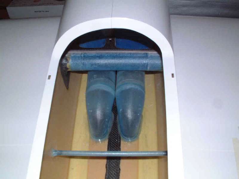

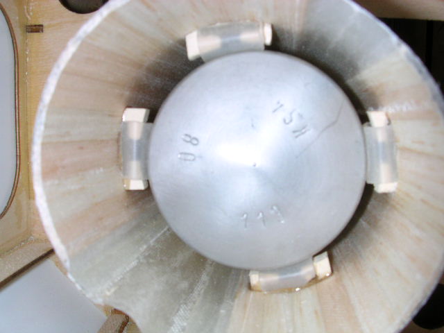

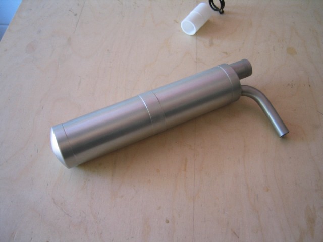

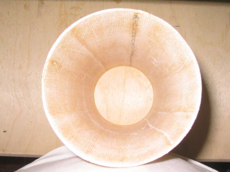

Hi, guys I have some question about the exit hole in a canister's tunnel.
I'm building the H9 Edge 540 with the ZDZ 80, have a KS 89 canister muffler to be placed inside the fuse.
I have made a tunnel for it with a diameter of 85 mm, the canister has a diameter of 65 mm, look at the picture!
My problem is that I have also to make a curve for the air to exit on the bottom of the fuselage. No problem about the construction, but I wish to have some advice about the area and shape.
Do you think is better to gain higher pressure or higher speed just before the exit out of the fuselage ??
Because I have to shape the duct with an exit area bigger or smaller to obtain that.
I have seen many picture of german plane with a tunnel and exit curve like the one below, I understand that this is made by a german company, but I whant to do it myself because I think is not so difficult and I already have the duct now!
What can you tell me about that ?
Also a constant diameter till the exit can be considered, and is actually what I'm planning to do!
Moreover I don't like to live the hole at the exit as it is, but instead I wish to close the hole and make 10 opening divided in 2 row at 45 deg, just like the second picture but with a different number and dimension of the aperture.
Now the number and area of the 10 opening equalize the area of the duct (so no change in speed or pressure at the very and of the exit), but to obtain a sufficent area for cutting this opening, I have had to enlarge the duct at the end (gradually till the duct encounter the fuselage) so In this portion I have a pressure increase, but the air can't go anywere because the bottom of the fuselage let only escape the air allowed by the aperture size (that as said before is equal to the area of the duct).
Does it make any sense ?
I hope to have been clear enough, sorry for my english !!
Best Regards
Gianluca
Best Regards
Gianluca
The exit hole size and shape is best if it is made to create low pressure . louvers would work better than the flush cutouts you show.
The bottom of the plane is NOT a low pressure area so the exit holes should have some sort of angled edge/plate at front of the hole - to create the low pressure.
Air is not being blown in from the front!!!
It flows only when a strong low pressure area is at end of tunnel.
The air speed thru the tunnel will be constant -if the effective space remains constant.
You definately do not want the exit hole area to increase, as that will lower the fluid velocity & raise the pressure. There will be some fluidic expansion due to heat rejection from the muffler, so either a constant area, or slightly convergent outlet will be OK.
Don't do the exit louvers -- this will act as a diffuse matrix & create a significant exit obstruction.

Joined: Apr 2003
Posts: 106
From: Ariccia, ITALY
Dick,
regarding the support for the canister, I'm thinking to use only one support position at almost the center of the canister.
Where the cylinder is more thick, as you can see in the picture.
It seems to be the balancing point of the canister.
I will use 4 point to support the canister in that position, just like another guy have done.
What to you think ??
Do I'll need 2 supporting position, initial and end of the canister, or one is ok ??
Regards
Gianluca
