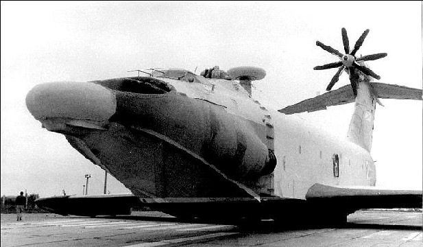

With plates extending below the wing, the increase in lift at ground-effect level would lower the stall speed at flare-out, which is what I observed with the adjustable plates on my "stick" back in the 1980's.
Other than that, I wouldn't expect any change in the stall characteristics, since that is something that occurs on the top side of the wing.
If this image isn't too large to attach, check the tipplets on this gargantuan Russian surface-effect mobile missile launcher. Maximum altitude: 10 meters. Speed? Fast. See, we're not the only ones who build fantastic weapons systems that are never deployed.

Yo Ralph,
I once saw a documentary about the russian "Ekranoplans" of which you posted a picture above. That thing was indeed very fast. They did have a lot of stability problems with it however. When it came off the water the pressure point shifted so that the vehicle tended to pitch up severely. It was basically packed with electronic equipment just to keep it going.
It only used 2 engines during flight...the other 6 (!) were needed just to get it off the water!
It was conceived to patrol the Black Sea during the cold war. It was a formidable weapon.
When american intelligence got hold of some high altitude pictures of it, they saw an enormous hull with tiny stubs for wings. Initially they thought the soviets were building an enormous airplane, unmatched by anything else in the world, and they were quite worried and puzzled about it...
I know, I know...this post is completely off topic. I just got carried away. Just love the sight of that thing...

Yo Ralph,
I once saw a documentary about the russian "Ekranoplans" of which you posted a picture above. That thing was indeed very fast. They did have a lot of stability problems with it however. When it came off the water the pressure point shifted so that the vehicle tended to pitch up severely...
Ben; Now here's a lifting horizontal stabilizer for you, big time.
Surprisingly enough my memory is correct. I saw the documentary about the ekranoplan when I was a young teenager, and the stuff I remember about it still seems to be correct (...wow...)
Look here if you want to know what the word means: ekranoplans
I don't know for sure if that definition is correct, but I think so.
If you are interested, do a google search on "ekranoplans", there seems to be a lot of information available.
Take a look at this baby:
