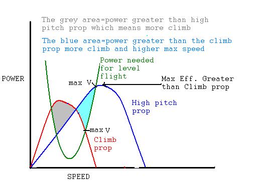

Not to throw a rock in the gears, but I question the idea that this will be the best selection. In general a larger diameter prop has the potential to operate more efficiently but in most cases the drag of the plane will keep you from reaching the speed necessary for the prop to reach this efficiency level. You have also said you do not fly for speed high pitch props are for speed. A large diameter prop with a lower pitch will generate more thrust at lower speeds and from what you are saying about the way you fly this plane the prop you are currently using or maybe even a prop with less pitch might be the way to go. You might even look at slightly smaller diameter prop with less pitch which might increase the RPM some, you may see a substantial increase in thrust at low speed which could help in getting airborne and recovering from trouble. If you are flying for endurance efficiency might come in to play if your flying for performance you might look at some other options.

From what I have researched, a prop has two different speeds where the propulsion efficiency is zero. The first and obvious one is zero speed. (hover and ground run up), the second and much less obvious one is the plane's speed is high enough for the prop to have zero slip. In that situation, the prop blade's airfoils have zero angle of attack to the airstream and so are making zero lift. At a zero lift angle of attack, an airfoil's lift to drag ratio is zero.
Maximum efficiency tends to occur when the advance ratio is around 80% of the pitch speed. (20% slip) At lower slips, the efficiency actually drops off because the skin friction and form drag of the blades still requires power to overcome.
Yes, often the best performance does not come with the most efficient prop but with a tradeoff between prop efficiency and the ability of the engine to make power. With electrics, the efficiency of the system is the prop efficiency X the motor's efficiency X the gear reduction efficiency. Don't obsess on one and overlook the other two.

Old 05-31-2007 | 10:54 PM
Joined: Sep 2003
Posts: 129
From: Holts Summit, MO
Default RE: effect of prop pitch on efficiency
This might help.
