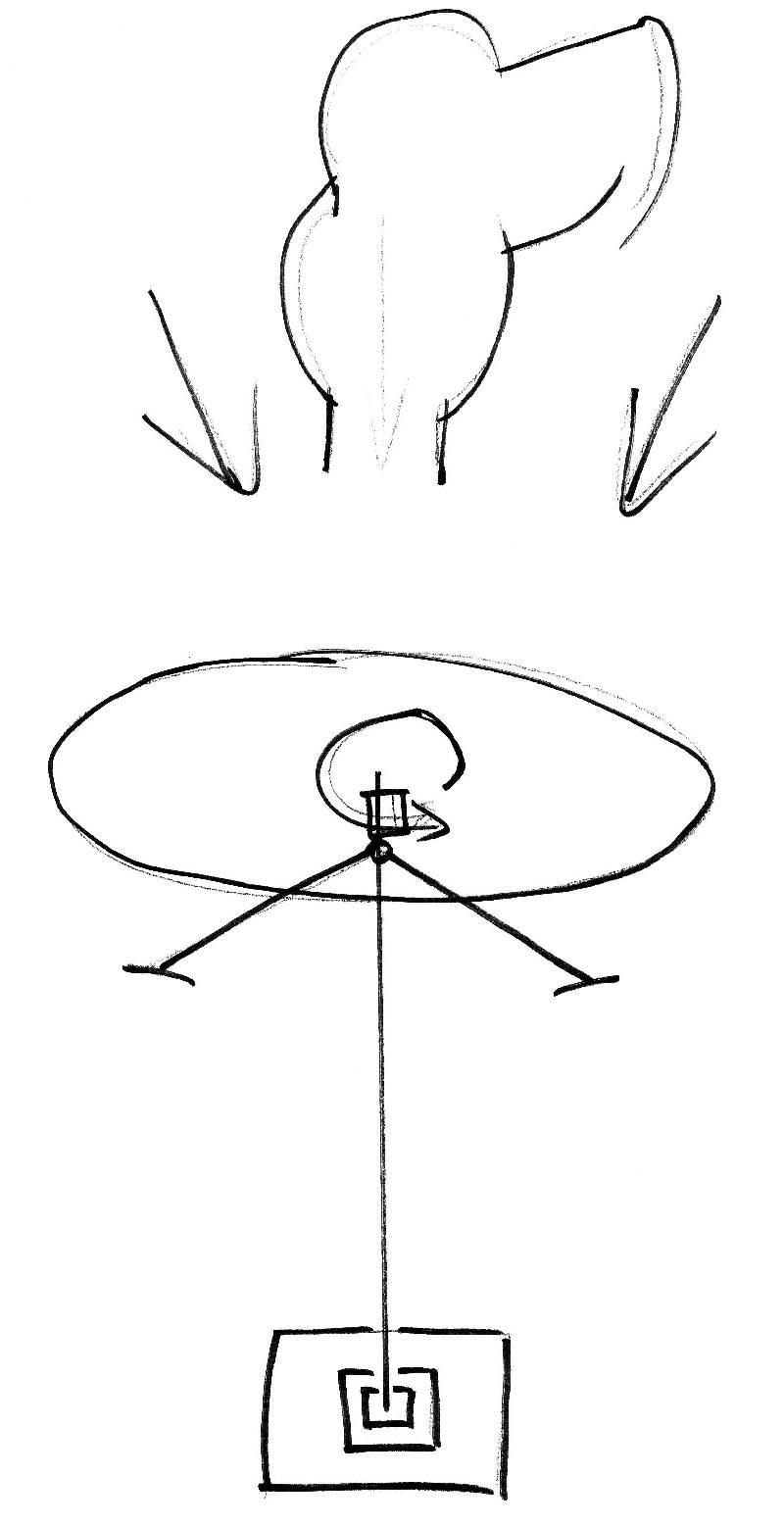

OK, I've made a (poorly drawn) illustration of why I disaggree. This illustrates two rotor/propellor discs.
The disc to the right illustrates a helicopter rotor in hover with a constant pitch (AOA) of +6 deg, and the air hitting the rotor at 90 degrees. A change in pitch is applied through the cyclic. This input adds 5 deg of pitch at 12 o'clock and reduces 5 deg of pitch at 6 o'clock. If gyroscopic precession did not occur, the disc would start tilting towards us, but because of GP, the applied force takes effect 90 deg later, and actually tilts the disc to the left.
The disc to the left is a propellor, with 6 deg of pitch (AOA) at the tips. If the oncoming air direction is changed is illustrated, would it not have the same effect on the AOA that the tips meets the air, as the rotor disc to the right. The books say that this causes the disc to tilt away from us, but if GP is applied, just like on the other disc, the disc on the left would tilt to the right, which would mean applying a pitch up force on the airplane.
I am sorry if I seem/am thick headed, but I really don't see a difference in these two scenarios.

In a helicopter, with its large diameter rotor at a low rpm, precessive forces do play a large part in its operation. A co9nventional propellor with its smaller diameter, even though the rpm (in full scale) is two to three times the rotor speed, precession plays a much smaller role than the AOA of the air coming into the prop disc.
Bill.
Bill.

I understand your argument, I just don't understand why a force isn't a force, whether it acts on a heli rotor disc or a prop rotor disc. I will try to set up an experiment at home as illustrated on the attached sketch. I will mount an electric motor on a long dowel, supported at the top so it can move tilt freely in all directions, like a pendulum. The end of the dowel will be suspended over a reference point. When the motor and prop is turning, there should be no torque forces making the dowel move, since it's kept from spinning. If I take an air blower and blow air from above the rotor disk at an angle, or I could use a large tube around the prop disc and tilt it, I can simmulate the conditions described with real planes (changing the angle the disc meets the air. If I am correct, the disc should want to tilt away from the angle of the incoming air, actually increasing the angle between the disc and the air. If I'm wrong, the disc should want to tilt to the side, perpendicular to the change of angle of the incoming air.
I know this is just a small experiment, but will it not give an indication af the effect of P-Factor.

Sounds like a good experiment. Try to have the incoming air at a high velocity to get as close to the real world as you can.
Let us know the results.
