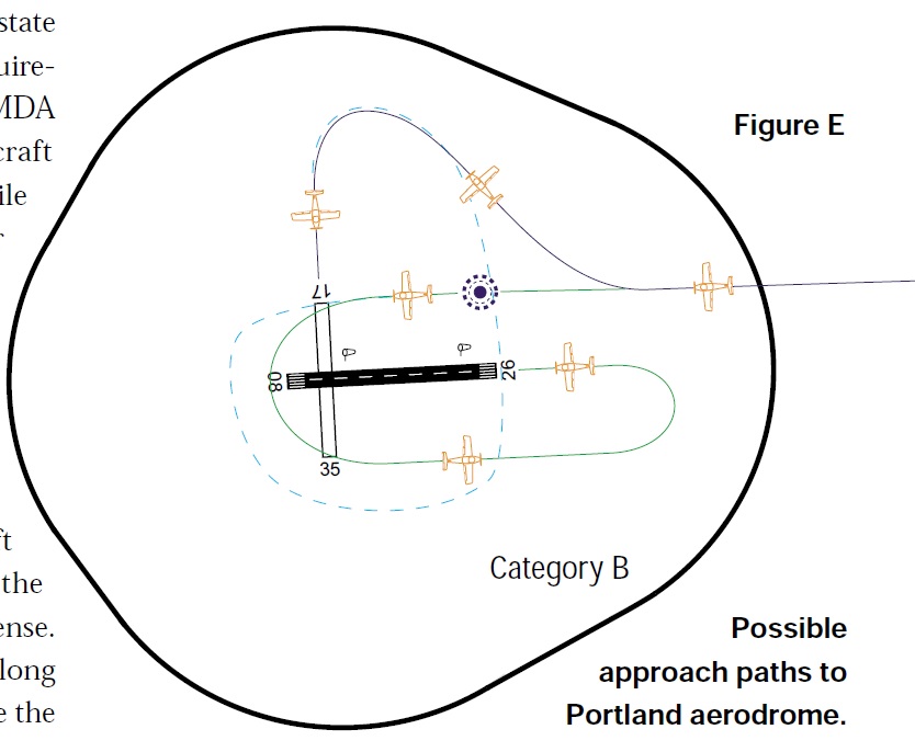

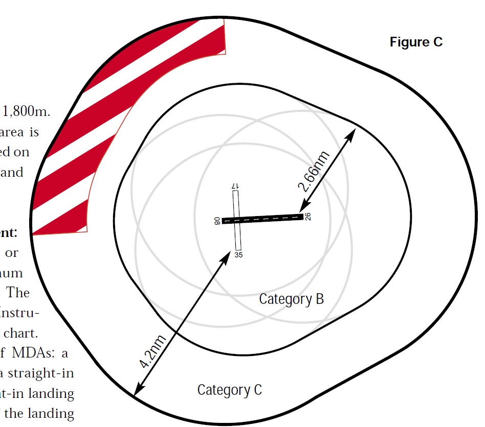

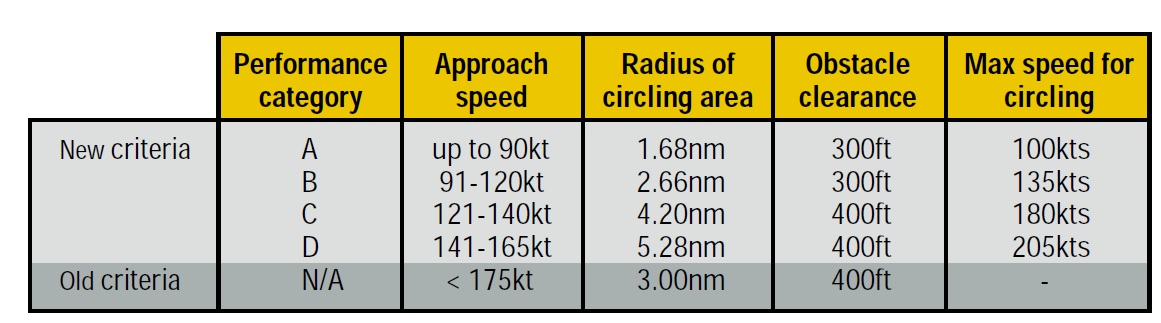

The one thing that gets overlooked in these discussions are the IFR circling areas around airports.
I agree with your numbers for an ILS approach or a visual approach on the PAPI - 3 degrees (IE 300 feet per nautical mile distance from the runway)
But airports can have a variety of instrument approaches and some of these allow for visual circling - The size of the circling area is based on aircraft performance (landing speeds) in 5 categories.
Look at Category E in the following diagram and see how the 4.5 nautical miles (about 5.2 miles) is calculated.
An aircraft circling in this area after an instrument approach could be at 400 feet AGL at 5 miles from the airport.
In other countries these circling areas can be even larger - Eg - Australia - Category D is 5.28 Nautical miles (9.8 kilometres) which means an aircraft can legally be flying at 400 feet nearly 10 kilometres from the runway.
How many drone pilots know that?

Good point; I'd ask "How many RC pilots know that?" There's a fair number of these "drone" reports that are not NOT quads. Yet another reason why a cap on RC Ops at 400' AGL makes abundant sense.
In my mind, that will be the next shoe to drop if there continues to be conflicts. FAA will turn 91-57 from voluntary compliance to mandatory compliance.

Help me know Every circling after an approach that I can find in my Approach plates seems to have a a max of 1-1/2 miles and Non as low a 400' AGL most of these are to get to a runway that does not have a working instrument approach to the active runway because of wind ect.
Also there is an APE that made for androiad and IPhones that showsall the airports and their 5 mile radius and their extensions for Instrument approaches and I thought all the location of the Registered AMA fields here on a forum that showed all the places R/C flight would not be permitted above 400'.
There has never been any kind of problem (if only negligible) since so many people not familiar with R/C TOYs started flying because of Fomies and now Stabilized flight systems with GPS and route programing. Again it a matter of Educationg the Ignorant. Now the stupid are Unfix-able, I agree but they are Incarceration-able.
