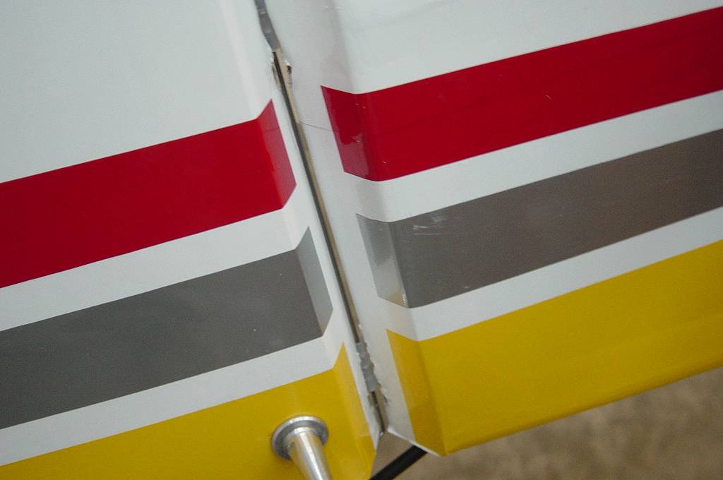

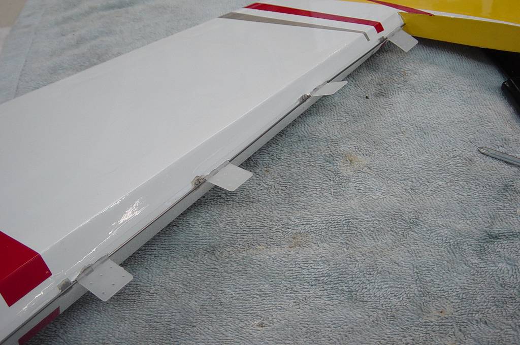

I was able to put my PAU 100cc Extra in the back of my pick up. It's an 05 GMC Sierra short bed. I didn't have the elevators, rudder or spinner on it at the time. I think it will fit with the spinner on. I made my rudder removable just for that reason. Won't let me post pictures right now but will post pictures of the rudder mod when I can.

Here are the pictures for the rudder mod.
I used the large Dubro hinges and I think .049 spring steel rod.

cool idea!!! i am thinking of getting a 100cc. plane but i gotta be able to haul it around!!

When glueing in the hinges you have to have the rod in all the hinges to keep from binding I used vaseline to keep the hinges from getting any glue on it. Used Gorilla glue and l taped the rudder in overnight with masking tape to keep the hinges from pushing out. The rod comes out and goes back in without binding or ketching.
