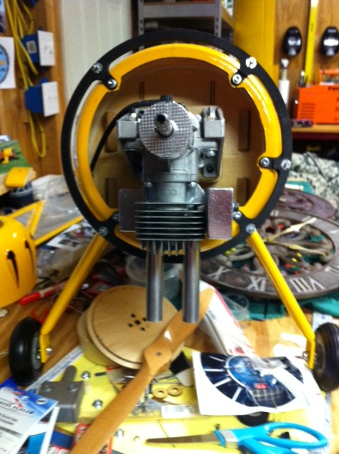

Hellcat, That is a beautiful site!!!! I am so glad to hear you say the DLE 20 has plenty of power for this plane. I just got my muffler that Jtech made for the DLE 20 that resembles the AeroWorks Cessna 195 DLE 30 muffler. I will need to cut the pipes off some and otherwise it fits just as I want. As you can see, I have used a Hangar 9 engine mount as I really like how they work. I should be ready for a maiden a week from Sunday. Thanks for posting all the pictures!!!
ID:	1594412   Click image for larger version
ID:	1594413   Click image for larger version

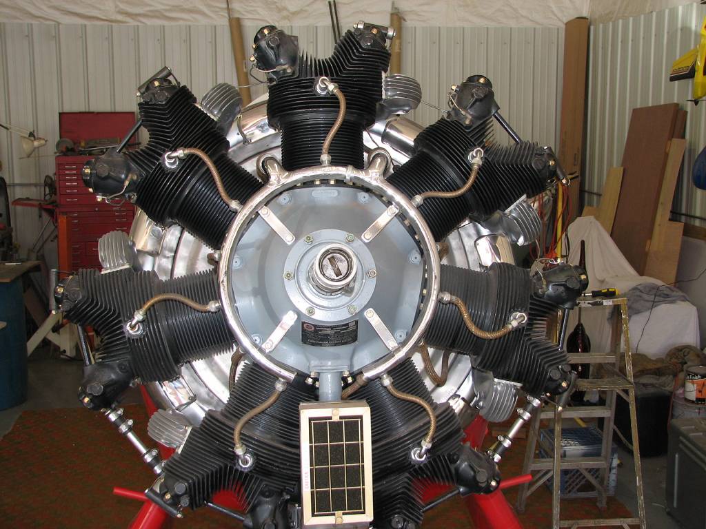

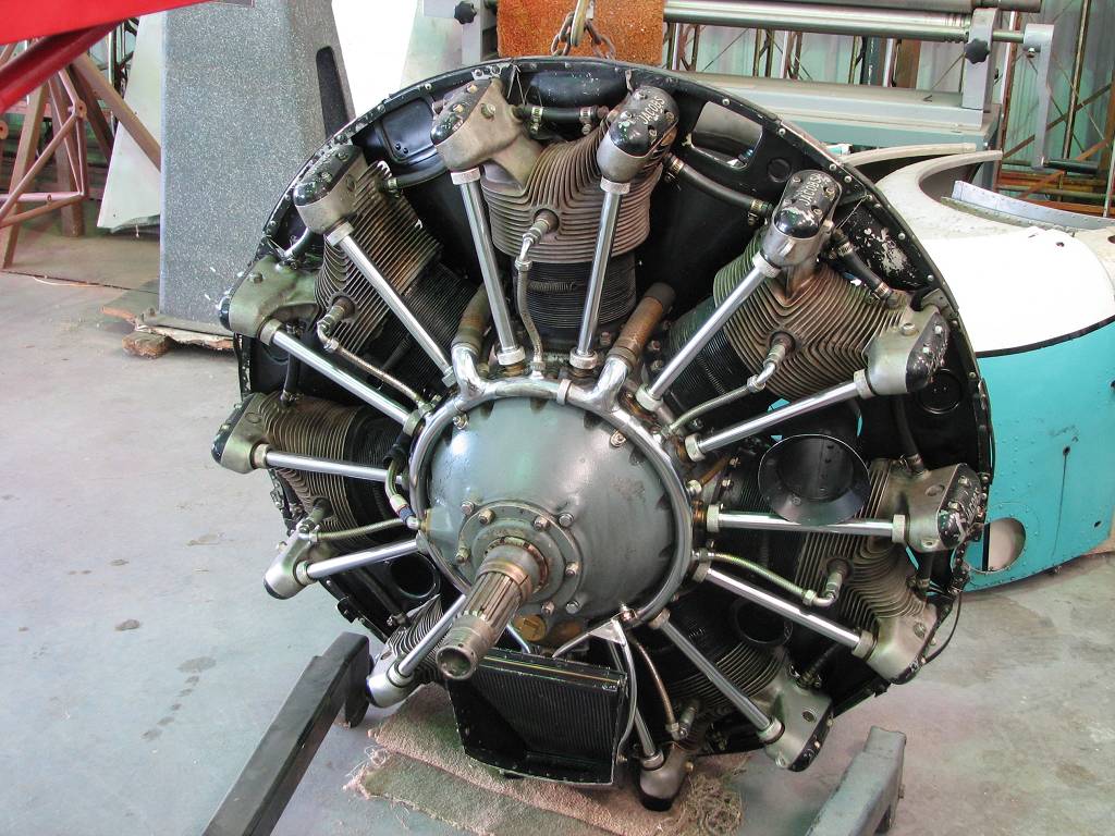

lablover,
Dont forget the # 1 cylinder on radials is straight up at 12 oclock when installed.
P1 - is of NC 14081, a 1997 Waco Classic Aircraft YMF, ser # FS-009 with a Jacobs engine.
P2 - is of Nc 12428, a 1940 Waco QCF, ser # 3569, being restored, with a Continental engine.
ID:	1594596   Click image for larger version

ORIGINAL: skylarkmk1
lablover,
Great pics, I see I have more work to do. Any ideas what to use for that ring on the front?

lablover
It is the ignition loom that keeps the spark wires together as they come from the magnetos. And it protects them from engine heat as they pass between the cylinders. Some soft aluminum tubing from K & S about 1/8" – 3/16" OD polished up or painted with chrome paint. Just pull (stretch) it as you form it around an appropriate diameter object. You can simulate the welds with epoxy. Note the wire exit from the ring at the bottom of each cylinder of both engines.
P1 – Jacobs Engine
P2 – Continental Engine
ID:	1594738   Click image for larger version

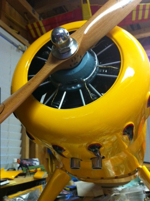

I have spent way to much time with this fake engine but I think I will let it be as it is.. Someone will probably look at it from 10 foot away and not notice the little things anyway. I now have my muffler so can get the thing assembled and ready for a real flight. ( WACO STYLE!!!)
ID:	1594834   Click image for larger version
ID:	1594835   Click image for larger version
ID:	1594836   Click image for larger version

Looks really nice. Do you think you have enough of an opening for cooling?

I think there's enough airflow room. I may drill some holes in the dummy cylinders on bottom 2. I'll figure it out so it won't overheat....
MM & Skillet,,,,let us know on the flying & take some pictures!!!!
Thanks for the comments on the dummy..
