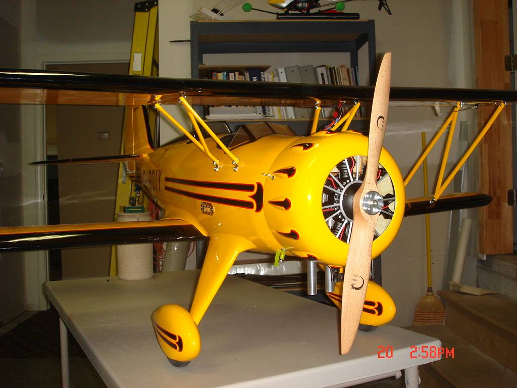

OK it's ready just waiting for the weather to clear enough to do a maiden.
First picture is of the switch location. the second picture is of the way I
had to run a wire to connect to the choke on my side carb DLE 30 not pretty but it works.
Now I put my Robart incident meter on the wings and elevator and I must admit I'm concerned because while I'm at 0 on the main upper wing
I'm negative on the lower wing and 4 degrees positive on the bottom wing??????
I balance perfectly with the 5.25"

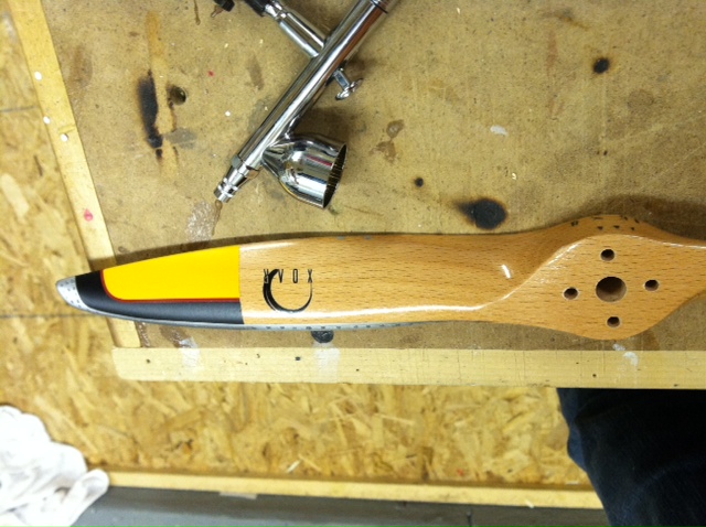

Here is my finished prop...Just like the real one....Almost

ORIGINAL: lablover
Nice looking prop, but you should drill your next one with the bolt holes rotated 45 degrees so the bolt holes are not lined up with the center hold. Its just the way I was taught.

The place I ordered it from drilled it. I can't visualize what you mean

Default RE: GP Waco?
He means that the bolt holes are two per blade side. Imagine looking the 5 on a dice and put the blades on the side. That is what you would see if you looked at your prop. It is suppose to put your prop at the2 or 3 oclock position for safe hand starts. I have done them all kinds of ways. If you have your engines tuned properly you don't have problems with the starting.
