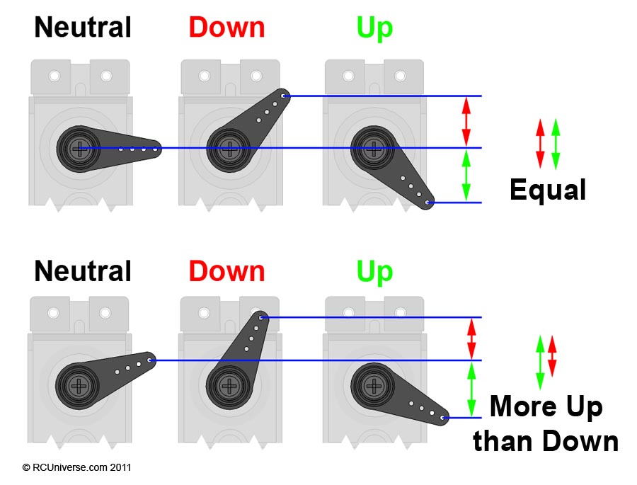

You can also do it mechanically by rotating the servo arm.

That is a good Idea about the servo arms MinnFlyer.

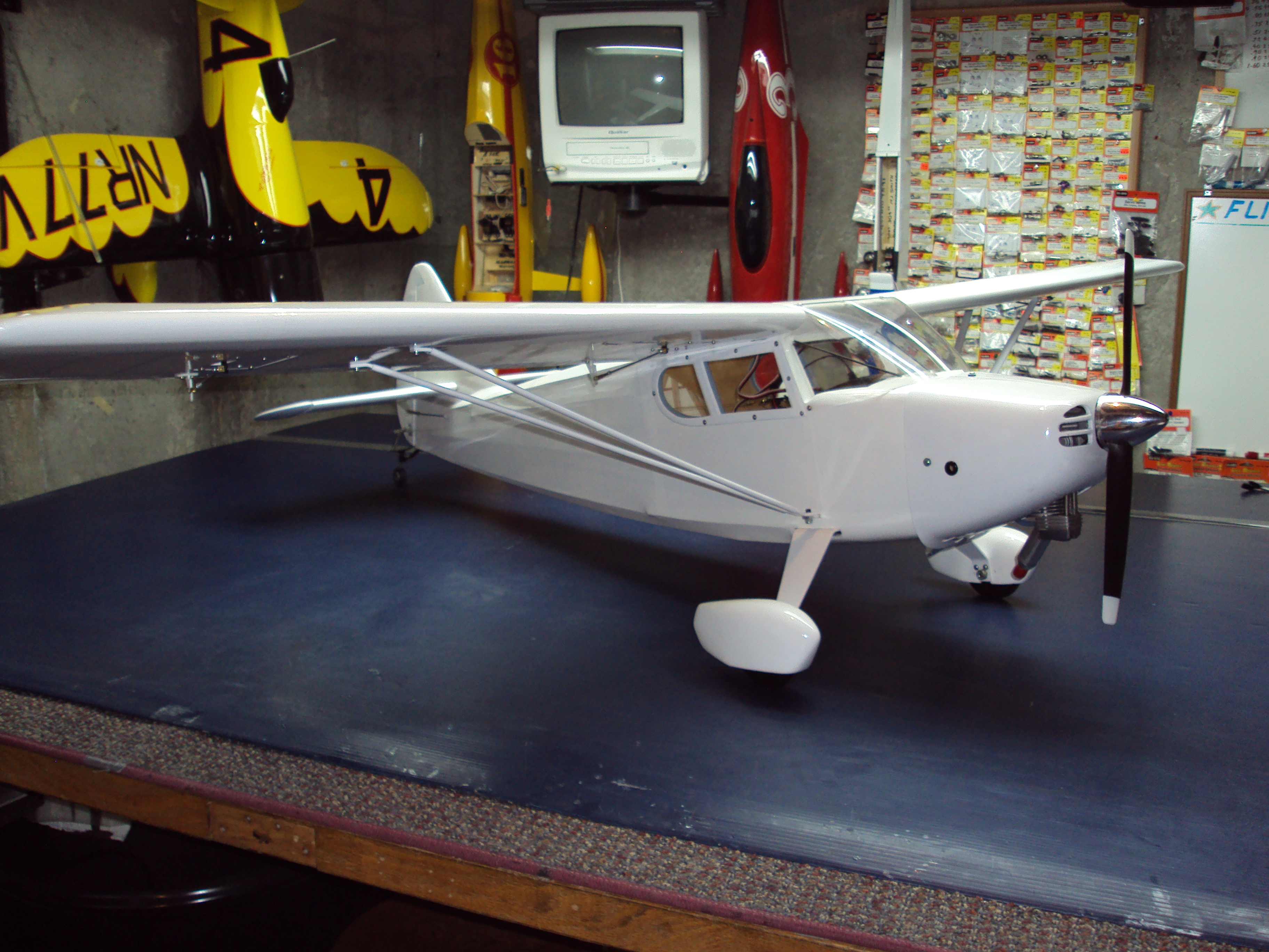

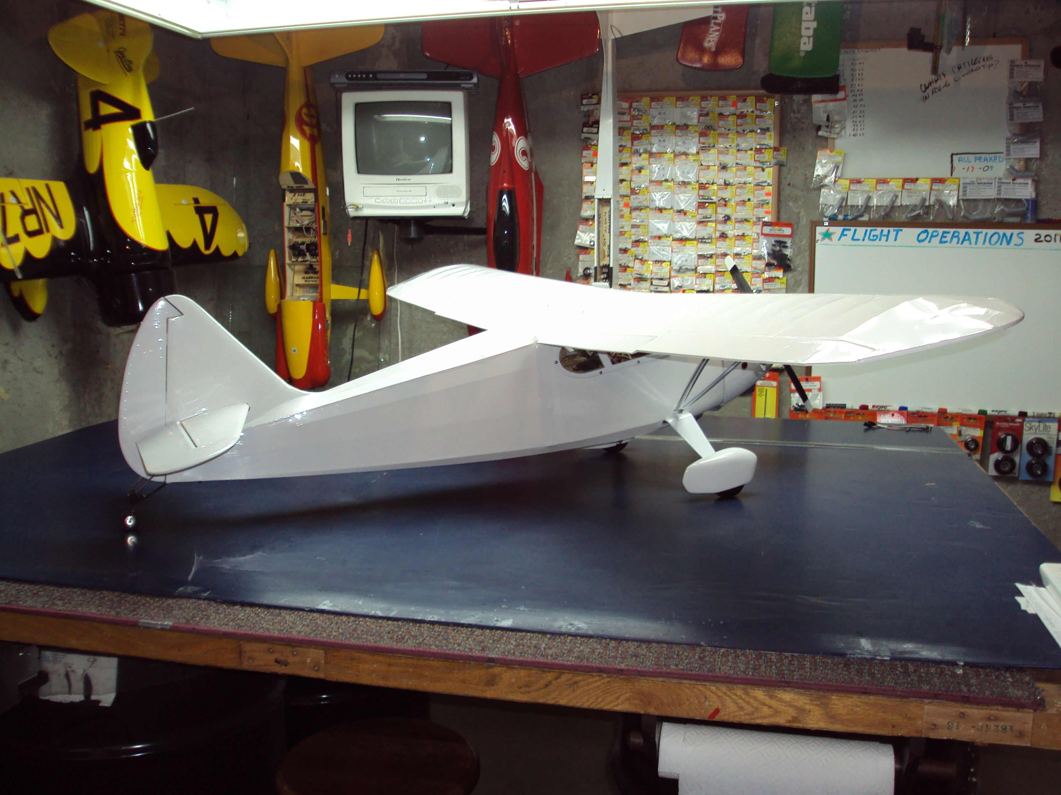

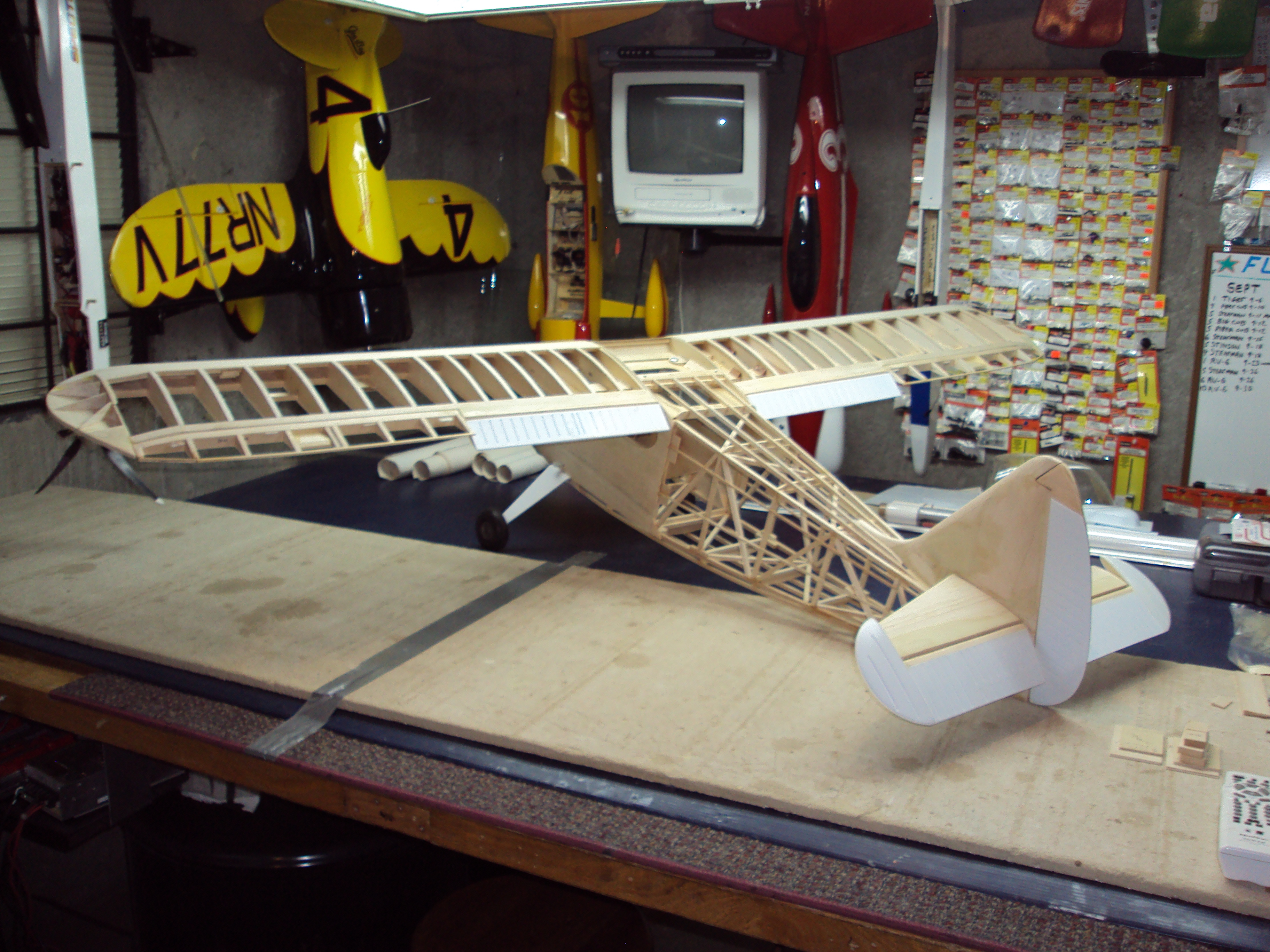

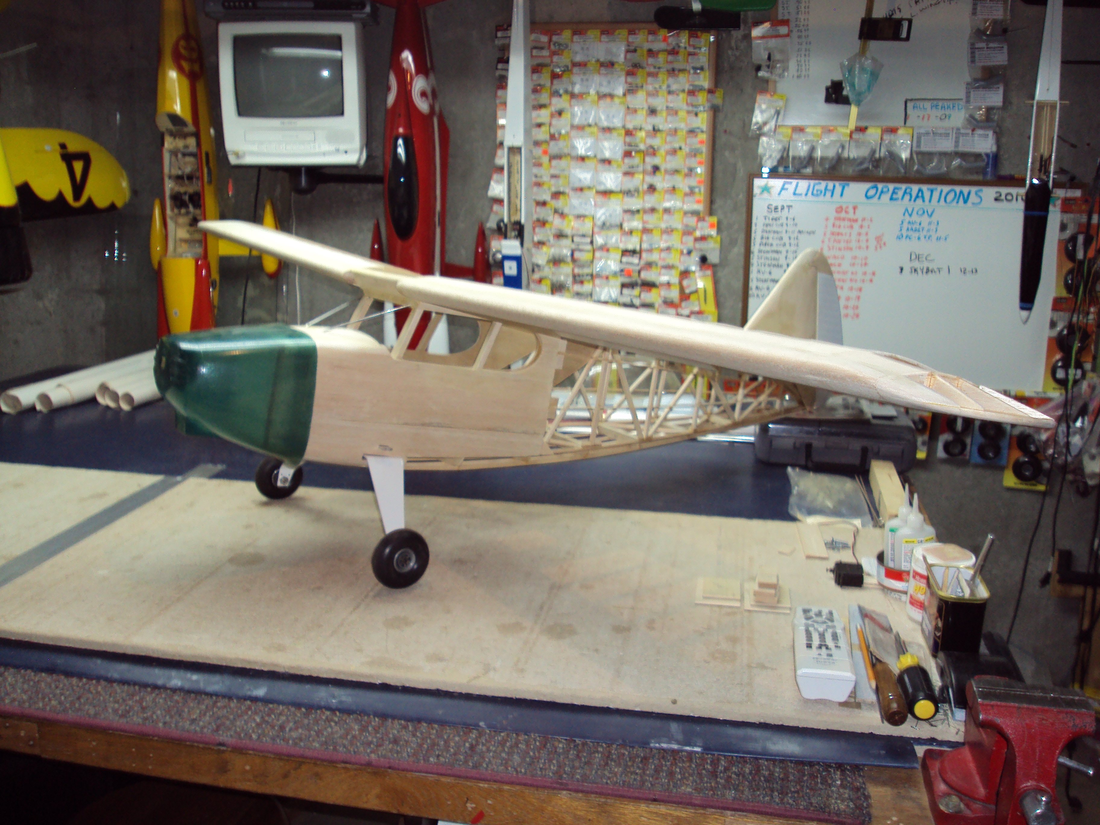

This winter project is just about done. Now I'm just waiting for the WACO. MM

That workshop is WAY too clean!

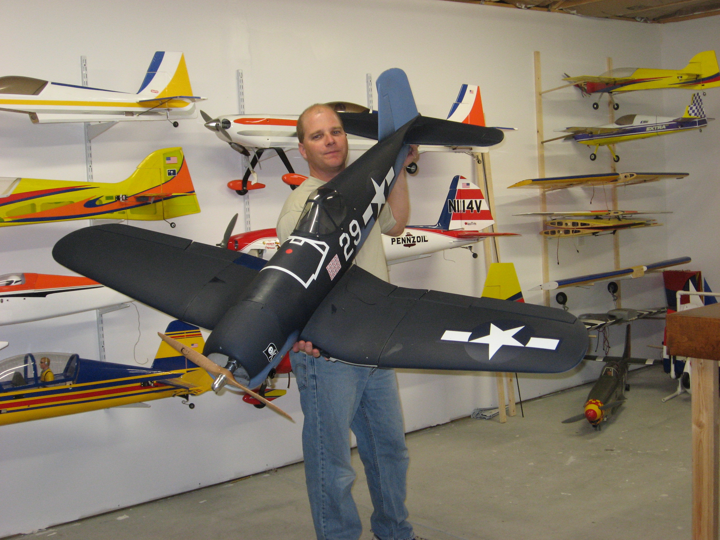

Well I am a Tsgt in an Egress shop and at work I have to keep everything clean and organized but at home I can "rebel" a bit! LOL I am just waiting on the Waco to come out so I can get started. Have all the pieces now just require the plane!
Would like some input though, I am going the dle30 route and that engine will turn a nice size prop. What pitch do you guys think would be good for scale speed on the plane? Here is a pic of my last project.

Stickbuilder, Yes I don't want it to keep up with my corsair or Mustang! Both of those have 10pitchs. I want scale flight! As for the 30 being to much well the weight is almost 14 pounds and it being a Biplane it will have a lot of drag. I could use a G-26 but I have a dle30 here already.

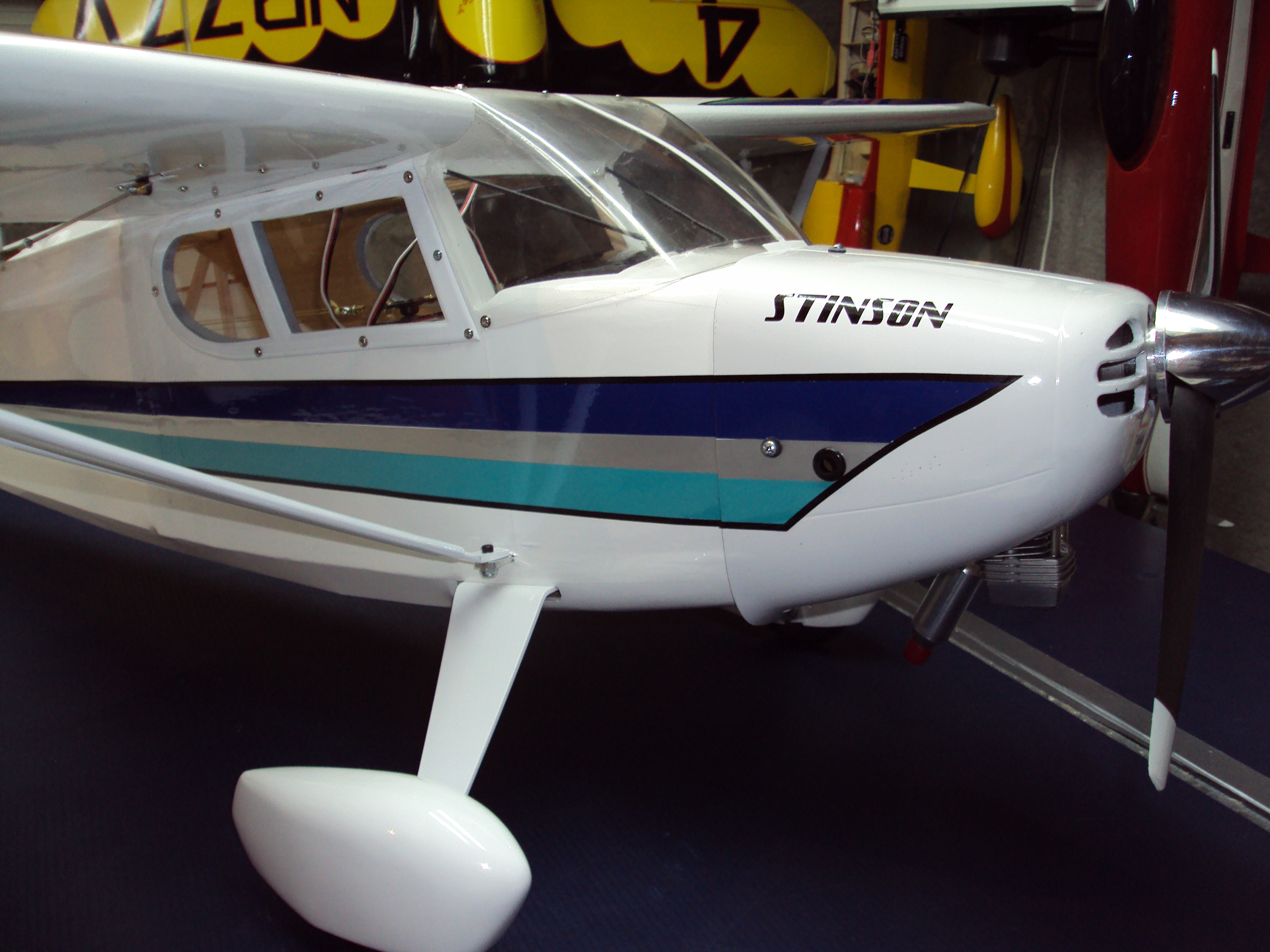

Yo BountyHunter51, Here's a pic of that Stinson emblem. Maybe that will give a better perspective. Overall, not too shabby of a winter project huh ? Seeya, MM
