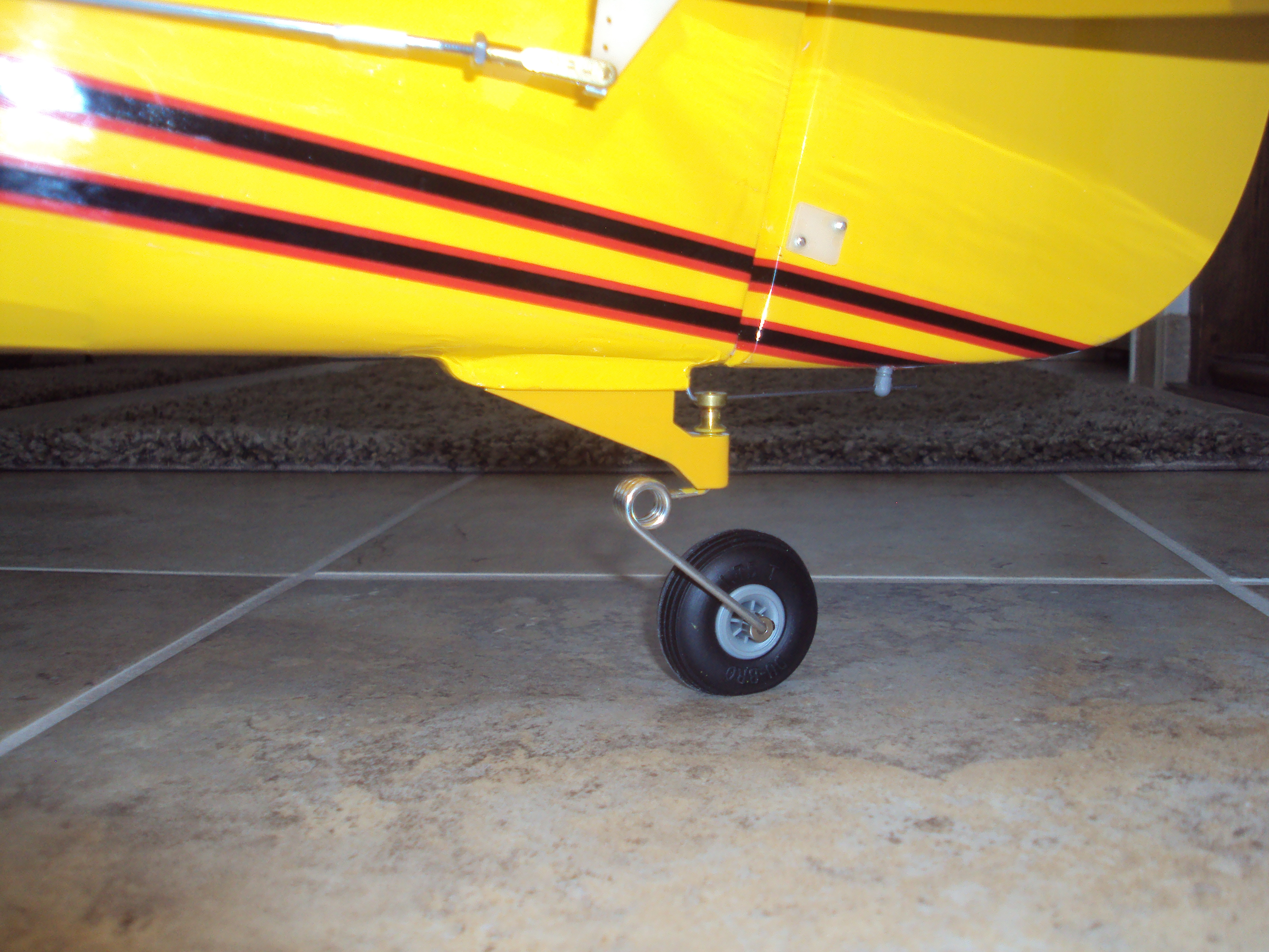

Mine came out at 14.6 pounds. Ya, a tad on the heavy side but will fly just fine at scale. Concerning that tailwheel issue, the Sullivan type seems to work fine on taxi trials. Pros and Cons please. MM

MormanMike; Whats under the covering in the tail wheel section? Is it solid? I'm getting ready to find out, but thought I'd ask you beforehand??

CannonBall, It's two pieces of 1/4 inch basswood glued together. One is about a half inch shorter and that piece fits into a recess under the tail you'll have to carve out to fit tight. It's all balsa under the tail so after it's epoxied, soak the surrounding balsa with thin CA. Then re-cover with Monokote. MM
