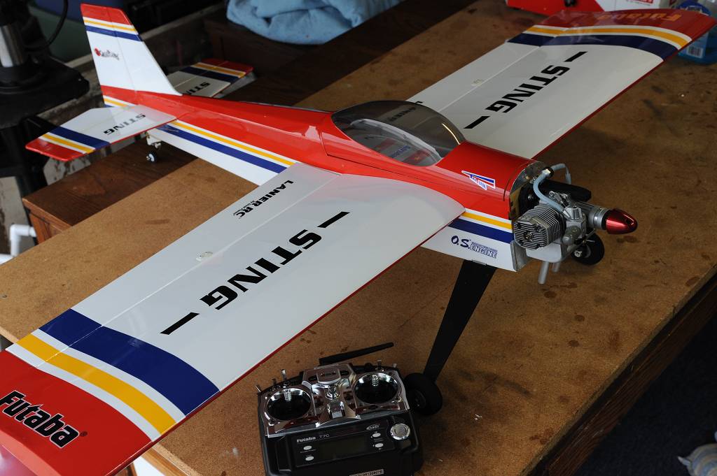

Old 09-05-2011 | 05:19 PM
  #33
Posts: 280
From: Ventura, CA
Default RE: Stinger 2
Finally finished my Stinger II. Came in at just ender 6 lbs. The YS .63 nd Hatori in cowl muffler no doubt added to the extra weight. I think this plane should do well regardless. CG is 3 1/4" behind the leading edge and I had to add about 3/4 oz of weight in the tail for the balance to come out right. Won't get to do the maiden until next week and am looking forward to it.
Dan

Old 09-11-2011 | 12:41 PM
  #34
Ernie Misner's Avatar
Posts: 5,037
From: Tacoma, WA
Man that's a pretty plane. Does the stock gear seem strong enough, it doesn't look robust but maybe it's okay. And did you beef up the area where it bolts on the bottom of the fuse any? I used to like to use nylon bolts there but they were 1/4" nylon.
So how are they flying by now guys??? What muffler on your 46AX? Anyone running the recommended bisson pitts muffler? And for the YS 63 where did you get a Hatori muffler??? Wonder if they make one for my Saito 82?
Keep the ideas coming guys, thanks loads, I'll pick up my Stinger this week hopefully and use an OS55 and pitts muffler I think, and LIFE battery for sure, only 3 ounces or so and 1100mah.
Ernie Misner

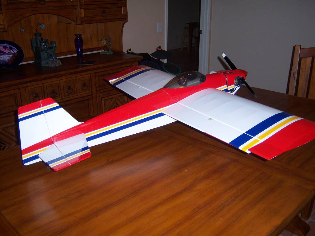

Old 10-11-2011 | 12:40 PM
  #50
Posts: 5,037
From: Tacoma, WA
Here's a pic of my completed Stinger II..... changed the decals and it is simply a "STING" now.... Used Goldberg landing gear that has some spring to it, no pilot figure - his glue joint came loose in there, had to cut him out, and he IS grounded! Also no cowling, looks more business like without it, and used a different tail wheel setup. HS 485 servos except a Tower digital servo on rudder and HS 85 servo on throttle. Tower LIFE battery for rx, only weighs 2.5 oz. and is 1100mah.
Ernie
