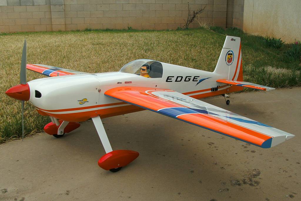

Almost there. Got the switch and fueler installed. Did final install on the engine and cut the cowl. Had to hack a rather large hole through the bottom to get the twin pipes to fit. Still, this is a very nice looking airplane, and goes together quick. All radio gear is now onboard, and I'm starting to program the plane. Maiden flight will be soon.

Bob, thanks for the kind words. I've had luck with the GMS 1.20, but I know not everyone likes the GMS motors. Lots of my buddies fly gas, but I see them fighting engine tuning headaches just as often as the nitro pilots. I suppose it's six of one, half a dozen of the other. For the big planes, gas is the only way to go, but for the 25% and smaller birds that I fly, nitro is so simple when it comes to engine setup. Other pilots on this thread are setting up their E540s with DLE 20 gassers and such. I'm sure this plane would be an overpowered rock star huck monster with a DLE 20.

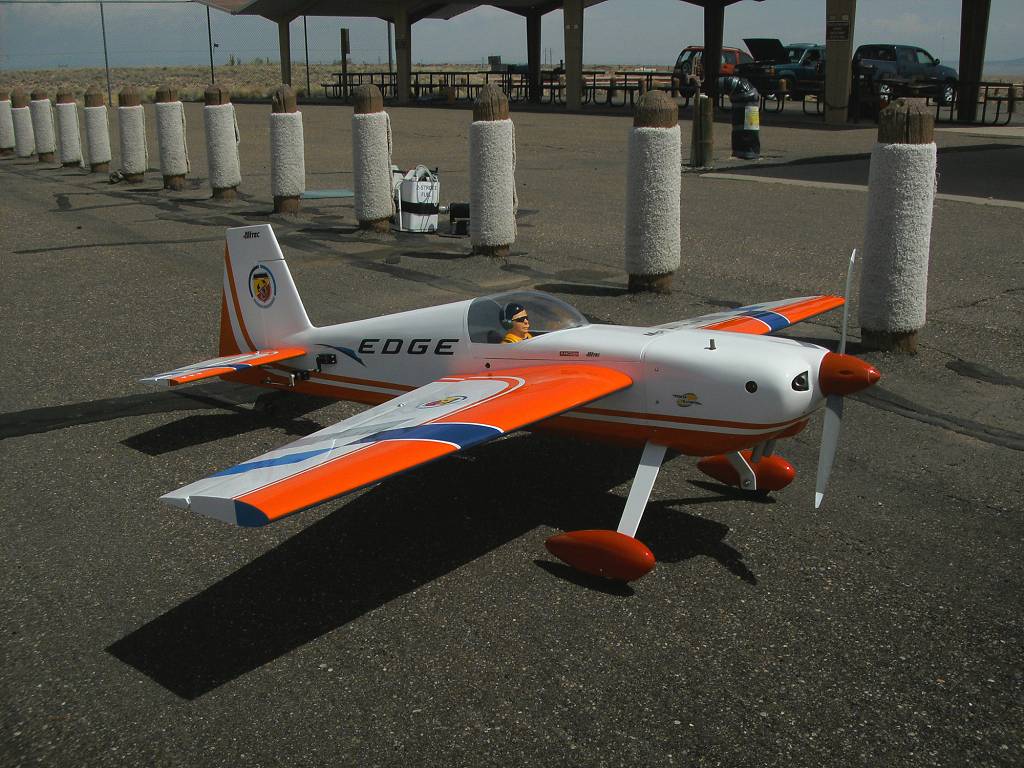

Two Phoenix Edge 540s are now done; helped Psyched get his finished off. Just gotta finish radio programming, CG checks, and hopefully maiden it next Monday. So far I like this plane; it's an easy build with lots of "big plane" features and plenty of flexibility in setup. Wish me luck...

greetings! im new here and i just received my phoenix models edge. fantastic model im blown away by the price. mines did come with CF gear. guess its standard. <div>
</div><div>anyway i have a question or 3 about it. </div><div>
</div><div>removing the pilot figure wouldn't compromise anything would it? (i ripped his ugly ass out of there) </div><div>
</div><div>also, im definitely going with the pull pull setup. im curious to know, did you (assuming someone here has done it) have to do any serious modifications to the rudder OR did you use the existing horns and existing premaid holes? (in other words all i need is the pull pull system correct?) </div><div>
</div><div>did any of you find the supplied push rods to be in different sizes? i.e the manual states (2) 80mm push rods but none of the rods are equal. maybe one is 75mm and the other is 80mm. oh well i still used it lol. </div><div>
</div><div>i know i said 3 questions but what is the REAL CG location on this plane? is it really 115mm? </div><div>
</div><div>thanks! nobody would comment or chime in on RCG so heres my new home. </div>

Dreamland,
I don't think removing the pilot will compromise anything.
Pull-pull should be easily done since there's so much space, but I went with the stock setup for the weight. What motor are you using? With the GMS 1.20, it still comes out nose heavy, so I have the battery on the former at the back of the canopy. If you're using an ignition gas engine like the DLE 20, you might want to just use the stock setup for weight control.
I didn't have any problems with the pushrods. The only 2 that are the same size are the ones for the ailerons. All the tailcone rods are different lengths. Horky, but it works in the end.
Oh, and CG? Still haven't flown yet, so not sure if the factory CG is correct. I have mine balanced a tad noseheavy off the factory CG for the maiden. Will report back on how well (or tragically) things went.

Some shots of the E540 outside in the balmy spring weather. A few things to tinker on, then hopefully tomorrow it's out to the local airport to run a couple of tanks through the motor, then possibly the maiden on Monday.

Prepare to be happy...
Made it out to Maloof this morning and ran a couple of tanks through the engine. The GMS dialed in nicely, with a slow steady idle around 1800 rpm. With the failsafe set, the control throws at the factory spec "low" setting, and the tank refilled, it was time to fly. I taxied it out and pointed south, then rolled on the power. I didn't even make it to 50% before it was off the ground and climbing away at a 45 degree angle. The plane grooved along and sucked up altitude, getting small very quickly. It needed some aileron and elevator trim, but it dialed in quickly. Conditions weren't ideal, with a milky overcast sky and lots of chop, but the Edge handled it easily.
The GMS 1.20 is waaay more power than this plane will ever need. I pushed it to 50% throttle a couple of times, but at that power setting, the plane boogies along very fast. It's just sensitive enough at the "low" throw settings to be a fine sport flyer. I used initial settings of 40% expo which felt right on the sticks. The stock CG is neutral; as you roll off the throttle, it gives a slight tail drop as the center of lift shifts forward. For pilots seeking a bit more stability, balance it a tad nose heavy on the stock CG. Landing is easy; roll off power after base to final, let it descend, then roll on power to check descent as you cross the runway threshold. Fade off the power to set it down; it sort of flares itself.
Still need to finish tuning and breaking in the engine, but this bird is a keeper; I'm looking forward to more stick time with this awesome airplane! Get yer birds done, because this will be your new favorite...
