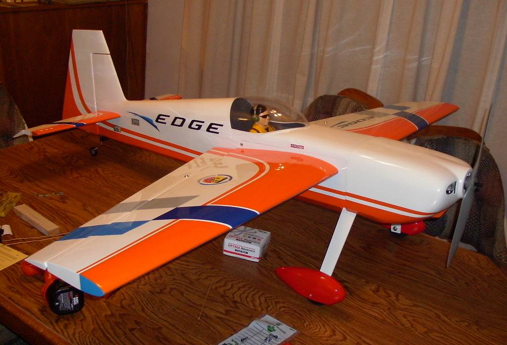

My wife bought me this plane for Christmas, it is a Phoenix Edge 540 1.20. 65 inch wingspan. I figured I will do a thread on it.
After unboxing plane looks very good, nice covering, looks pretty well built. weight of plane as you see it in the picture is
4lb 12oz. Not horrible but not the lightest. Setup will be:
DLE 20 with Stock exhaust
(5) Futaba 3051HV servos
(1) Cheetah 3000 mah LIFE battery (RX & ignition)
Hitec Optima 7 RX
(1) Miracle double switch
Tech Aero IBEF
10 OZ tank.
I will be cutting the pilot and canopy floor out, Changing all the pushrods to carbon fiber with Rcconnector rod ends and using
dubro 4-40 hardware, Dubro heavy duty servo arms.
with all hardware I am looking at approximately 8.5 pounds without lightening, I will consider using a 2100mah battery (-4oz), and no
spinner. and hopefully save 2 or 3 ounces removing the pilot and canopy floor.

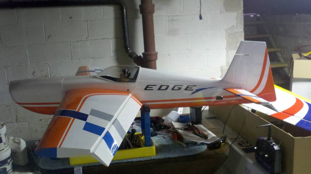

I just loose assembled it, nothing is glued yet. I was going to use my 120ax, but since there are no local hobbyshops around here
and Nitro is so much I decided on gas. I may head to the hobbyshop an hour away tomorrow and pick up my pinned hinges
and some other odds and ends so I can start building. I did cut the canopy floor and measure the stab and wings, plane is
square within 1/16th inch

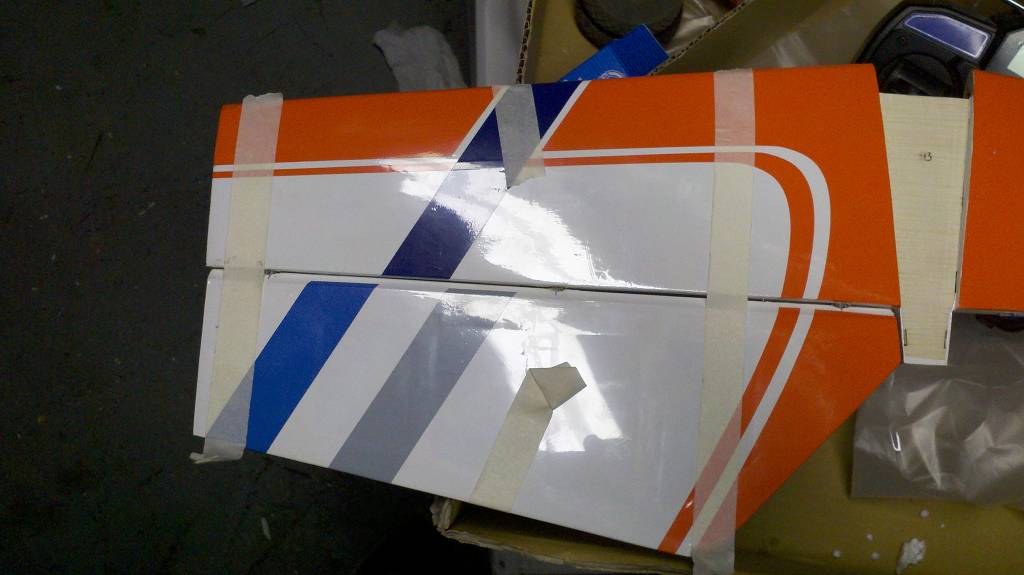

Started getting some work done on the EDGE. Drilled out all the tail surfaces for robart hinges. Hinged the left side elevator.
Realized I only had 5 hinges so I am at a standstill for a few days. I am out of work with a back injury so progress will be
slow, due to lack of funds. I always complain about not having time, now I have time but no funds.

Proteus, I just hinged the rudder yesterday. I have been enjoying this semi warm winter and flying a lot. I will be getting into the assembly soon

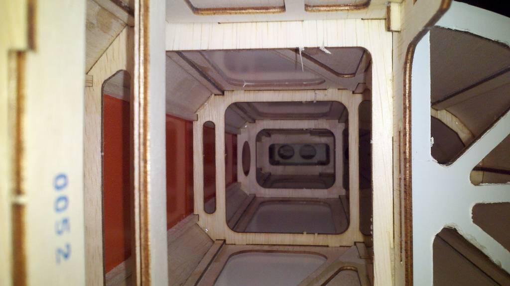

Rich, I am thinking about epoxying a piece of 1/8th ply to the firewall, and wrapping the edges with glass. It seems to be a nice ARF pretty light
and the linkages aren't horrible, the wheel pants are huge, and the tailwheel looks like it belongs on a 33%er

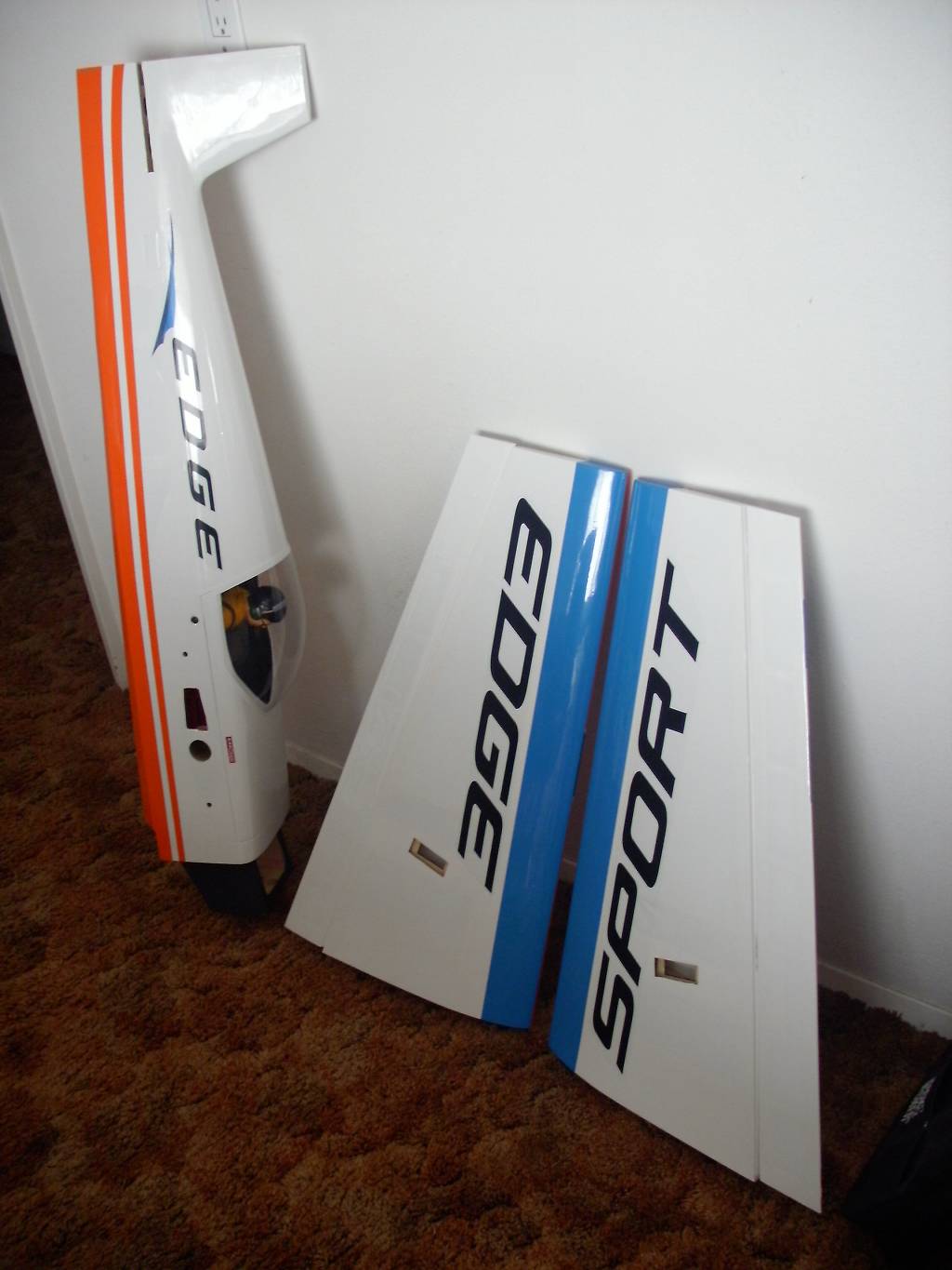

Hey guys, a caution about the ailerons. I put mine together and found a couple of very minor glitches. My wing tube is too long by about an eighth of an inch, so I'll have to cut it down. Also, watch the inboard corners of the ailerons. You need enough of a gap so that at full deflection, that corner doesnt catch the fuselage. I'll have to slide one of them out a bit and cut off/trim the outboard end. Otherwise, everything's ready for assembly.

CPT, My tail elevators and stab was a bit crooked, I had to sand it a bit and cock it to get it square in the fuse. The left elevator half sits
closer to the fuse than the right. all measurements are ok , so I will leave it. I was lucky my ailerons are fine.http://www.youtube.com/watch?v=PALdLw_HqRc
