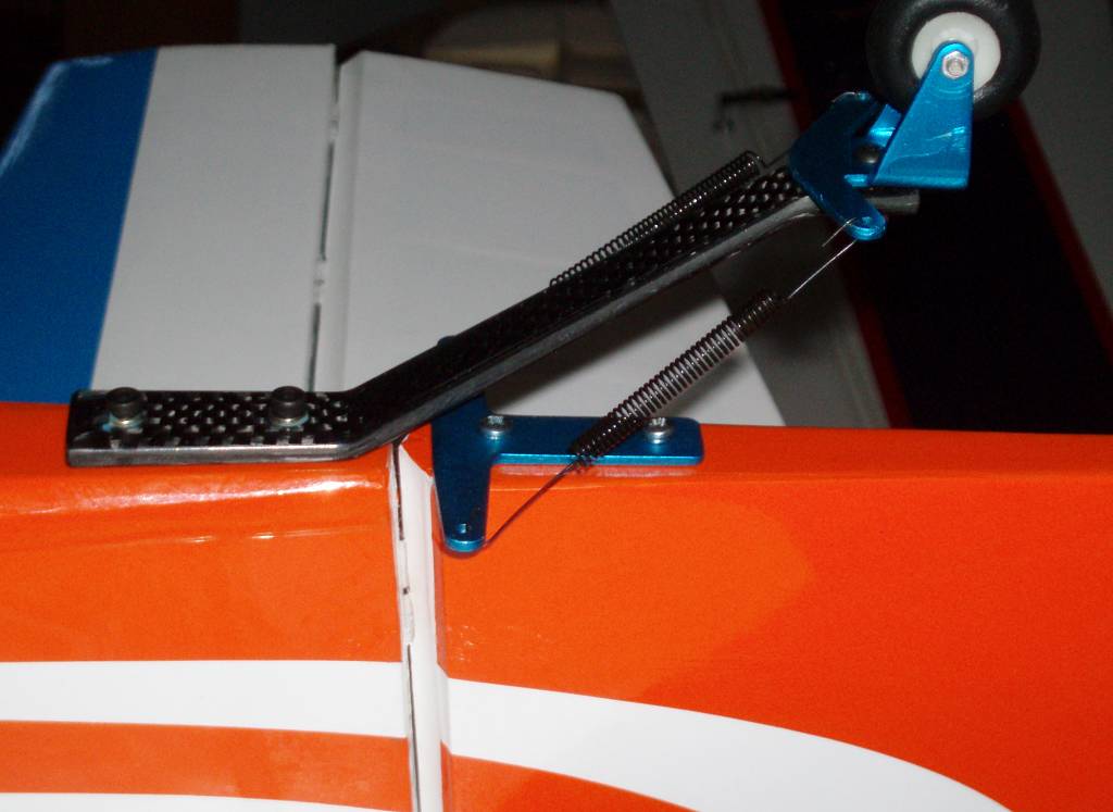

Well, I did my maiden flight the other day. The plane balanced almost perfect, but added a couple weights to the nose to make it swlight nose heavy. The plane flew great! I don't have much experience flying real rc airplanes, but can say this plane was really fun throwing it around.
I have a video. Now, This is my 5th flight ever flying the real thing so DON"T LAUGH!!!! LOL I have been into airplanes all my life and always wanted to do this, so it came a bit natural to me.
  I am changing out the tail wheel system because it wouldn't steer the plane. I had to goose the throttle to use elevator.  The landings where smooth as butter. I am seriously looking foward to flying it again. I only had time for that one flight. My wife, not that good at using video camera and couldn't keep up with whatever i was doing. lol She'll get better.

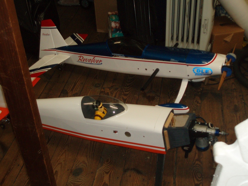

Well,I finally finished my Revolver 70" and maiden it on Monday she is one sweet plane,I posted photo's on p234 of that thread if you care to look. Now it's time to start on my Edge540, she going to be a monster with an <span class="squiggly" title="To see spelling suggestions, click this word" splc="splc" state="new" word="EVO">EVO</span> <span class="squiggly" title="To see spelling suggestions, click this word" splc="splc" state="new" word="26GT">26GT</span>... <span class="squiggly" title="To see spelling suggestions, click this word" splc="splc" state="new" word="stby">stby</span> for updates
Cheers: Rich</p>

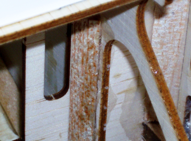

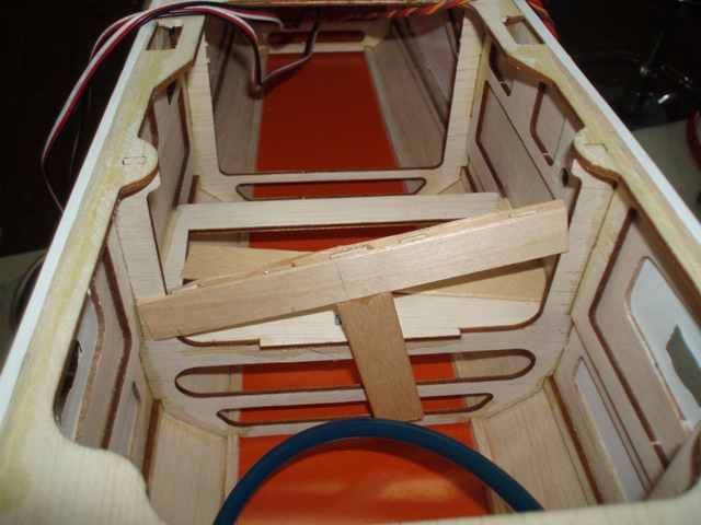

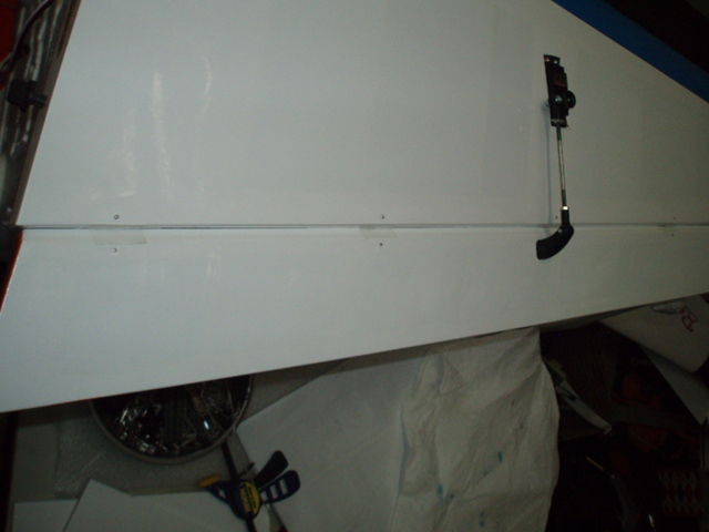

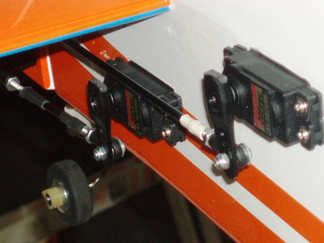

Hi I started my build this past weekend and I thought I would post my progress on the Phoenix Model Edge 540 120 ARF. I&rsquo;ll try not to bore you with abstract garbage like packaging or how well the Oracover covering is or the lack of good quality control on parts or how poorly the manual is written. Well maybe I will just a little..<p class="MsoNormal"></p><p class="MsoNormal"><u>Rating of the Model
</u></p><span style="line-height: 17px; font-family: Calibri, sans-serif; font-size: 11pt">So let&rsquo;s get started if I were too rate this kit on a scale of 1 to 10, I will give the Phoenix&rsquo;s Edge 540 a 6.5 out of 10 I would rate it higher, but a cracked wheel pan from the factory and my cowling&rsquo;s clear coat it flaking off after I cutout the engine opening . In Phoenix Model&rsquo;s defense they have done a pretty good job otherwise with this model its build well, the hardware included is okay and it&rsquo;s affordably priced, I paid under $200.00 at Tower Hobbies shipped
</span>
<u>Specs</u>-
</p><p class="MsoNormal"></p><p class="MsoListParagraphCxSpFirst" style="text-indent: -0.25in">1.<span style="font-family: 'Times New Roman'; font-size: 7pt"> 1.</span>Engine -Evolution 26cc GT with CH ignition<o></o></p><p class="MsoListParagraphCxSpMiddle" style="text-indent: -0.25in">2.<span style="font-family: 'Times New Roman'; font-size: 7pt"></span>2.Evolution Pitt&rsquo;s style muffler<o></o></p><p class="MsoListParagraphCxSpMiddle" style="text-indent: -0.25in">3.<span style="font-family: 'Times New Roman'; font-size: 7pt"> 3.</span>Electronics - Tech-Aero IBEC for CH Ignition.<o></o></p><p class="MsoListParagraphCxSpMiddle" style="text-indent: -0.25in">4.<span style="font-family: 'Times New Roman'; font-size: 7pt"> 4.</span>Spektrum AR7000 receiver<o></o></p><p class="MsoListParagraphCxSpMiddle" style="text-indent: -0.25in">5.<span style="font-family: 'Times New Roman'; font-size: 7pt"> 5.</span>6.6 v A123 Life battery 3200mah, by Hobbico.<o></o></p><p class="MsoListParagraphCxSpMiddle" style="text-indent: -0.25in">6.<span style="font-family: 'Times New Roman'; font-size: 7pt"> 6.</span>Miracle switch with fuel Dot.<o></o></p><p class="MsoListParagraphCxSpLast" style="text-indent: -0.25in">7.<span style="font-family: 'Times New Roman'; font-size: 7pt"> 7.</span>Servo&rsquo;s- Hitec 5625 on Ailerons, and Elevator and Hitec 5645 for Rudder
</p><p class="MsoNormal"><u>Modifications-
</u>
</p><p class="MsoListParagraphCxSpFirst" style="text-indent: -0.25in">1.<span style="font-family: 'Times New Roman'; font-size: 7pt"> </span><span style="text-indent: -0.25in">1.</span><span style="text-indent: -0.25in; font-family: 'Times New Roman'; font-size: 7pt"></span><span style="text-indent: -0.25in">Beef firewall up for Evo 26GT remove blind nuts in firewall and install GP 120-160 size beam mount.</span></p><p class="MsoListParagraphCxSpFirst" style="text-indent: -0.25in"><o></o></p><p class="MsoListParagraphCxSpMiddle" style="text-indent: -0.25in">2.<span style="font-family: 'Times New Roman'; font-size: 7pt"> 2. </span>Add bulkhead/ former behind wing box [weak point on airframe] simple solution lots of photo&rsquo;s<o></o></p><p class="MsoListParagraphCxSpMiddle" style="text-indent: -0.25in">3.<span style="font-family: 'Times New Roman'; font-size: 7pt"> 3.</span>Replace Rudder, and Elevator steel rods with carbon fiber one&rsquo;s ,linkage supplied are too short to increase throws and control horns would not line up vertically to servo&rsquo;s<o></o></p><p class="MsoListParagraphCxSpLast" style="text-align: justify; text-indent: -0.25in">4.<span style="font-family: 'Times New Roman'; font-size: 7pt"> 4.</span>Build throttle servo mount in firewall box for a more linear throttle response.
5.<span style="text-align: left; text-indent: -0.25in">Now comes my favorite part, photo show and tell, Phoenix has built a light yet strong airframe, the use of light plywood is extensive in the wing and fuselage, but there is one drawback of this construction the rear spars for all the control surface have little bonding area for Robar hinges without cutting the Oracover and installing balsa blocks. Photos is of rear spar of wing note the Tee spar.
Hmm I'm doing somthing wrong, can't upload more photo's.....
</span></p><p class="MsoNormal"></p>
Old 10-10-2012 | 08:10 AM
  #94
My Feedback: (16)
Joined: May 2011
Posts: 158
From: Elizabeth, NJ
Default RE: Phoenix Edge 540 1.20

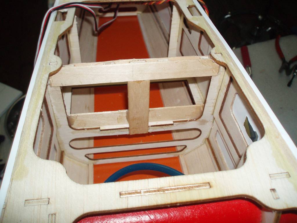

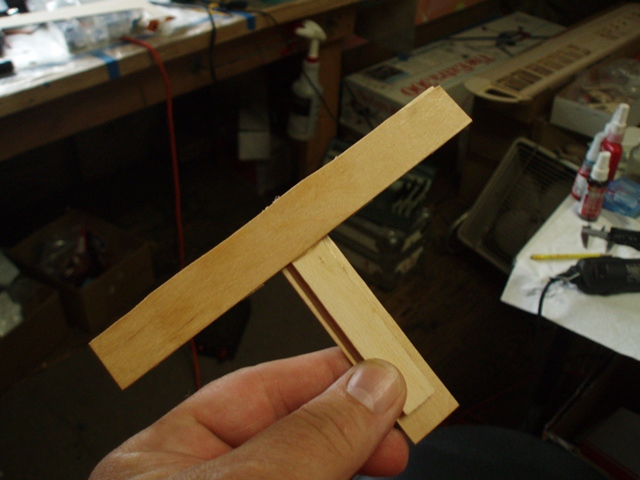

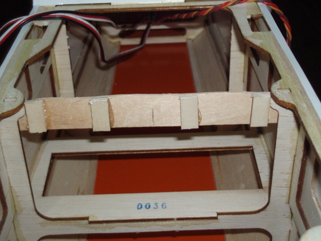

<span style="text-align: justify; ">So I elected to use the CA hinges supplied with the ARF, I personally have no problem with using them on this size airframe; I did however pin and seal all of the CA Hinges. See photos
</span><p class="MsoNormal" style="text-align:justify">Firewall- The Edge 540&rsquo;s firewall isn&rsquo;t too bad from the factory but it flexes and since I'm putting a 26cc gasser on the airframe some &ldquo;Guesses&rdquo; needed to be install [balsa triangle block] around all of the firewall former and bulk heads.*****Note**** if you are moving the fuel tank over the wing spar you must install the fuel tank support bracket it is structural to the airframe. More photo&rsquo;s
<o></o></p><p class="MsoNormal" style="text-align:justify"><o></o></p>

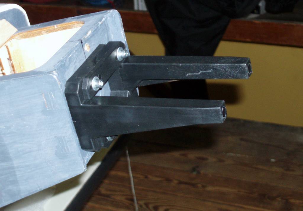

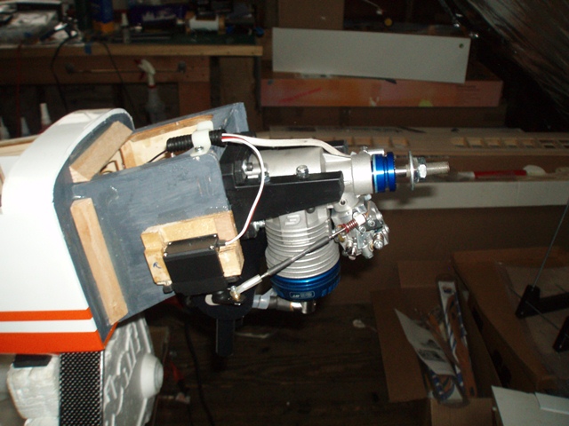

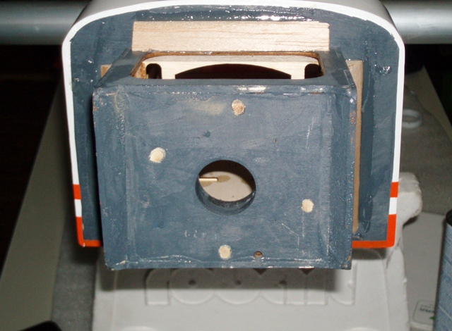

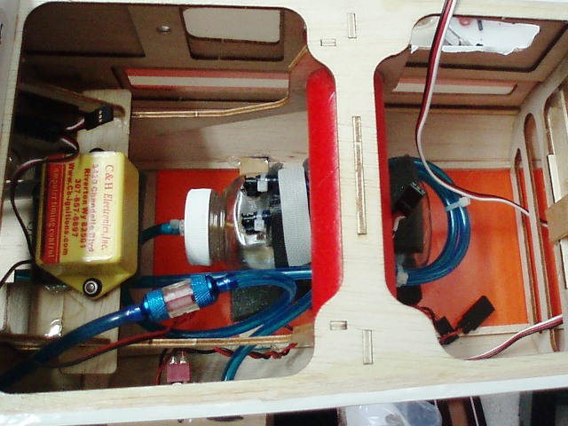

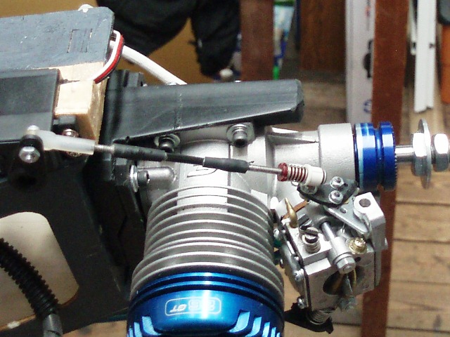

<span style="text-align: justify">Originally I plan to install a DLE-20 in my Edge 540, however if you use the DLE-20 you will need to remove some of the firewall so the carburetor will fit. I was unwilling to remove any material from the firewall; firewalls need to be as strong as possible and uncompromised IMHO. I decided to save my DLE-20 for my Topflite 60 size P-47D project and use my Evolution 26GT that has been waiting patiently on my shelf. The Evo 26cc total weight with ignition and muffler is 10oz heavier than the DLE-20 and about 8oz than the OS 120AX . I know I&rsquo;m going to be nose heavy, since this model comes out tail heavy hopefully added lead ballast in the tail will be minimal.</span><p class="MsoNormal" style="text-align: justify">Phoenix has missed &ldquo;The Mark&rdquo; with their engine installation- 45 degree engine set-up, Blind nuts glued in with hot-glue. If you are using a Glow engine mount the engine horizontally. IMHO Phoenix should just laser edge the center lines and offsets into the firewall and let the customer decide how they want to mount their engine [rant complete].Next I removed blind nut plates which where held onto the firewall with hot glue, located center and installed the Greatplanes 120-160 engine beam. The rest of the photos show installation on engine.</p><p class="MsoNormal" style="text-align: justify"><o></o></p>

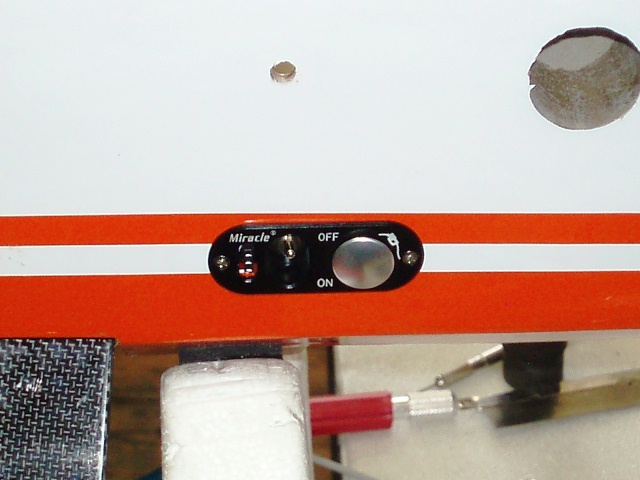

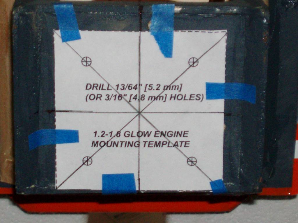

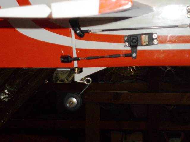

<span style="text-align: justify; ">Progress update, worked on the Phoenix Edge 540 this past weekend. First two photos are of the stock tail gear [total garbage] and the Sullivan&rsquo;s tail gear replacement P/N S861,the nice thing about the Sullivan gear is the hole on the gear match the existing hole perfectly&hellip;The rest of the photos show the &ldquo;Tee brace &ldquo;I added to the former aft of the main wing support former and forward of the servo tray, which needed addition support.</span><p class="MsoNormal" style="text-align:justify"><o></o></p><p class="MsoNormal" style="text-align:justify">I also installed all the remaining servo&rsquo;s, made carbon fiber linkages, cut the cowling and installed fuel tank and fuel lines. Installed IBEC, ignition and receiver. What&rsquo;s left install cowling and propeller, binded receiver and program radio,CG and clean &ndash;up and route wiring. Hopefully I can maiden next week
<o></o></p>

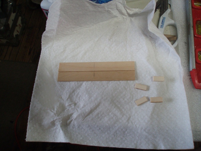

<span style="text-align: justify; ">Here&rsquo;s some photo&rsquo;s in no specific order, Edge hanging with his bigger brother, some photos of throttle linkage in &ldquo;open&rdquo; and &ldquo;closed&rdquo; position some more of fuel tank and switch boring stuff..
