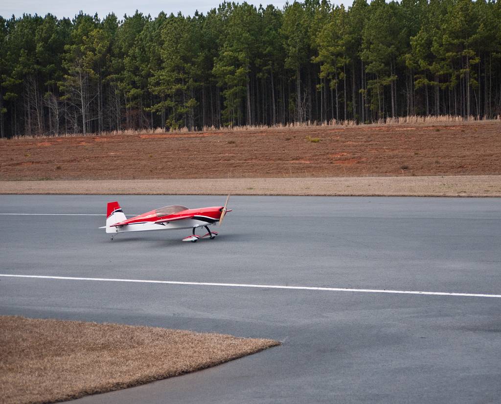

The maiden was successful. I have to say its a great flying plane. The DLE 55 was plenty of power for it. I think I need to move the CG forward some as it was a little too pitchy for me.
Its a keeper, so if you're on the fence about an AW, I'd say get one and look it over real good as you're putting it together.
