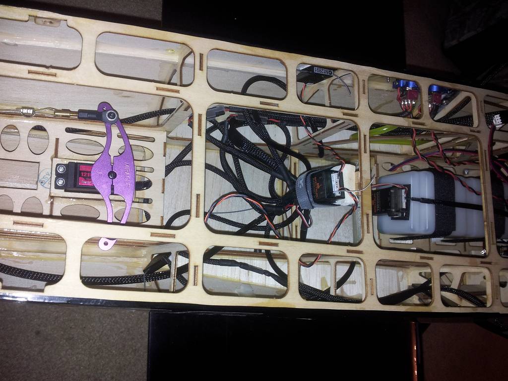

It does fit flipped around, but still has a goofy angle.. Whats your thoughts?

The control arm screw hole pretty much lines up with the center of the servo, so it's going to be the same no mater what wayI go... I will try a smaller arm later today to see if I still get the throws I need...

My arms were not nearly that big,,, Ya might want to think about relocating the servo higher.
The Motor and Radio gear all looks fine,, apparently Gold Wing had engineered crumple zones,, namely the fuselage

That was the first thing I thought when i mounted the servo and hooked them up... Right now, the only way to go is up, the two servos are pretty close to one another, so going down isn't an option... I am going forward with the rest of the install first and do some more thinking on this one....

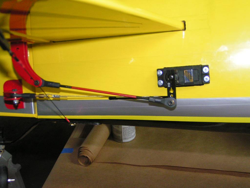

Yeah,that's what itcame with... I am going to do away with them on the elv. and just use them on the ail. Could you do me a favor and measure yours from the screw hole out, I see another trip to my LHS coming soon.. I ordered the Hangar 9 pilot today, should look good sitting in the drivers seat...

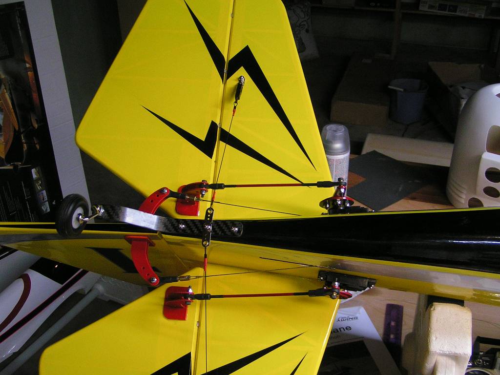

New problem setting up the pull pull on the ruder, the arm was to big.. It wouldn't clear the former and I had to cut it down, now the linkagehits.. I am going to try going in on the holes and see if it clears.... I will post pics later... I'm trying to figure out where to attach the flying wires to the stab, it has a block glued to the front of the LE and to a rib.. Gonna look at your pics again,are yours in the LE or that block?

I looked at the pics of yours again, looks like it's in the block....Back to the shop for some more fun!

your servo arm and pushrod linkage should be at 90 degrees instead of your servo arm being 90 degrees in relation to servo. need to move your servo arm a few splines so linkage and arm are at 90 degrees. but at full deflection the linkage will over center and move control surface in opposite direction. (unless you set servo endpoints so it can't over center) poor design in servo location on that model

Your 100% right, it's a very poor design.....
I see what your saying on the arm and linkage, going to get some smaller arms and see if I can't get it like what you are saying without having to move the servo.....

Flying wires are done and I am pretty happy with them, added a ton of suport and easy to adjust...
Scale gave me the idea to use the fishing leader and it worked out great, I went with the nylon covered steel 45 pound, dubro rigging couplers and a dubro 4-40 quick connect and a little shrink tubing....

Received 54 Likes on 52 Posts
From: Avon Lake, OH
Default RE: Goldwing 50cc Pitts Python V3.
Jimbo,
The servo arms are just 1", control horns were about 1.5" out, High rates were set at 140% with -75 expo, Low 90% and -60 (futaba) High rates gave me about 45 degree deflection, I never measured to see exactly what is was. Lets just say it was plenty. ATV set at 90% up 75% down, max before binding
Ailerons were the same arms/horn distance High 100% -70, low 60% -40 (but ATV was set 140% so I maxed out the travel that way)
Why they gave you those ginormous arms I don't know,, you'll have to reduce your end points so much?? . I didn't realize they were that big when you showed them being painted. I just don't see the point in using arms that big.

Here's a pic of the rudder now, everything clears.....

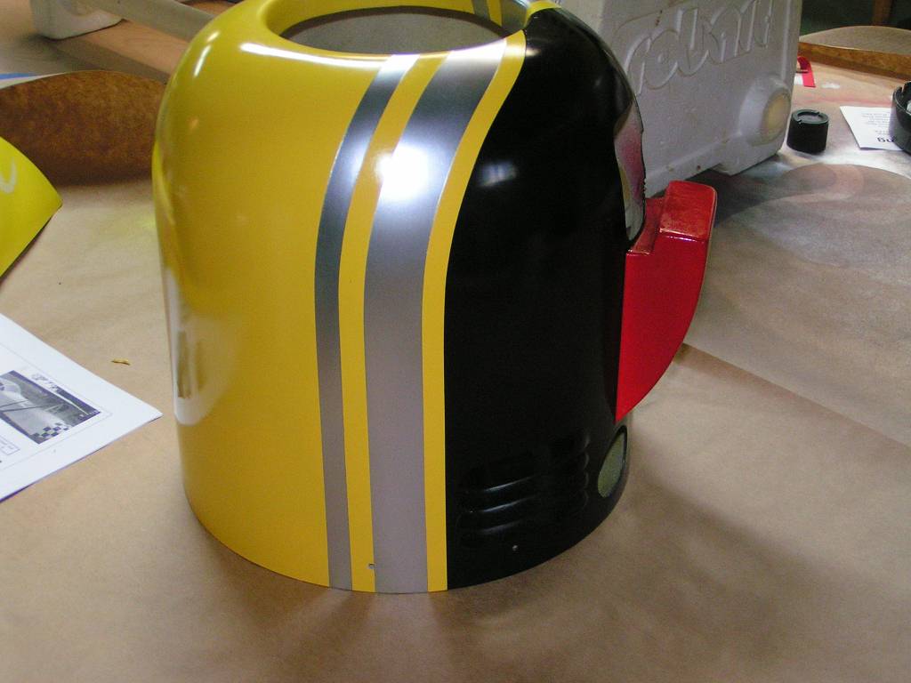

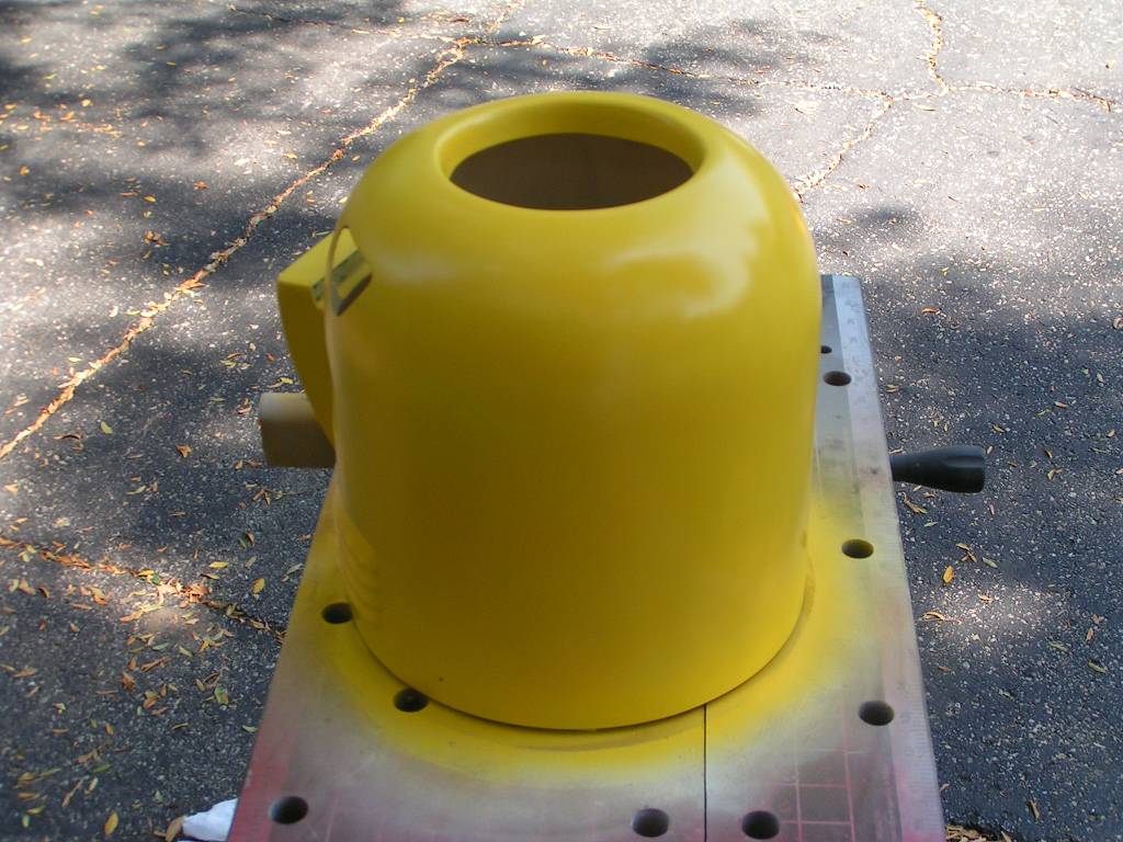

Ahhhhhhhhhhh, the cowl that was a pain in my rump! Well I wet sanded the last coat of primer with 400gtand shot the first coat of color, what a difference.. Can't see all the ugly seams any more and it's nice and solid, the EzeeKote and glass did an awesome job... Couple more coats of yellow and I can start doing the other colors, 4 in total..........

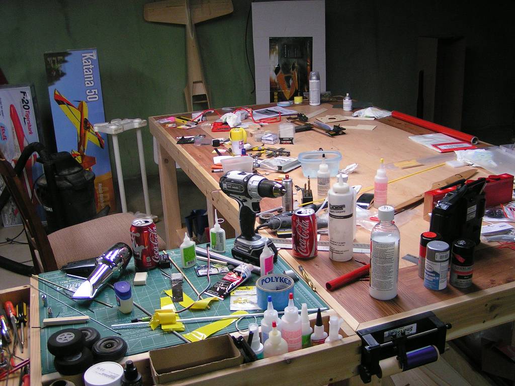

I finished up the throttle hook up and it's working just the wayI want it. I also got my fuel dot installed, kind of a pain on such a round fuse.My pilot came in as well, I will mount it tomorrow, just had to take a pic with him in there...lol
I'm having problems with matching the yellow on the cowl, as you can see in the pics it's to dark.. I'm gonna try on some scraps to see if I can get it better tomorrow...
Moving on to the ailerons, but first, a bench cleaning is in order.. Man, the bigger the bench, the bigger the mess...

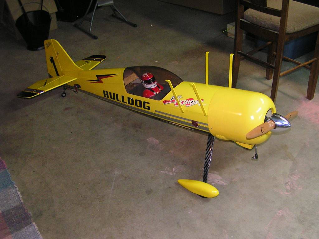

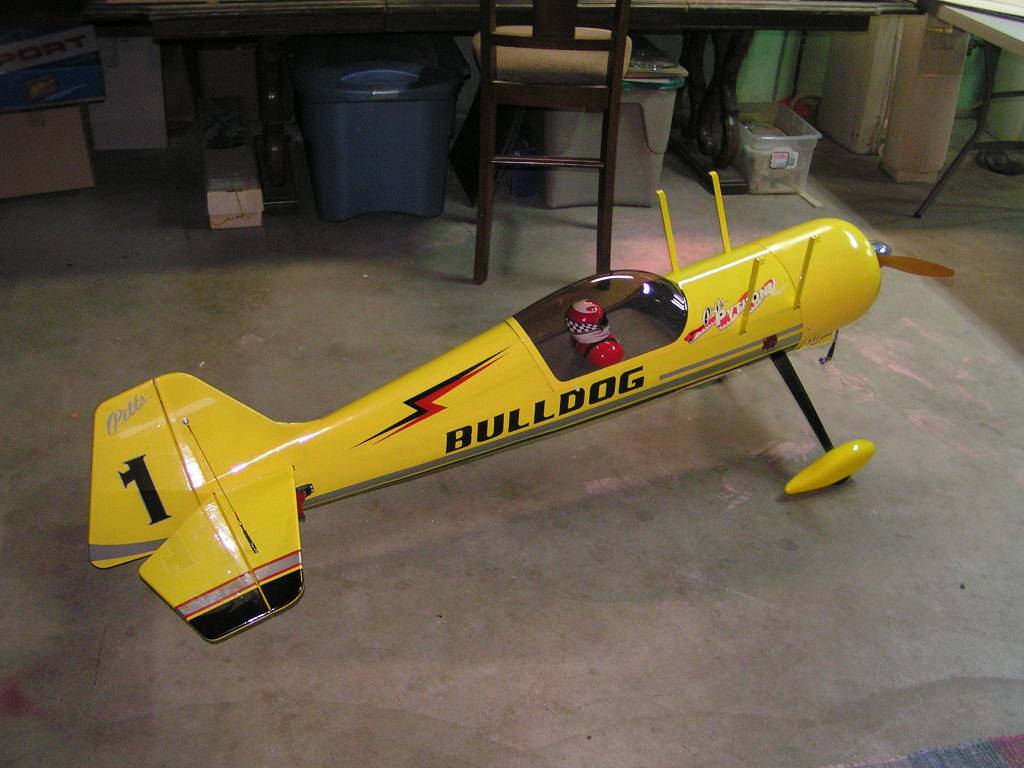

I decided to stay with the yellow, I have a big graphic ordered that will be going on top and will flow onto the canopy.. Once that is on I can add the rest of my scheme and very few spots of yellow will me meeting up..
Here are some pics as to where I am now, big difference as to what it was.. I still have to shoot the rest of the red once the graphic comes in..
Scale,
I know you could appreciate the OMG moments I had with this cowl, I had my doubts with it a few times that i would ever be able to get it to look good, but I couldn't be happier with the results......

Here is the new arms installed, The last two are the throws I get at full 140%, didn't put a meter on it, but it's a lot...I know it still has an angle, but it's much better then it was.. I really don't want to move the servos if I don't have to and will decide after i fly it some first...
