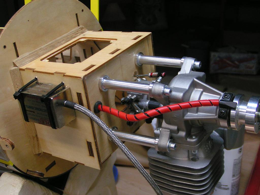

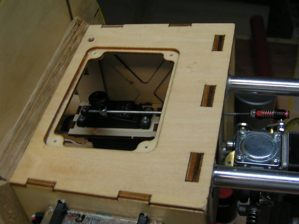

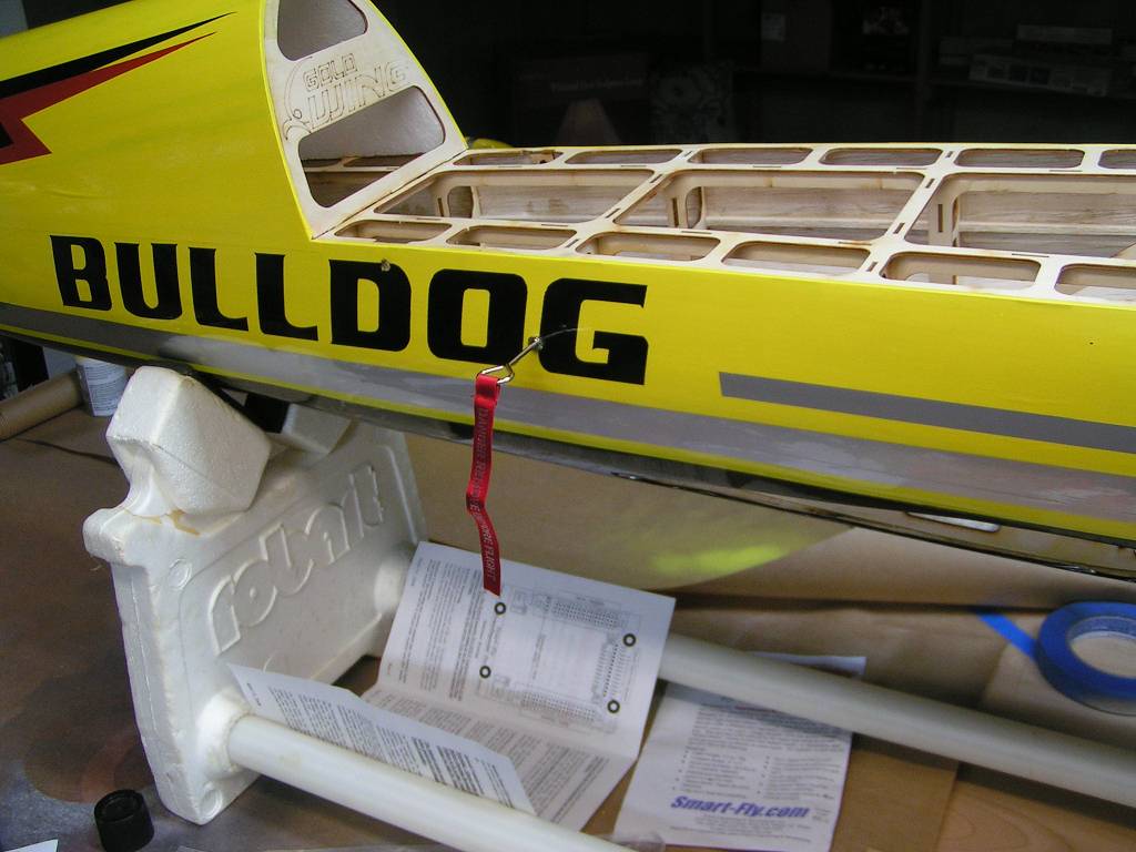

Getting other things done as well, got the smart-fly installed. Nothooked up, the battery and switch is just a temp toget linkage hooked up, that's why my servos are plugged into theRX..
Got the pin switch mounted and the fuel dot as well.. The ignition is mounted and throttle is hooked up, stillneed to do the choke...

Old 08-28-2012 | 03:21 AM
  #177
scale only 4 me's Avatar
My Feedback: (158)
Posts: 10,421
Received 55 Likes on 53 Posts
From: Avon Lake, OH
Default RE: Goldwing 50cc Pitts Python V3.
The cowl looks great,
I still don't care for the geometry of the ele linkage,, I think I'd try moving the horn above the servo and go to the next hole on the horn,, that might give you closer to 45 degree throw.
Old 08-28-2012 | 04:52 AM
  #178
Joined: Dec 2010
Posts: 1,433
From: Mt Morris, IL
ORIGINAL: scale only 4 me
I tried it on the inner hole and it wasn't enough throw, it's on the farthest hole out now, only two holes on the horn... The only way to fix it is to move the servo up and go back to the old arm, or larger after market arm.. It's a crap design with this style control horn, the control horn hole is in line with the center of the servo... Wait a minute, what if I cut that horn off and used the same style as yours and I have some in stock in the shop.. Hmmmmmmm, typing that statement about the control horn might have just fixed the problem...
First I am going to put a meter on it and do the math on paper to see what I need to do toget what I want on throws... I agree, it's still not right and I won't be happy till it is........
Jimbo

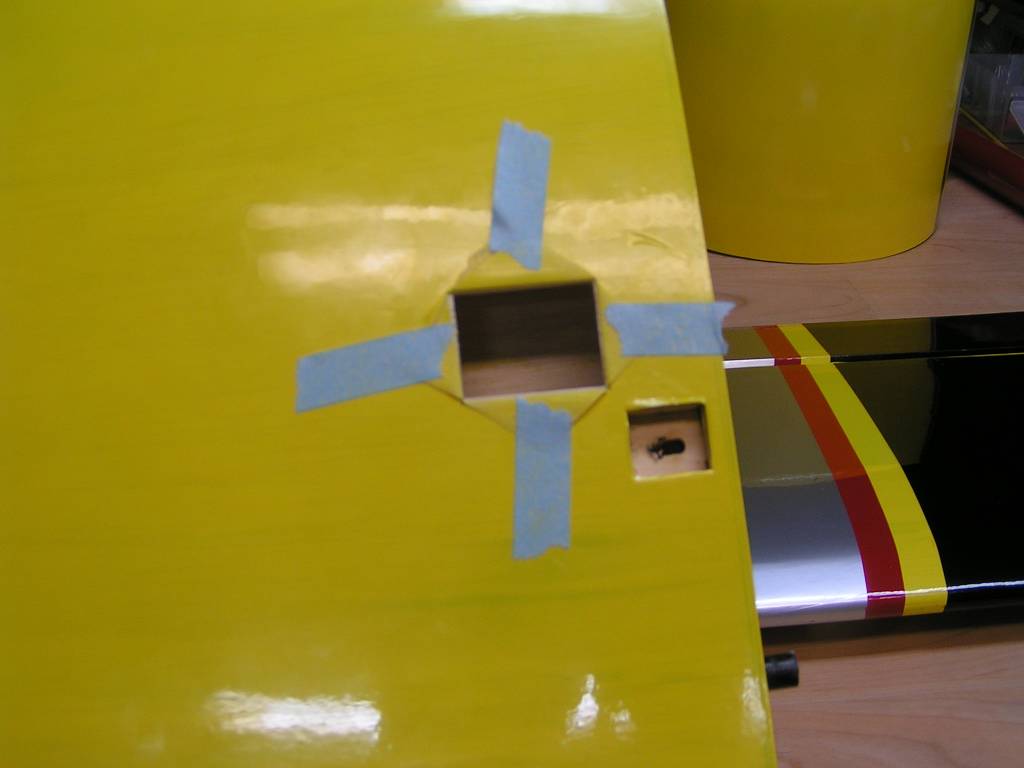

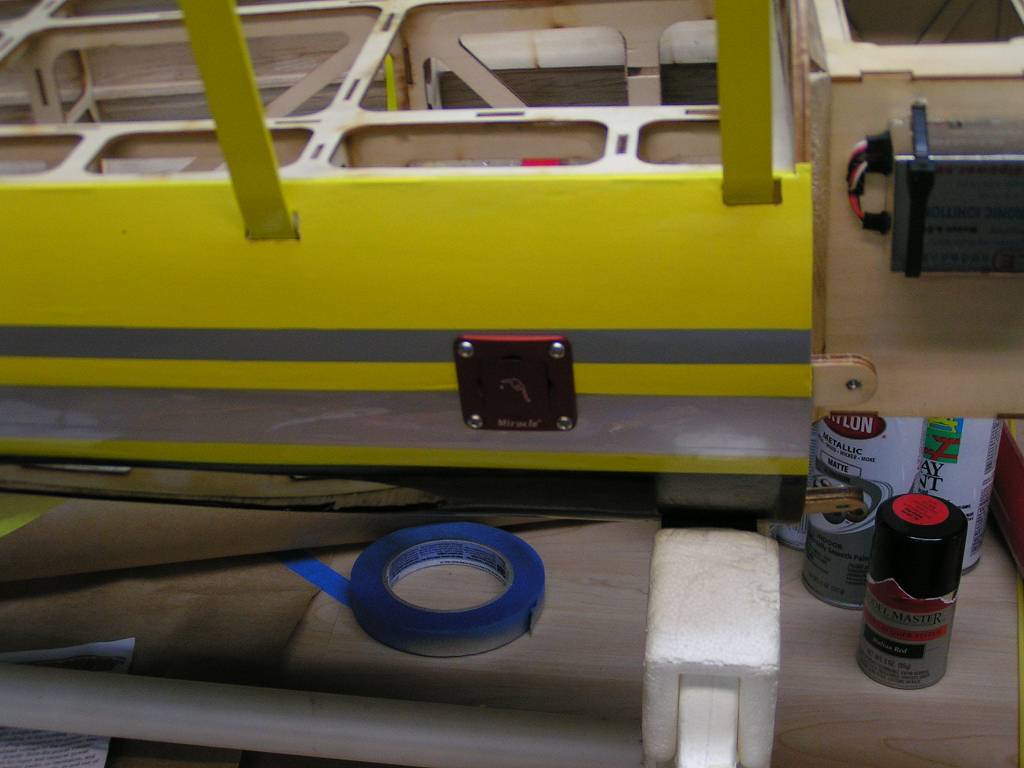

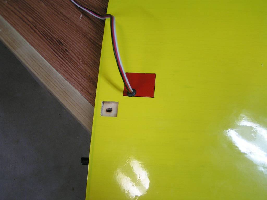

Well I am pretty much screwed on changing the location of the elv. servos, gotsick of messing around and went to move them and I can't.. Above the servo locations is a stringer and the deck of the fuse, if i cut into it, the whole back end would beweak.. The only choice now is to cut off the horn and go with a bolt type horn, I will make that decision after a few flights...
I made the top wing one piece, the 3 piece stock design was weak and mine didn't line up for nothing. There are some pics back in this thread showing the gap i would have had...
Any how, I made hatches on the bottom of the center section to make my connections at the field.. They are held in with magnets and will stay attached to the wire running down the strut.. I picked up some 3/4" yellow shrink tube to attach the wire to the strut, it will work like a charm and you won't see it inless you are looking for it...

Ok, I'm feeling the red accents now ;-)
I like the servo wire access hatches too, very smart

Old 09-01-2012 | 06:02 PM
  #186
Joined: Dec 2010
Posts: 1,433
From: Mt Morris, IL
I took the pitts to our fun fly today for some show and tell and to run the motor some and ran she did.. After I primed it Iopened the choke and she spit on the third flip, closed the choke and one flip it was running.. I tell ya, the factory setting's on the carb are pretty spot on, I didn't check the R's but it sounded great.. I didn't want to run it to much on the ground, so I shut it down after a few minutes and the temp gun read 174... I ran it again later on in the day and decided to range check the radio, no problems there...
My list of things to do before we take it to the air is pretty short...
Need to balance here.
Check the incidence on the top wing, the stab and bottom wing are right on the money.
Adjust all the throws and set up my triple rates..
I need to re adjust the throttle servo, I have it set wrong.. I get way to much response out of the motor with each click on the stick, I will redo the end points. I did it the fast way so I could bring her to the field today, any tips on this and I am all ears...
Other then going over everything elsewith a fine tooth comb, I think it's about ready.... I did dumb thumb my little EDF in on landing, should have never flow that dang tiny airplane today.. It was windy and very cloudy, but no excuse, I zigged when I should have zagged. It's fixable enough!

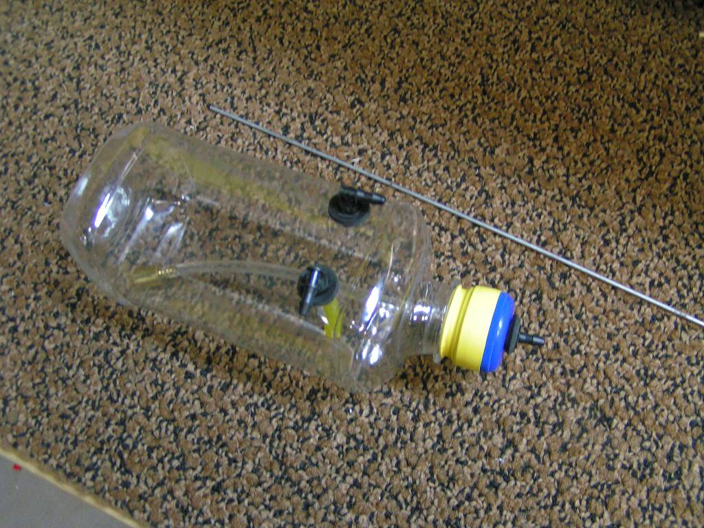

Scale,
I'm planning on balancing her tomorrow, care to tell me how you went about it on yours?
I made a water bottle tank and took out the temp oneI used last weekend, it is 16.9oz fiji bottle.. I love being able to see the plumbing with the clear bottle, makes checking things nice and easy...

My CG was set per the crappy manual and it flew fine for me,, my batteries (2xA123 2300mah) were under the aft part of hatch with a Ign. pack up to on the side of the firewall box,
good luck
