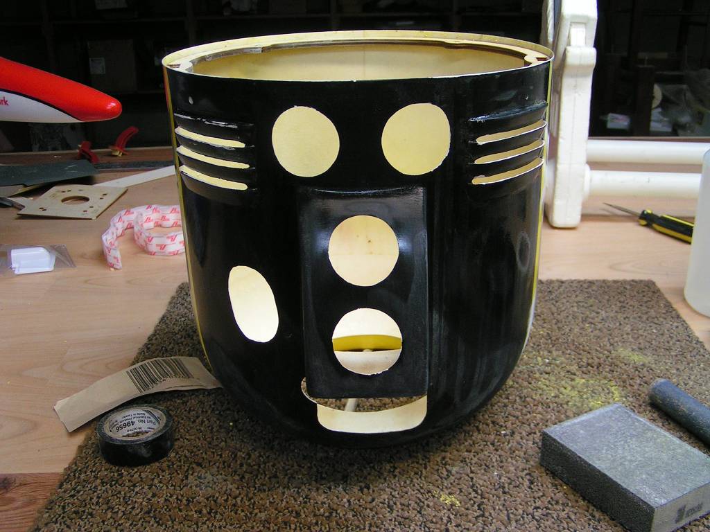

It's a mess for sure on the cowl and I can't find an easy fix.. I tried some D.A. and it took off the stuff that was loose, but it took some time.. With all the spiderweb cracks in the cowl along with the seems as ugly as they are, I decided to re do it... Going to start sanding it down tonight and that thought alone makes me want to puke... What would be a good filler to use on the joints, not sure how much of the old paint I will be able to sand off and I don't want to use anything they might weaken the glass?
I have to sand down the sides of the canopy as well, it sits up to high and won't clear under the cowl and you seen the pick on how high it is to the turtle deck.. Once all this is done I have a pretty cool paint scheme in my head, should look good.. I'm like most modelers, like to take pride in my stuff.. Even if I was able to get off the rest of the CA and clear coat, I wouldn't be happy with the other issues... Funny thing is, when i was at the hardware store, I picked up some 600, 1000 and 1500 waterproof sand paper...

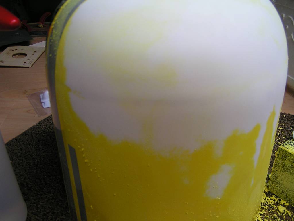

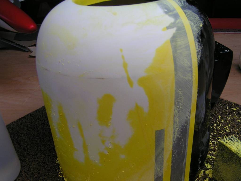

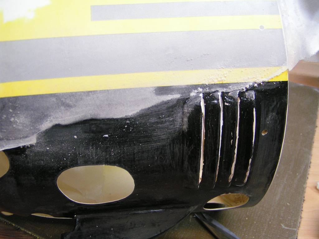

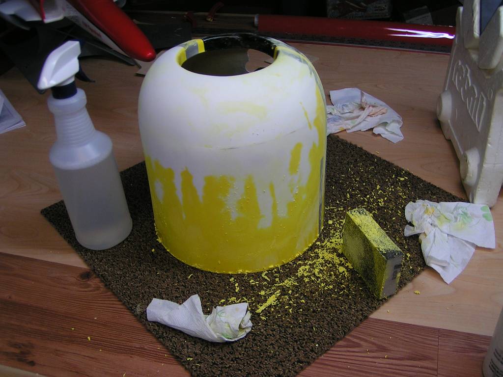

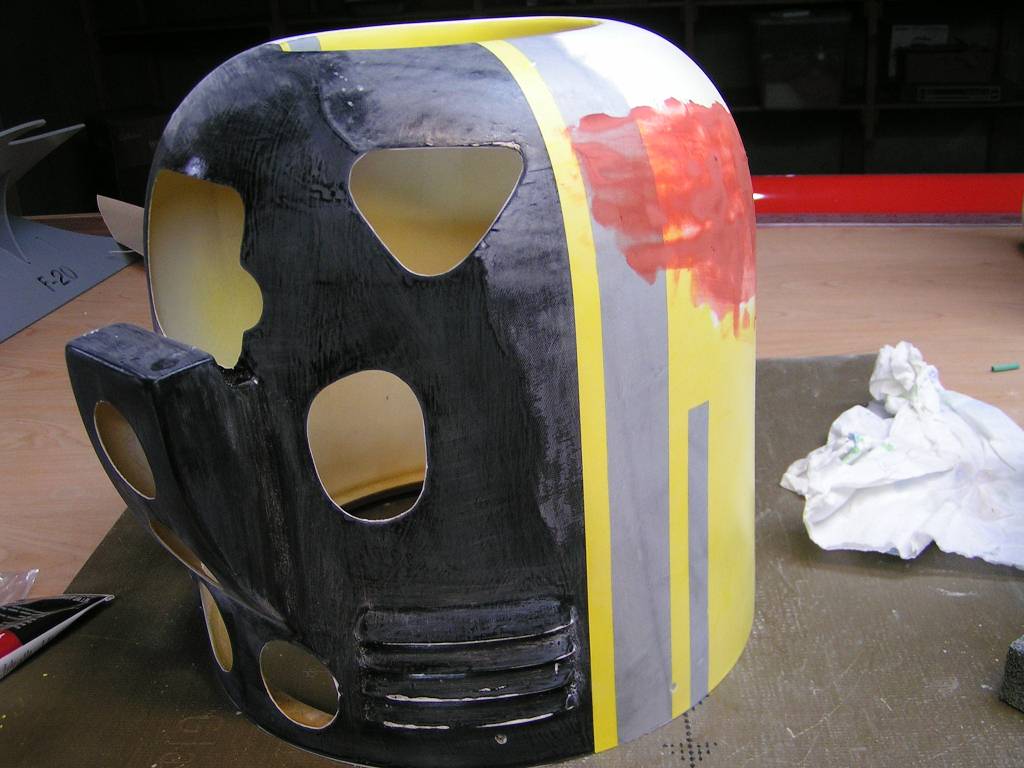

Past the point of no return now, I forgot how much I love wet sanding paint off...
I keep telling myself I will be happy when it's done!
You can see the crap job they did on the seam, going to sand it down as much as I can, then blend it in with some filler...

I have another thread going on in the Question forum about re doing this cowl...
The skinny is, it's polyester and it's crap.. The cracks I had in the paint, are cracks in the gelcoat, doing some more sanding last night, the to which is very weak, pushed in and cracked some more of it.. What a mess!!
My options are to just paint it as is and keepon GMP-GW for a new one, but I doubt i will ever get one out of them and who's to say it won't be a POS as well... Option two and probably the one I will take, fix it right.. I will have to glass over it to beef it up and give me a good foundation to build off of.. I was thinking of glassing it and trying the Liquid sheeting over that, then primer and paint. I have another plane that I am planning to use the LS on and this will be a good test to see for myself how it works... All in all, it's a lot of extra work.. finding it hard to keep a smile on my face!!
Jimbo

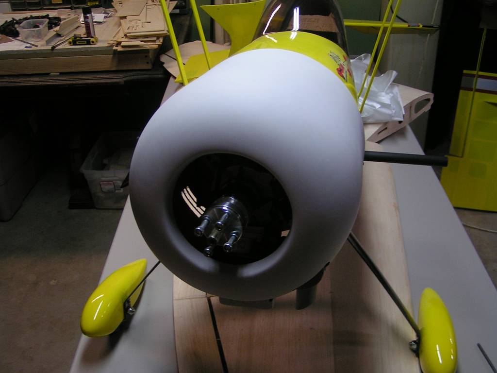

#117

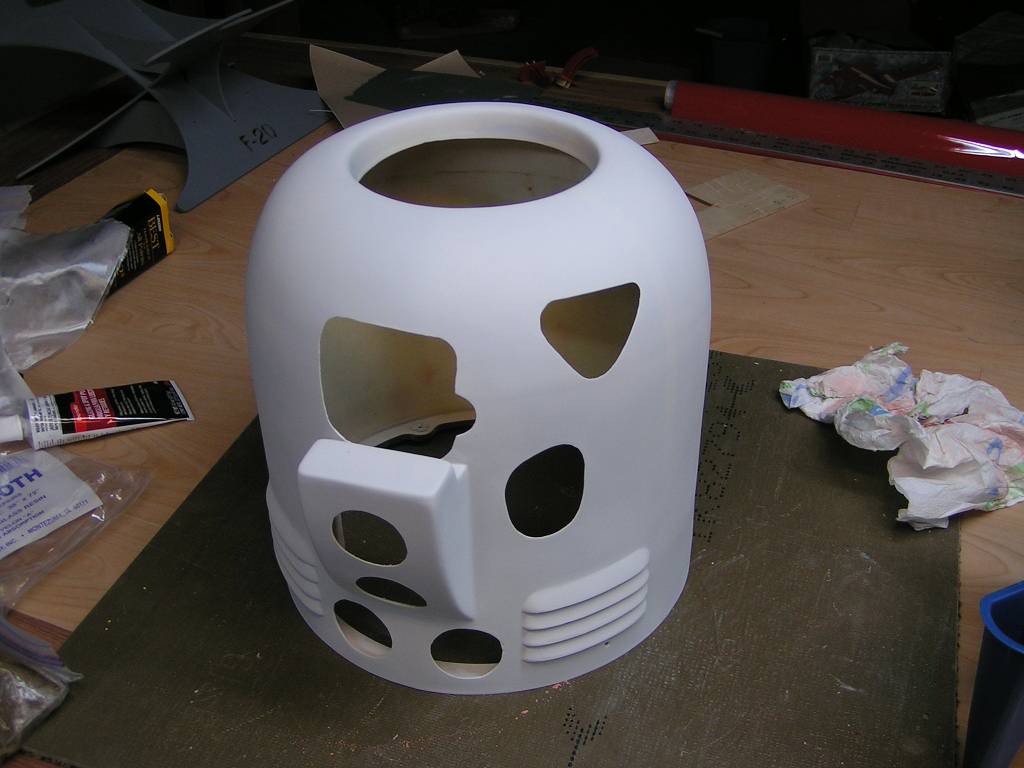

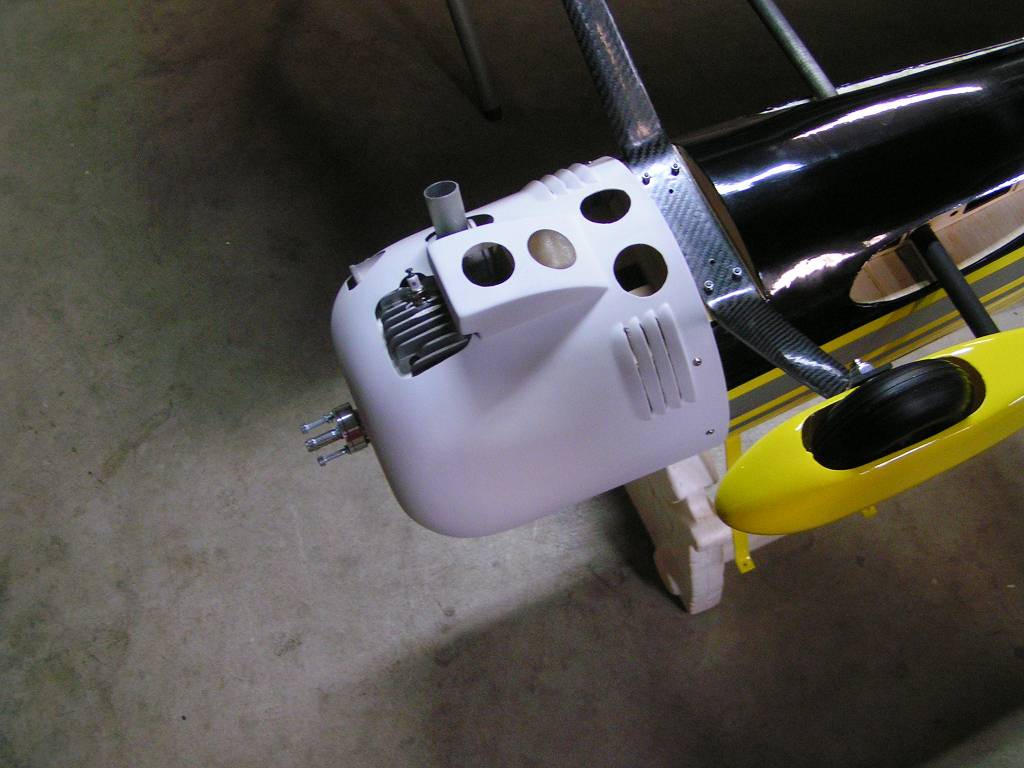

Every once in a great while, we come across a product that makes us say WOW! Well I found my wow product with Ezekote resin...
This stuff couldn't be any easier to use and the results are awesome. I gave the whole cowl a coat like the directions say, let it dry for the 20 minutes it says to and sanded it down for the next coat.. Does it sand like a dream and filled all the little pits fromcrap paint job that i had to go over.. Then I applied the glass where I wanted it and brushed in the second coat, it recommends 1/2oz cloth. all I had was some 1.5oz and didn't feel like waiting to order, I also wanted to stiffen up the top of the cowl where it was weak and cracking, so I went with it... I know you cant see it in from pics, but it's awesome, smooth as can be. After the glass coat dried, I cut all the extraglass with a sanding block and feathered it in where I stopped it.. I did this so that the last coat would help fill the transition and it worked out great, no filler needed... After the third coat dried, I sanded it down and would be ready for primer if i didn't have to apply filler on the seams that caused me to do all this extra work.. I am using bondo to take out the flat spot on top and blend the ring better.. The EK and glass pretty much took care of the ring, but I just want to be sure...
Oh, besides having no odorclean up with this product is awesome as well.. The extra I had poured out went back into the bottle and my brush cleaned right up with water.. I really don't think I will ever glass with epoxy resin again, I liked it that much... With ER there is no way I could have did 3 coats as fast as this, a couple hours and it's ready for primer, pretty good stuff..
#118

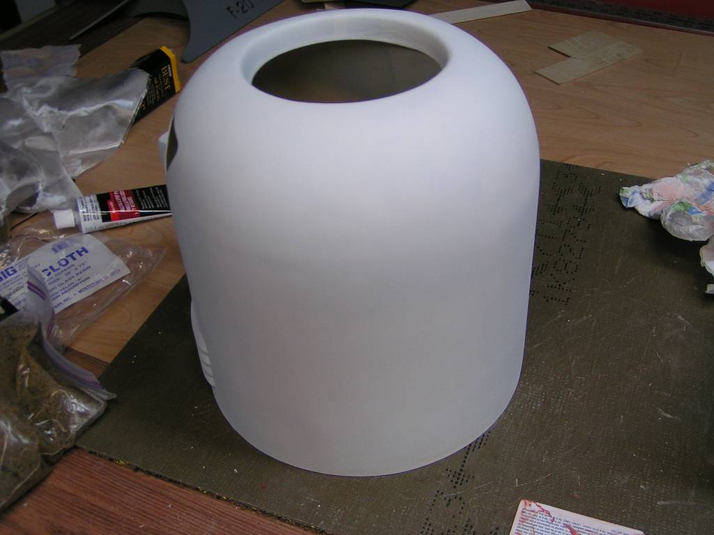

Did any of the filling I could see with the BondoGlazing spot putty, sanded it down and got some primer on.. I will wet sand this down tonight and hit any spots that I missed and give it another coat of primer... Very happy how it's coming out, I will have a good surface for my paint job now. The flat spot on top isgone andthe rest of the seams are blended in and no more cracks.All my holes are already cut out so i don't have to worry about chipping any paint while cutting it, should be able to give it some paint by the weekend..

Wet sanded the first coats down, had a few spots that were questionable so I decided to give it another coat and see what the primer takes out before doing any more spot putty.. Going to let this coat dry over night before messing with it, it's coming out pretty clean.. Few spots that i will have to fill before the final primer coat goes on..
Jimbo
Jimbo

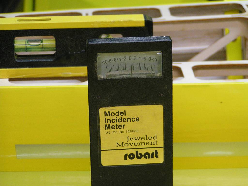

While primer is drying I figured it's a good time to move to other things...
They did something right on this plane!!!!!!!!!!!!

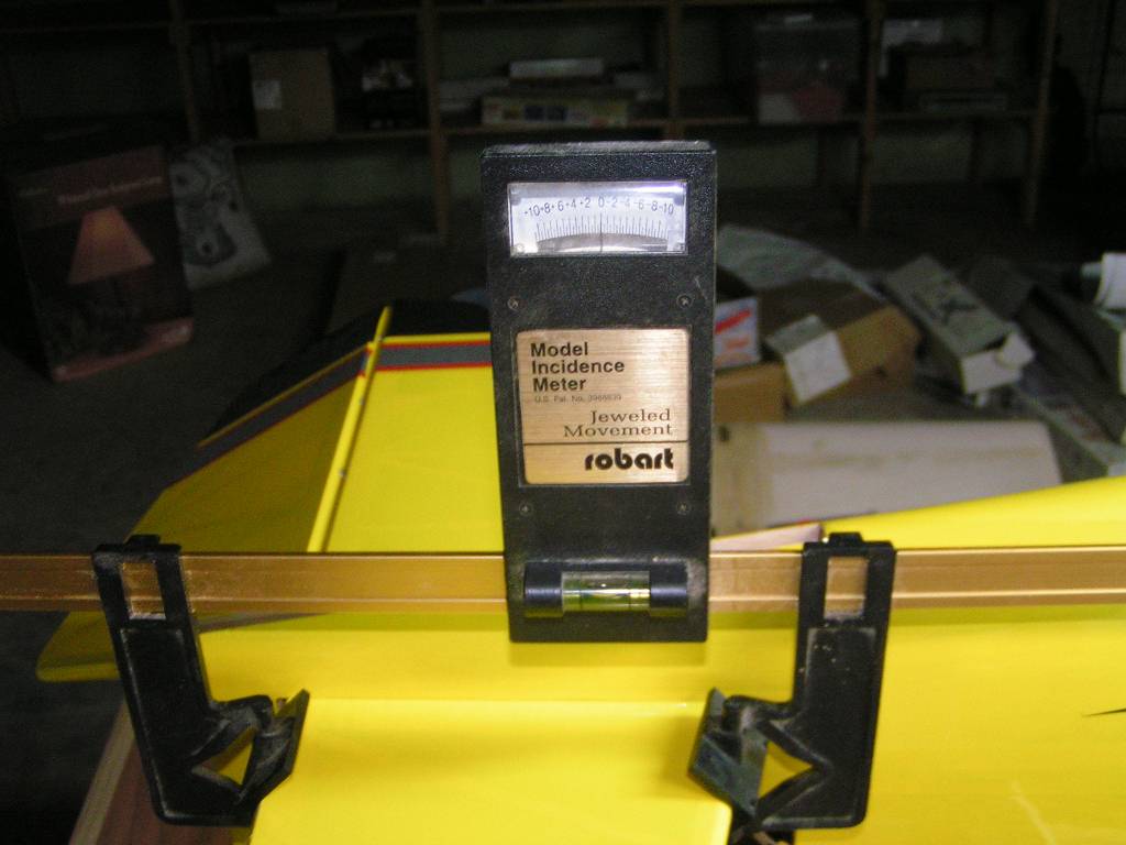

I squared up the stab to the fuse with a "T" pin and string, then leveled the fuse and put the incidence meter on the stab. Bingo, the stab was at "0", had a little smile on my face.. So I put on the bottom wings and checked them to the stab and was shocked that they were right on the money, bigger smile! I re leveled the fuse checked the stab and it was still right at "0", so I put the meter on the wing.. It is so close to "0" I'm not messing with it, best I can tell it was at .25 of a degree, if that... More then satisfied with those numbers, going to glue the stab and fin in later tonight after football practice and get some servos mounted in the tail...
Jimbo
Jimbo
#123
Swing and a miss, took the last measurement and the stab was off at the tips to the bench.. Seems that the stab is warped, I got some bags on it laying flat over night and will try to iron thecovering on the opposite side. But even if that works, I am sure it would come back... It does get flying wires, so I can use those to get it out, I guess...
Any thoughts on this......
Jimbo
Jimbo
