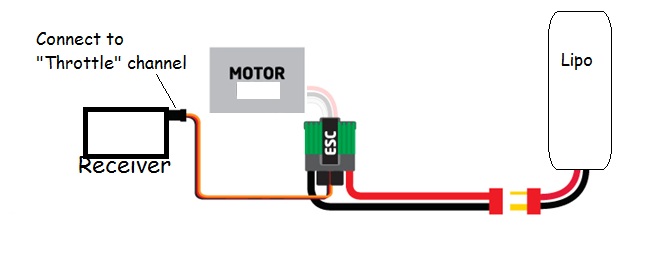

Hoping I can get some help. I am building a Zero from Tiger USA for an elderly veteran frind of mine. It's suppose to be ATF but is far from "almost"! My problem is the electric motoer that cam with the plane doesn't have a plug on the end. The manual "recommends ACE radio, esc and servos but 1. I can't find them and 2. my friend aready has a spektrum 6ch radio. Any body know anything about this kit and how to set up the motor and how do I get it to work with the Spektrum equipment, if that's even possible? This kit has me thinking it might be better to just have it for a static display and get a dirrerent Zero.
Would that be a Thunder Tiger Zero?
Does the motor have (2) attachment points for wires or does it have (3)?
Most of the newer stuff will work with the Spectrum radio without a problem.
Can you post pictures and some spec's on it. Size, weight, and so on?

Yes, it's a thunder tiger. The motor is an OBL 2928/09. It has 3 wires comming out, red, black and I think green or grey. The kit is over at my friends right now so I don't have any pictures. All the manual gives is a wiring diagram, and it doesnt even color code the wires so you can see which one goes where. Here is the link to the web site, http://www.thundertiger.com/products...0Tiger__2.html.

All 3 wire motors can be hooked to any of the 3 connectors on the esc. If you power the motor up. If it is rotating the wrong way. Change any one wire and the motor will reverse direction. Wiring from motor to esc can hook up in any combination. Don't know if this helps. I am not a Guru by any means BUT, I fly only electric aircraft and have been flying electric since Nicad's.lol

Your first electric can be confusing (it happens a lot). The three wires from the motor go to an ESC (I would suggest one rated for 15 amps). The ESC will have 3 wires on one end and 2 wires on the other, plus a servo lead that goes to the throttle position on your receiver. The 3 wires from the ESC go to the motor. The 2 remaining wires on the ESC go to the battery (red to red & black to black).
CAUTION!! The motor may start turning as soon as the battery is connected to the ESC.
If the motor starts as soon as the battery is connected, reverse the throttle on your transmitter.
If the motor is turning backwards, switch any two motor leads (it doesn't matter which two).
The easiest thing to do would be to get help from an electric flyer or your local hobby shop. It's much simpler to see all this than to explain it.

Power up your Transmitter first. With the transmitter powered up, then connect the battery to your Electronic Speed Controller.
Then fly, work on the setup, etc.
Then, disconnect the battery from the ESC.
Finally, turn off the transmitter. Always in that order.
Never allow battery power to reach the ESC before the transmitter is turned on. Always disconnect the battery from the ESC before you turn your transmitter off.
People who deviate from that sequence often get bitten.
