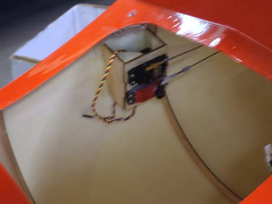

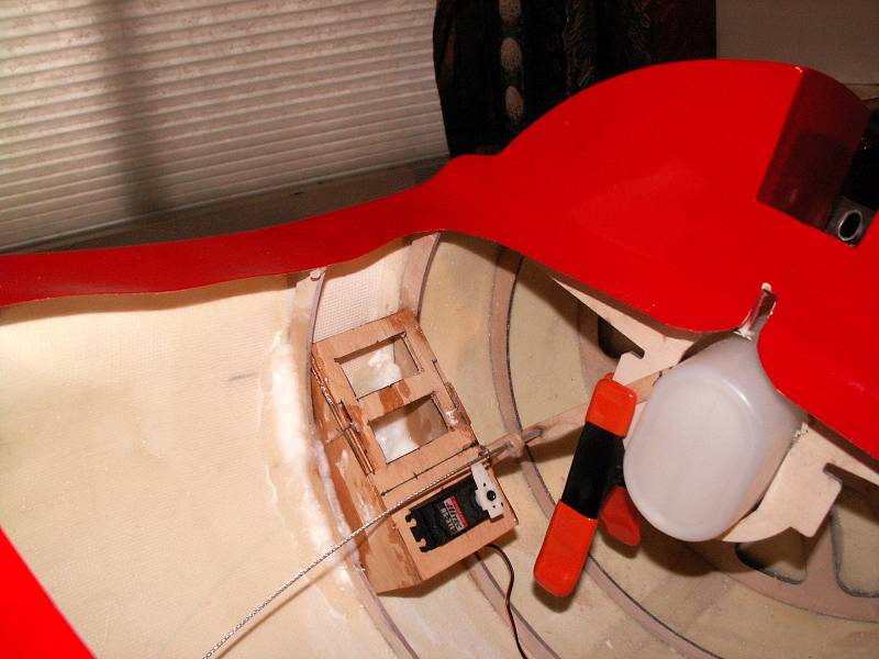

Decided to not mount throttle to firewall, as I am not keen on letting the servo pickup unecessary oil, dirt and grime, even though the servo is a relatively unexpensive Hitec 311. You will see in following photos that I recut anothter servo tray to accommodate three servos instead on two. The bottom tray cut-out will house the throttle servo. I am using Dbro flex cable, which is routed through two popsickle sticks for support. The white glue looking material joining the former and fiber-glass fuse is CA soaked Arm & Hammer baking soda. I found that it make a good filler for joining fiber-glass and wood.
[img][/img][img][/img]

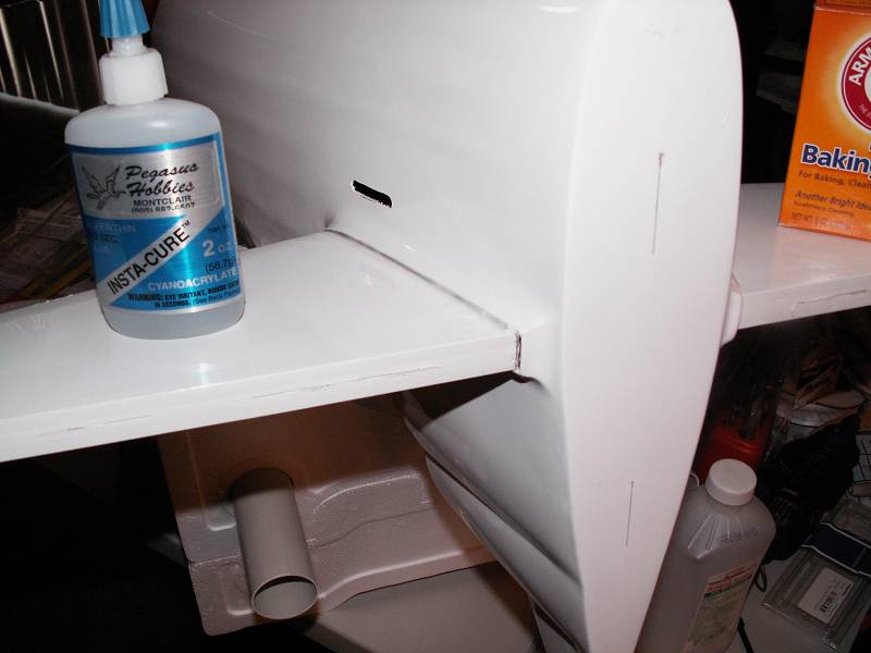

Glued in stab today. Thought I would post picts just before going off to work. Did have small gap at bottom of stab. I used baking soda and CA to fill after letting 6 minute epoxy set up.

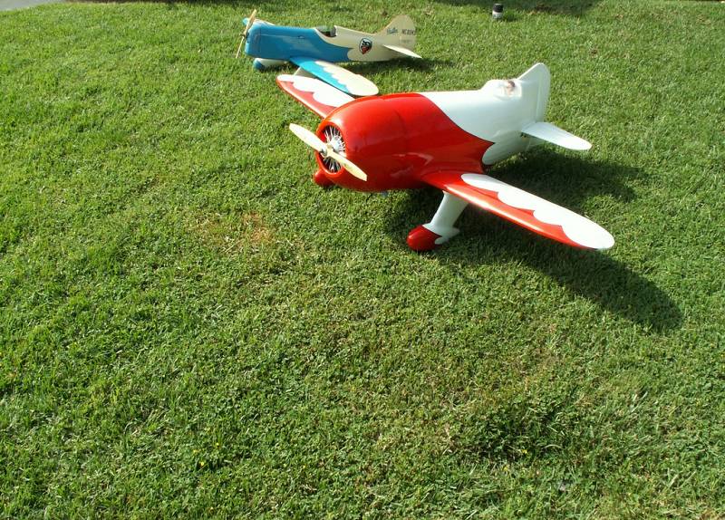

oops!
should have said----dead stick landings--keep nose down till untill almost on runway!
i donot have gee bee in hand yet so i donot know if it has built in wash out at tips.
if not---it is suposed to be covered with monokote wich will allow twisting washout into wing and reshrinking covering(if wing is not ridged as 2x4)if no supplied flying wires i will also adjust these to hold some washout in wing.

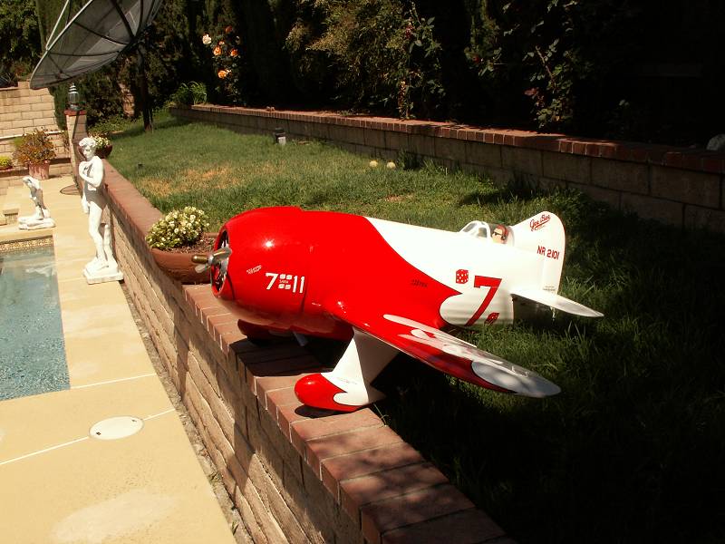

finaly got pic of my big toy loaded!
will try to load model pics soon!
David
