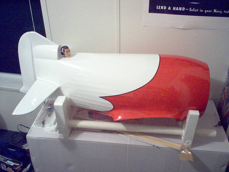

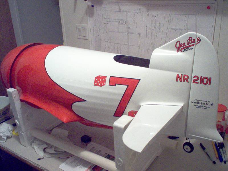

more pics from today. I painted the cockpit black....makes the pilot stand out more. Making the belly pan fit was not fun. I had to trim the back of the pan a bit, and a lot of sanding to make it fit properly, also, they didn't put wedge blocks for the blind nuts in the fuse, so you have to drill out the holes in the wing at an angle to get the wing bolts to line up. I thought that was pretty poor. It's a chinese production line slap together. I hope the flight performance is better than the kit quality.

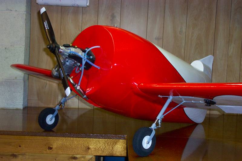

GP GEE BEE w/Robarts OS FS120 non-pump...
It's a nice, pretty plane and I had one about a year back. I had a few flights on it but our field has this rather annoying crosswinds 70% of the time. It's not impossible to land it under these conditions but it isn't all that easy because the Gee Bee has a strong tendency to turn it's nose into the direction of the wind. A bit of rudder/airleron work during landings can fix that up to a certain point but doing that brings the Gee Bee closer to the point of stalling.
I strongly suggest owners of these Gee Bee's to fly it at a nice field, preferably an asphalt strip with stable winds.
Taxiing, taking off and landing in crosswinds I strongly object.
There was this one time I was taxiing around to take off and a strong crosswind turned the Gee Bee towards the side where another plane was and POP POP POP... There went his rudder, victim to the 120's 15 x 8 prop. The rudder on the Gee Bee is quite ineffective at slow, taxiing speeds.
Overall, once you get it into the air it's rather easy going. You'll find that you lose those maiden jitters rather quickly as soon as it's up in the air. It's the landings. Come in too slow, you'll stall and it'll litterally drop, come in too fast, you'll bounce it right back up into the air. It's really weird...
It doesn't want to slow down either. I had to drag it in at about a quarter throttle 5 feet from the ground then just let it slow to land itself as I reduced to an 1/8 to idle.
It's fun but and challenging and fast.

I'm not very familiar with gas engines but to give you a better perspective, the OS 1.20(non pump) was actually ok. It didn't have insane vertical power but it was plenty enough to do what it was supposed to, fly scale and do pretty much everything.
If I were to get another one, I would definately go with the YS 1.10 for the light weight and power.
The thing you need to watch out with these Gee Bee's is the weight. I understand there's quite a significant weight increase with gas.
I think that's the only thing you need to watch out for.
I kept mine under 5 kgs, about 11 pounds.
