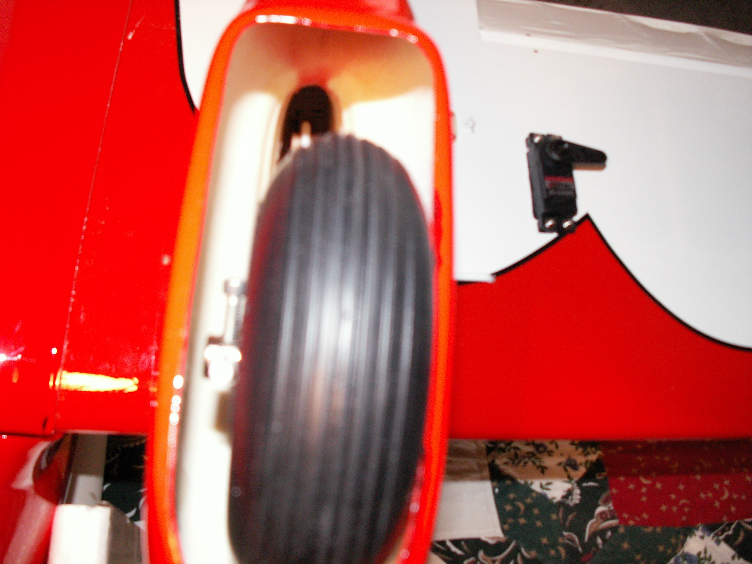

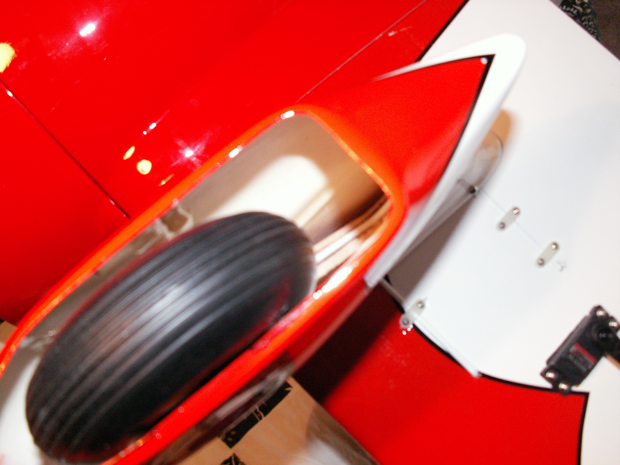

Henry Haffke designed a Gee Bee for Coverite (The Model D) in which the landing gear is the same as the GP. Henry added a 3/8 or 1/2 inch balsa triangle piece between the front and rear halves of the gear on each side. I simply duplicated this for my GP Gee Bee and it has added a tremendous amount of strength to the gear....see attached photo.

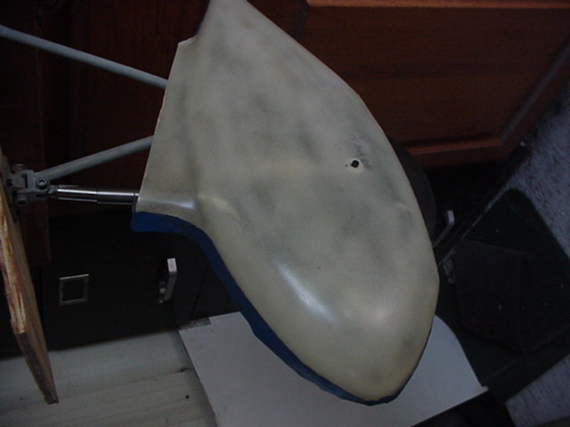

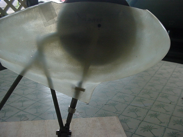

Hi guys. Do any of you have the Haffke 71" plan? I'm building a gear, including pants, for a customer who says he can't find the flying wire attachment points on the bottom of the wing. I need the distance from the centerline if the strut out to that attachment point, so I can calculate the proper size and location of the entry slots in the wheel pants. I'll attach several pics of a partially completed gear. Thanks for any help I can get! Does anybody know Haffkes email address? Lee Robinson W. Palm Beach, FL.
