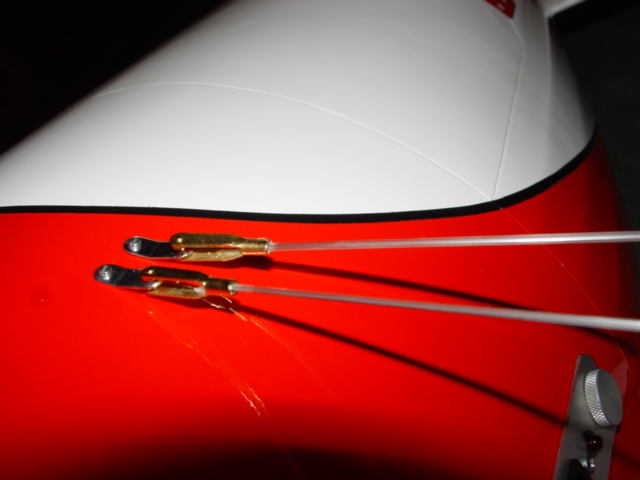

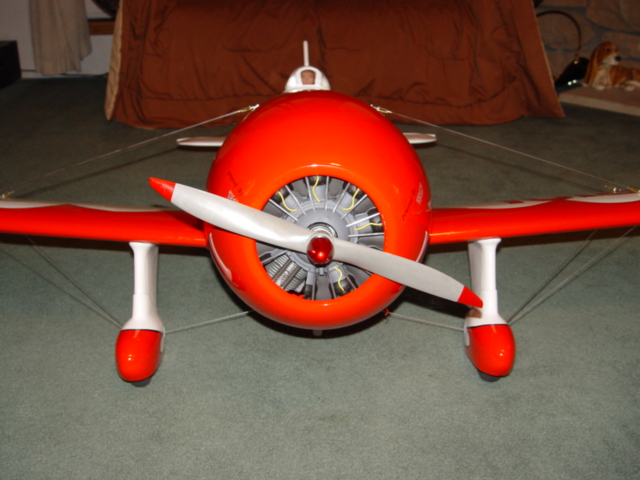

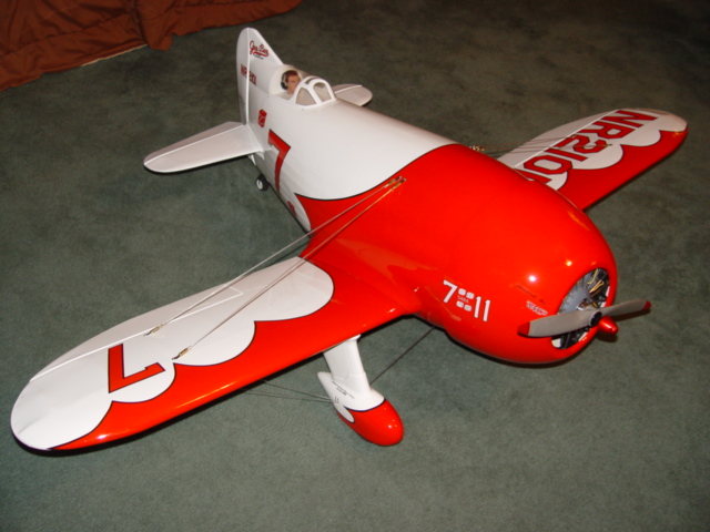

Anyway here are some pics of my gee bee, WOW the shoestring (I WANT ONE UUUHHGG). I love the old planes myself. I wish I could find a Spirit of St louis ARF. I probably will not have the Extra done till the end of summer. I like Saito as much if not more then OS but $$ more then OS, Also I have never had trouble with OS or saito (saito better looking by far) I like to fly my 60 size U-CAN-DO, This plane is riot. You can actually relax when it's in the air LOL. I am using an OS 91 4 stroke in this bird. It has been a good plane, I also have the 46 size U-CAN-do with a 70 4 stroke. My electric is a E-flite Mini Ultra Stick. Also a nice throw in the car and go plane, But boy are lipos expensives (80 bucks a pop ouch). I would love to get back in the hobby the way I was 15 years ago but no time and kinda stretchin the $$$. I spend alot of time on the sim GP G4. I have a question I live in Monroe MI. Where are you from if you do not mind me asking - STeve

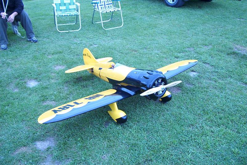

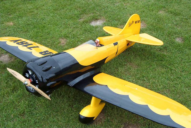

how about these,,,

Hi Wasp. Well I have some bad news for you. The president said I can clame your gee bee in the name of the united states of america - (don't worry I'll give her a good home) LOL
Anyway beutiful BEE, I beleive it is a Z ?? - Steve

it'a model Y

Wow, you did a great job on your plane! If you have time, I'd like to know where you got some of the hardware. It looks great! I live in Boulder County, Colorado. It's supposed to be 70° tomorrow and snow on Sunday here! (flying on Saturday, building on Sunday)

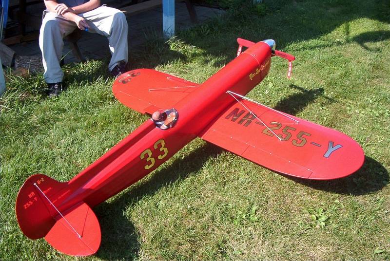

Here are a couple of the Shoestring...

Wow The shoe string looks so awsome. Anyway let me know what hardware you are interested in. The flying wires are flat plastic laceing that you buy at a craft shop (chrome colored) and the attachments are sullivan 4-40 clevises with dubro steel landing gear straps. 70 on saturday, I think in michigan it will be 20 and snow (UUUHHGGG) I hate it here LOL. I will send some more pics to you. Anyway enloy flying this weekend and let me know how it goes - Steve

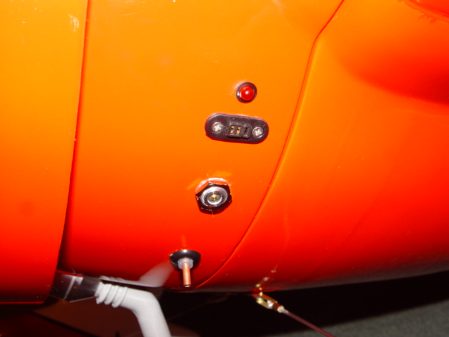

Anyway, do you have an on board glo? It looks like one of those lights might be a battery charge indicator? I'd like to try both of those. I was going to try to do that on the Monocoupe, but just got to anxious to fly it. I don't have any pictures of it flying but a few building pics at

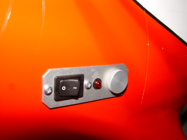

Yeh I saw the pics- (can I have the engine ??) Yes the onboard glow is a Mcdaniel single cylander. I have set to come on and off at the flip of a switch, Also works great to keep low idle by leaving it on. It is good for almost 2 solid hours of continous use. I purchased it at horizan hobby for around 60 bucks. They work well. The led comes on to indicate the plug is hot and goes off when it is out, the hole unit including the 5000 Mah NiMh battery weighs 3.7 ounces. It is all in a rather tiny unit also. But in the Gee Bee there is enough room to put furniture inside LOL. The switch unit is a ELEKTROTEC super rocker, the LED blinks continuoisly to let you know your system is on. You can purchase the switch with or with out this option, including the alluminium plate and barrel charge receptacle it is aroun 35 bucks, but I figure hey the switch that controls the heartbeat of your aircraft better be good (check out MADISON COMPONETS). I love that twin Saito in the mono coupe. Is that the stock carb ? or did you have it made. I know the OS twins only have a single barrel carb. Here is a G4 simm pic of a gee bee I fly. Steve

I love the look of your switch harness, what is it? And what glow extension is that? Thanks.

Hey revgo, The switch harness is a elektrotek with a super rocker switch and barrel charge adapter with the cap. The LED blinks to let you know your reciever is on and you can purchase the switch with or without the LED (all comp[onents available through MADISON COMPONENTS) the glow driver is a Mcdaniel with a built in Battery. What you see on the side of the plane is the LED - again shows the plug is hot when lit. It can be controled by a switch on your TX in a number of various ways. The other small black receptacle is a deans micro charge plug. (all included with the unit) but can be baught seperatly. I love the set up it works great. - Steve

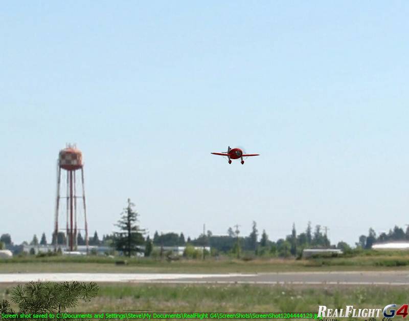

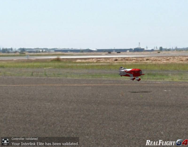

I have faith in you oh great ohbee whan of older race planes LOL. Anyway here are some other sim pics of the R2. MAN those struts look so cool. With the regular wire I know I had to dremel the channel and the 90 degree bend (had to round the edge a little for a flush fit. I am about to order a pair myself, they look like they will do a great job and look great to. Keep me informed - Steve
