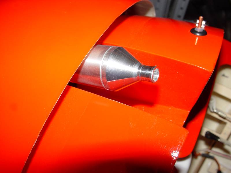

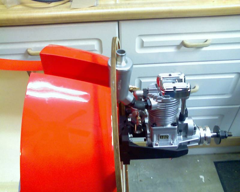

Quick question... I'm thinking of cutting the wood ring for the cowl and just trimming the fiberglass to accommodate the muffler on the Saito? I don't think it would hurt it that much, and maybe add a little added air flow. It looks like I would need to cut about 2 1/2" off the back side to get around the muffler. I really wish there were more options for fitting mufflers or extensions. I tried the "flexible tube" on my Spacewalker / saito 120 and it sounded aweful! (65 Impala with exhaust leak and missing muffler)
Thanks!
dc

I have the muffler of my Saito 180 tucked in the trough like in post 378, except without the rubber exhaust extension and that has worked fine for me. I also had to grind a hole in the firewall so the pressure nipple wouldn't rub. I haven't seen anybody do what you are proposing. If you go ahead with that, I'd probably reinforce the cut-out in the fiberglass with some plywood backing to prevent flexing and cracking around the muffler.

Hi Devcos, Well I love my bee. On my OS 120 with pump I had to rotate the motor about 4 degrees and install a dubro rubber extension the pipe fits perfect. Anyway I would hold off and look for a machine shop in your area or a freind who could bend the pipe a little to get a correct fit. Although the way it looks it would be coming out the bottom and not take away from looks or structural integridy, WOW wait till you get this baby in the air. I can't get fly enough. It's the first plane in a long time that I don't get tired of flying. - look forward to some final pics - [size=2]OH how do you like all the U-CAN-DOS HE HE - Steve
