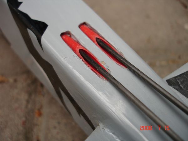

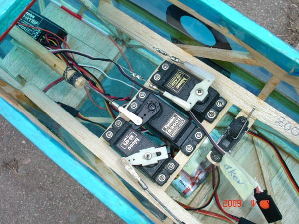

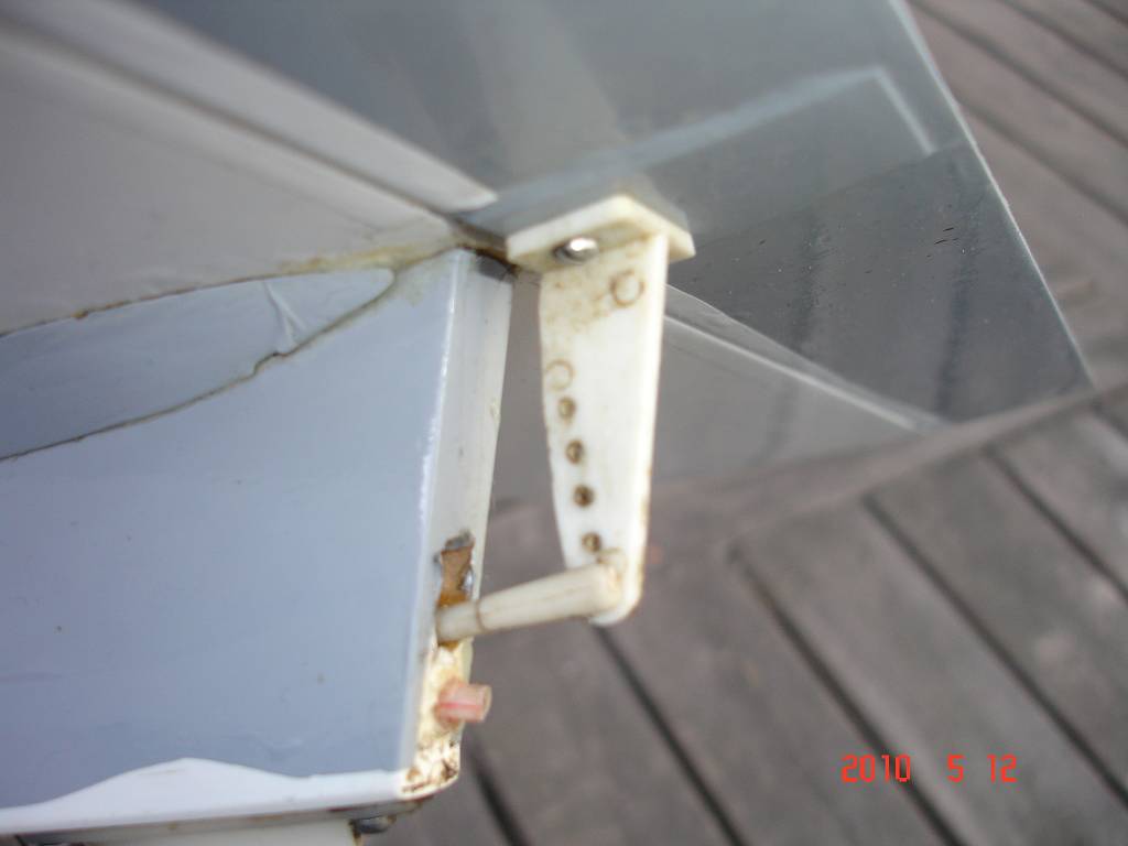

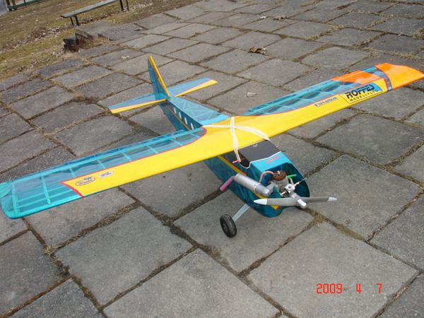

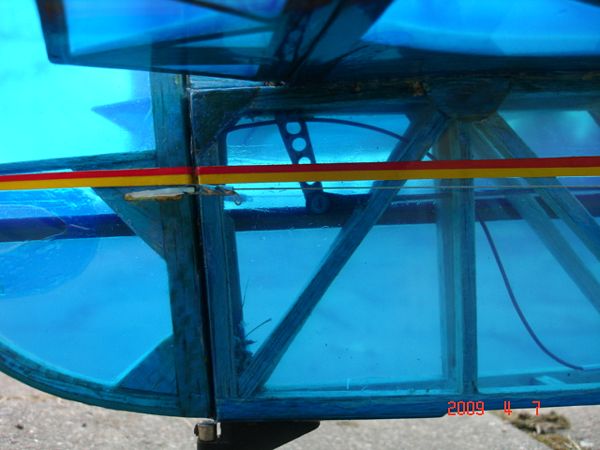

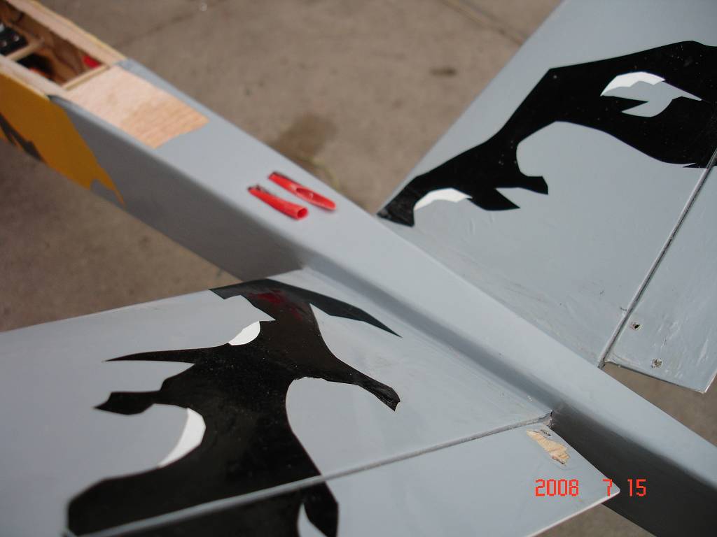

Hi!
Never uses the stuff!

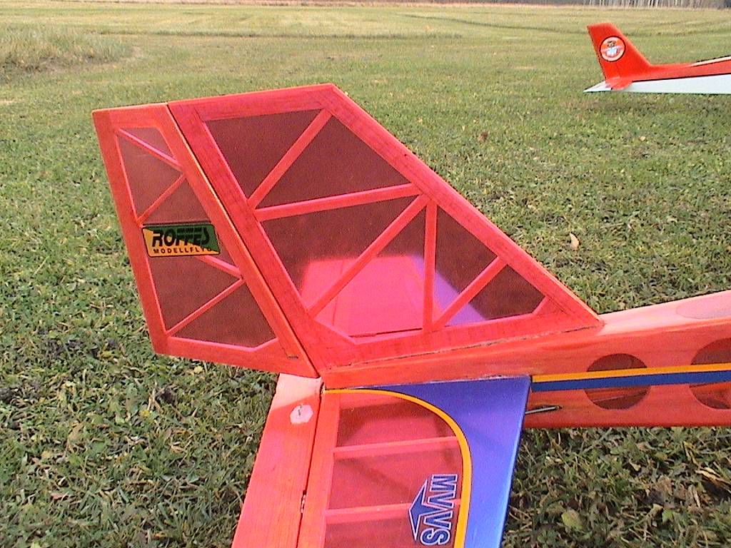

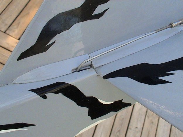

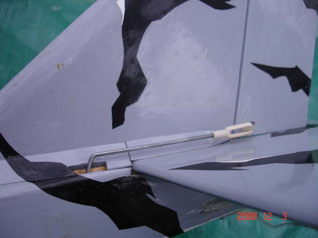

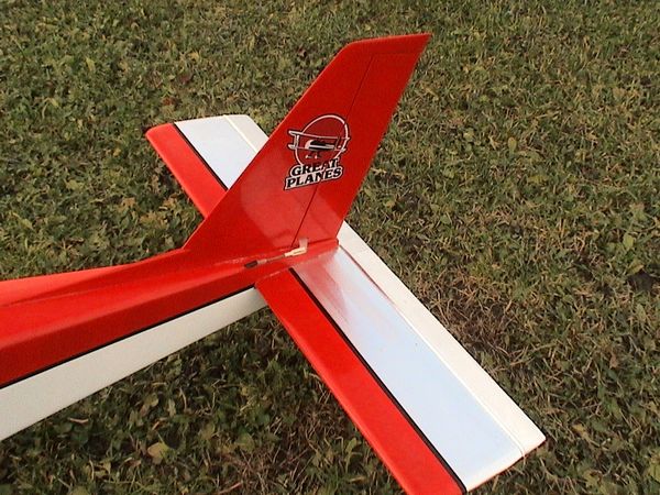

Just cover the plane with plastic film (Oracover is best) and take up what ever holes you like.

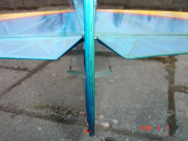

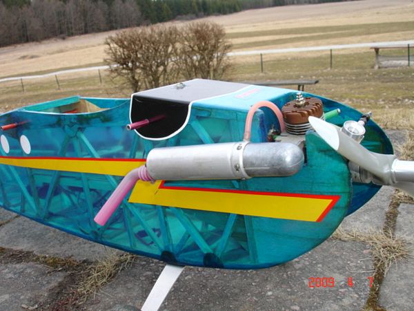

Using internal set-up linkages is much neater (Pull-Pull , fishing steel vires) as in the blue trainer below, where I have fishing wires on the side rudder and a balsa pushrod to the elevator.
