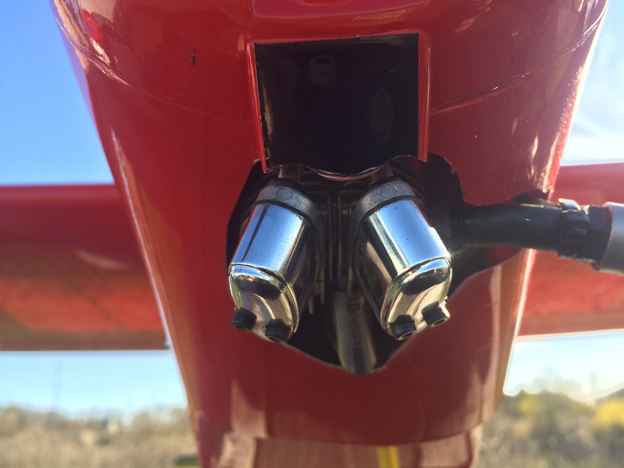

The FG-11 is based on the 60 sized saito, so the 72 should have a bit more power and fly it quite well. , I used a dremel with a diamond wheel cutter, and drum sander to open the cowl. I haven't had any cooling issues so far, but I baffled the cowl too, so make sure you baffle it too. Just keep in mind the exit needs to be much larger than the entrance for airflow, so if inverted, open it up a lot behind the head and you should be good.

so your FG-11 fits fully inside the cowl and all you have to do is baffle it??? or did you baffle it along the sides and cut the bottom to clear the head? The FA-72 will require cutting a large chunk out of the bottom of the cowl (engine mounted inverted) the head will be visible below the cowl, should be a nice install though. Can you post a pic of yours?

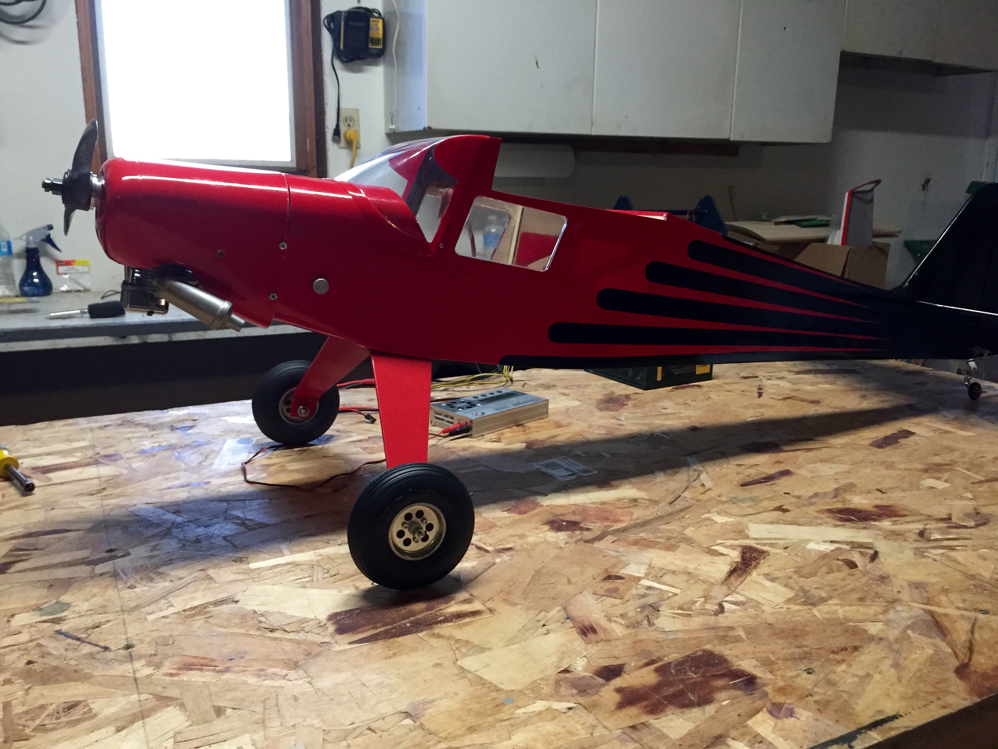

Got the FA-72 mounted...LOVE the look and sound. Got it to balance w/o adding weight by putting the battery 1/2 way to the rudder. Had to enlist my son's smaller arms... Flew it for a minute the other night but it was too windy..I know, I should have waited. Can't wait for the wind to die down next week so I can see how this thing really flies.

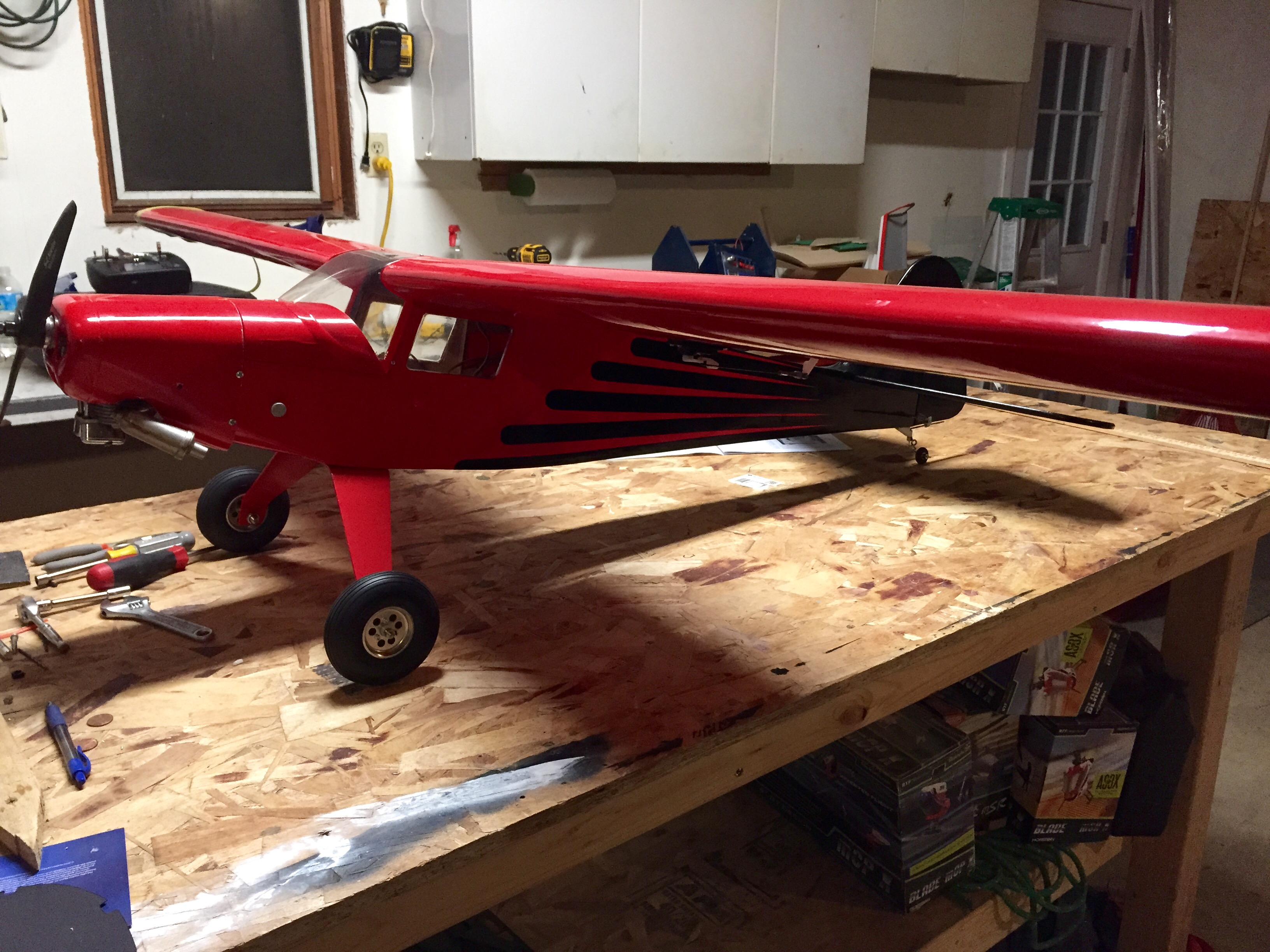

I'm not a fan of wheel pants, so they had to go...it's just my preference. 4" Sullivan aluminum wheels...Much better!
Name:	Tclips Wheels.jpg

Awesome. Thats the same thing I did to balance mine, except I cut out the bottom covering so I could glue in a mount to strap the pack to. I got some H9 covering to match and then sealed the opening. My FG-11, though smaller, once the module is added probably weighs in the same as your FA-72, so perfect match. What prop are you running? I put an APC on mine, but dont remember the diameter or pitch. Can't wait until June to see how many show up at the fly in.

I'm running a Master Airscrew S-2 in 14x6...Lots of torque but not too much speed. The plane doesn't need speed. Here's a pic with the wing on and the new wheels. I think they're a nice fit.
