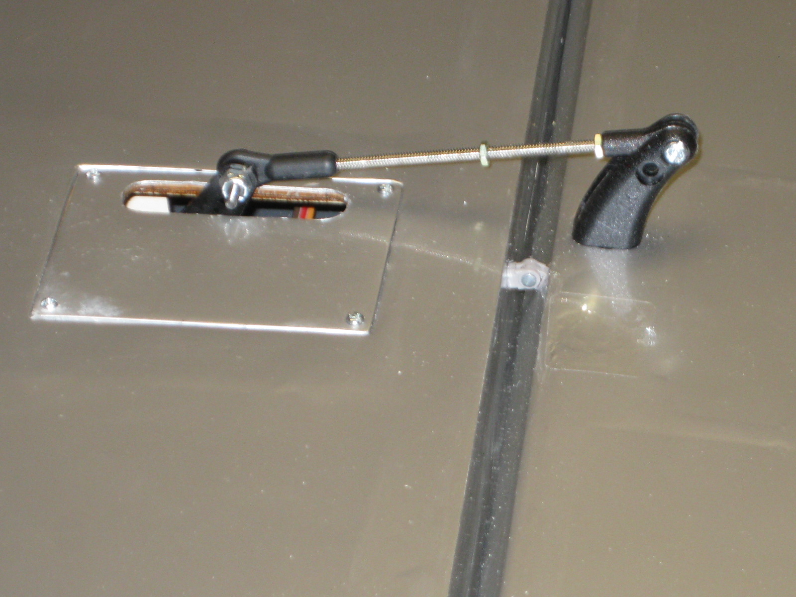

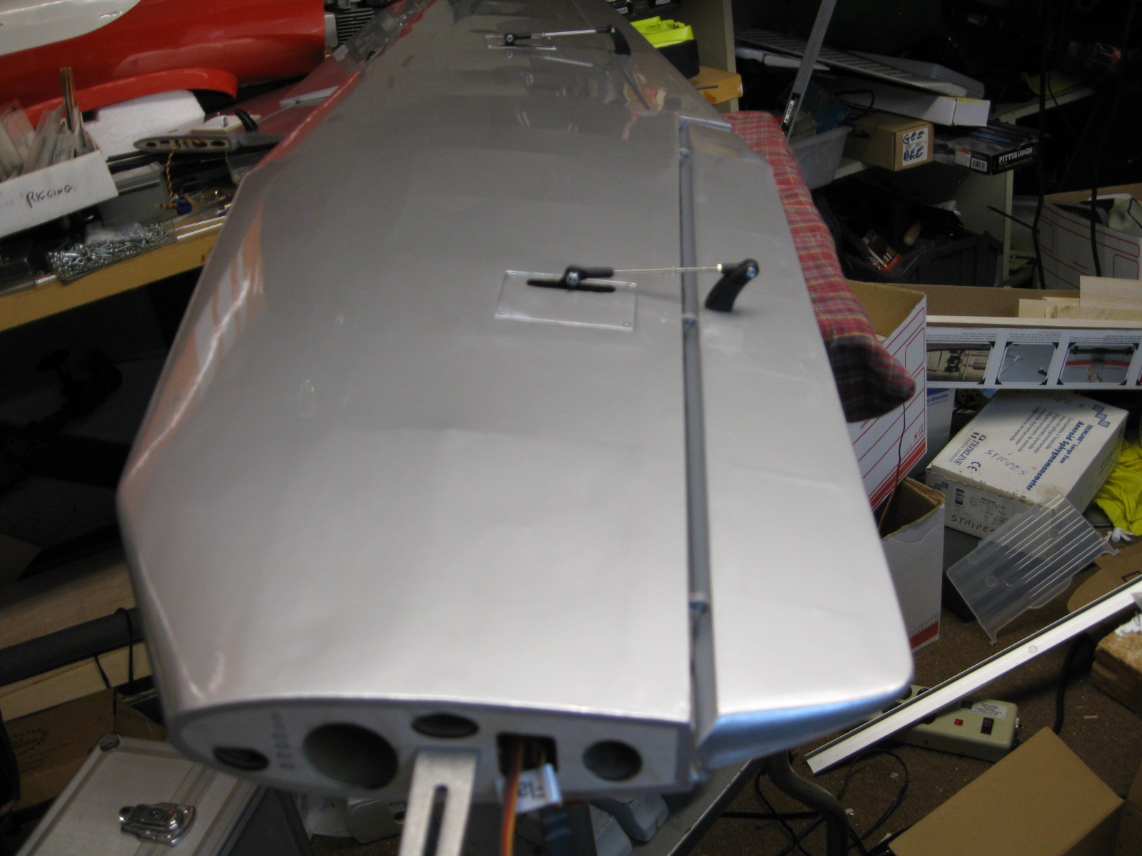

Mine is definitely nose heavy with the G-62 engine. Useful tail weight mods are stabilizer-mounted elevator servos using the surface-mount servo holders from Hobby Express. I epoxied a 1/8" plywood spacer for servo clearance to the stab. This also gives the mounting screws something solid to bite into. This mod will also make removing the stab/elevator halves easy for transport.

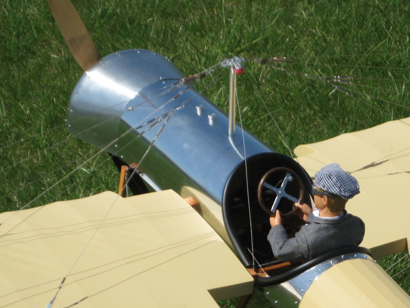

I got my 1/4 scale old-timer pilot from Premier Pilots.net, an open cockpit 1912 Blackburn wouldn't look right without someone hanging out of it: 1/4 Vintage Pilots
Looks like their RAF pilot is on sale!!! 1/4 Scale RAF Pilot
I'll have to get one.

Here's a couple of photos of my Blackburn pilot in his office.
