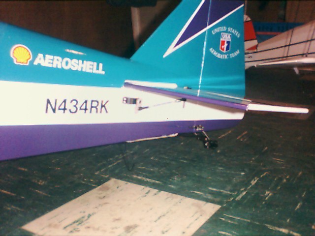

Default Servos in the tail
My Ultimate has two mini digital JR 3421 mounted in the tail.
With a Y.S. 120 in the nose I had to add about 4 oz in the front.
No one likes to add weight but the ease of installation and the confidence of the those two servos in the tail out weigh the 4 o.z.. The plane flys great and is truly the best plane, of that size, on the market.

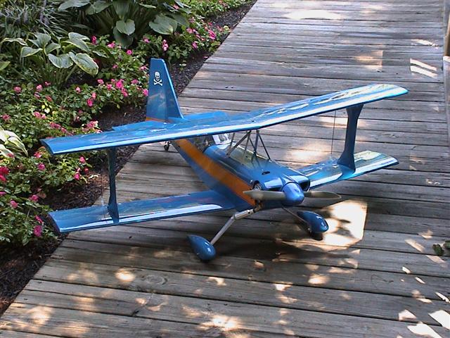

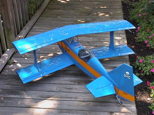

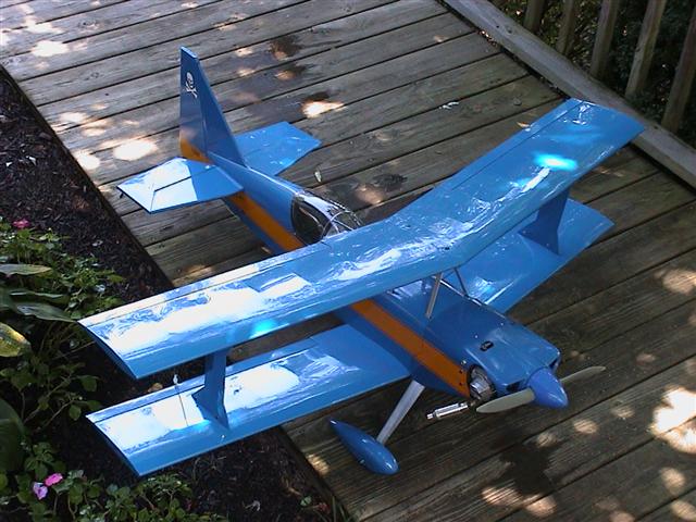

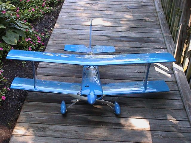

Default cgult
here is a pic of mine with a OS 120 surpass3...going to test fly today. i will be changing out the elevator setup also. i did put pull/pull on the rudder. -Tinman-

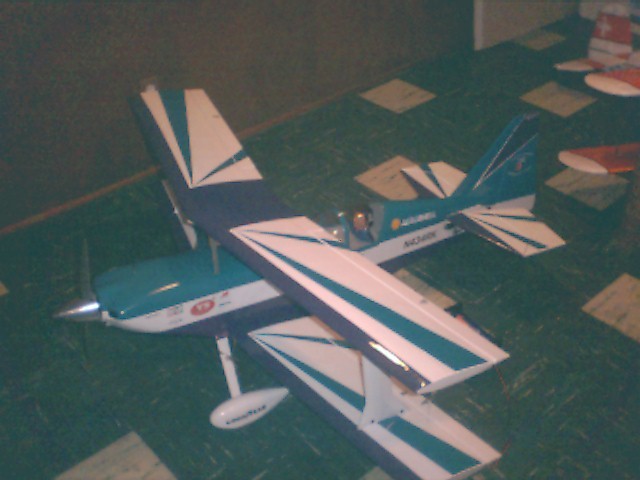

Default Heres mine
Ive been flying this all summer.
Y.S. 120
It's a great little plane.
