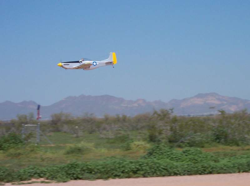

I really enjoy mine! Irvine .53 mounted sideways w/ APC 11x7 prop. Only ways 5lb 3oz, and goes like crazy!! BTW - the gear is now made from bigger wire. Holds up fine on our irt strip out here in the desert.

Excellent ! I should be a bullet with a Satio 100.
