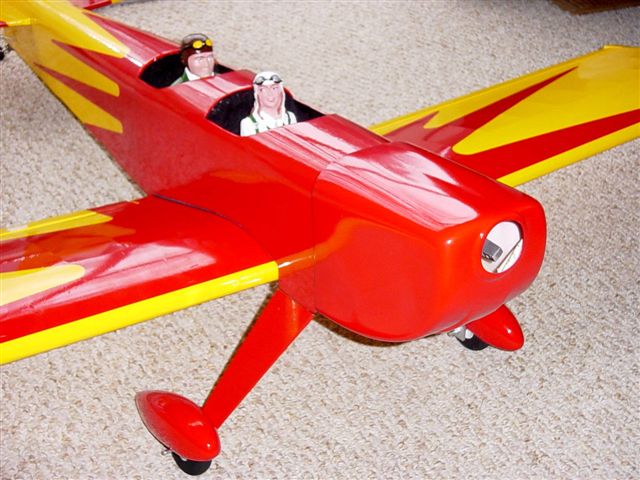

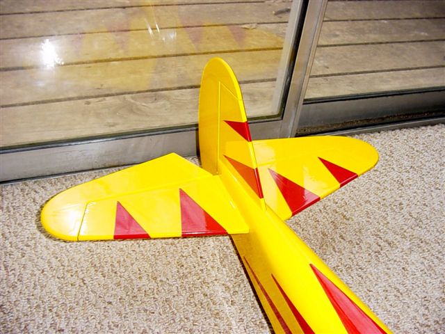

Here are some pic's of the plane although the engine and cowling has not been installed. Also, the wheel pants need to be completed and installed.
Anyway, hope you enjoy them and I will send more when it's complete.
John

Would you have any suggestions on how to route and attach the Receiver antenna to the Vertical Stab. I have seen a few other A/C and they have used a T-pin for securing it to the stab but I was wondering if you had any other ideas.
John

John,
Looks like it's taking shape pretty good. Nice job.
I ran the wire out through the fuselage and attached it to the vertical stab with a "T" pin and a #32 rubber band. I don't tie the antenna with a knot. Loop the band around the wire and attach the band to the pin. Works for me. Put a piece of heat shrink tubing on the wire where it exits the fuselage.
