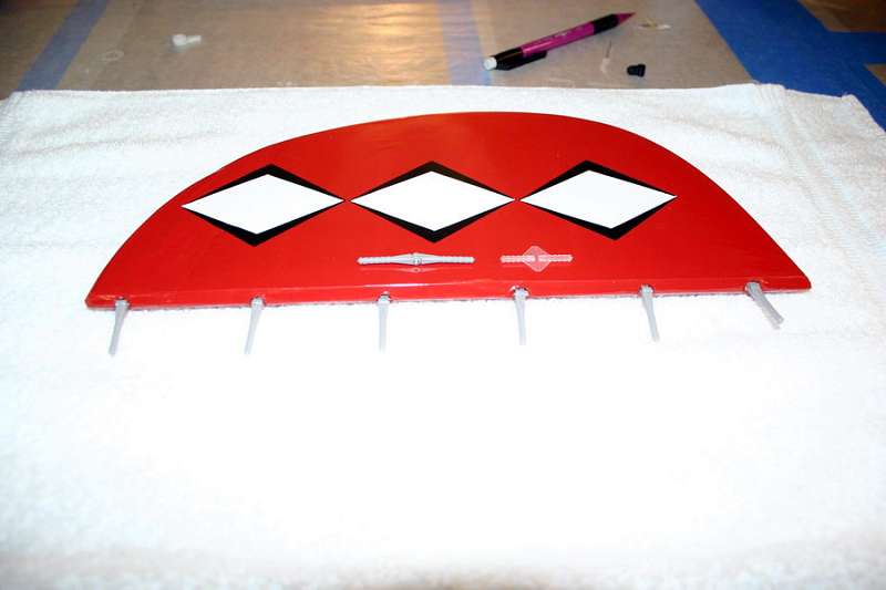

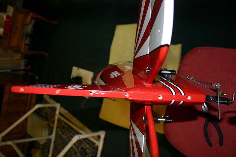

David, that Cyclone is great, I want one. Let us know if it handles as good as it looks. Yes, it is all JR, 8103-TX, R945 PCM-RX, standard on throttle, DS 811s on Ail. and elv. and DS8231 on rudder, or is it 8321? If the engine fails it can flap back to the field. I'm heading out right now. No rain, no wind, but the sun never made it.
Matt, the mod was very simple. All pieces are glued on before the extra is cut off. Fool proof.
I'm off to test this new rudder out. Later, Joe

Just got back and am pleased to announce that one of the two problems is gone and the other is less. After removing 3 inches or 19 sq. in. from the top it dosn't drop the opposite wing when rudder is applied. Still dives to the wheels, but not as much. That part is now manageable with elevator. Will be doing another mod for a test before I make a new rudder. It now seems that more could be removed from the upper back edge of the rudder. Ultimately, with a new rudder I will be increasing the area below the thrust line while keeping roughly 65 sq. in. of total volume. On the way it dives to the wheels, in level flight, when rudder is applied, its almost as though its stalling the plane, therefore the nose over, but in knife edge, if it was stalling the plane then it would just drop out completely. That still needs investigation and hopefully the next trim job will effect that part enough to see if I'm going in the right direction. It was cold and gray and not a good sky for looking at a plane with so much blue on it, but no wind or rain. Got a few pics, no big deal, small turnout tonight. There is a Kyosho pitts, what a handful that thing is. And there is one of those hardware store electric foamies. They are cool, but they really don't fly, they just get pulled around by the prop. Throttle back and it drops like a leaf. Later, Joe

Matt, if you could, wait for the next test results before settling on this mod. This is just stage one. Joe

Matt, the first mod of this type took place in early 2003, which started the gears turning. The latest one was by Contempo, with great results. Actually his is taller than my current mod but he extended the width of the bottom of the rudder as well as eliminating how the bottom edge angles upward, requireing a new taller tailwheel assembly. Again, my next move is to remove some area from the upper trailing edge, which will create an angled appearance as opposed to the barn door shape which it now has. Joe

I like the idea of extending the rudder area below the fuse. It will give the plane a look similar to Somenzini's old Hovering Cobra profile. Will you use a stock tail gear set-up?

Matt, seeing as I have so many of them still attached to the tails hanging on my..........WALL OF SHAME............its possible. I do like the gear that you are useing. My only concern is that yours already elevate the tail and with adding an inch, do you think it would be too much? As far as extending the rudder down more, right now the indicators show, that is where the rudder needs more volume. Joe
