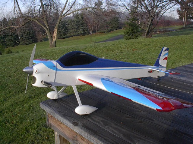

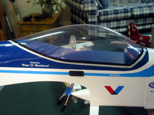

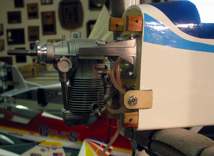

I'm finishing up on mine and also put a 91 Surpass in it. I have the original version of this engine. NITB and just didn't have a model to put it in until I purchased the U-Can-Do. Honestly, I was pretty impressed with the model from the get go. Saw one fly at our field and liked the way it flew. I didn’t buy it to do 3-D, but sure I will experiment with it. Here are a few things I realized when assembling that may help.

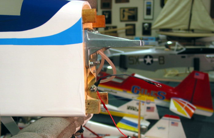

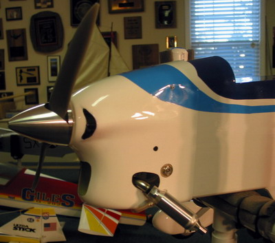

1. I used an OS aluminum engine mount that fit the pre-drilled holes perfectly. This does put the cowling back further. One thing to note here is that the sky blue covering is not lined up well even with the stock mount. If you use the aluminum mount this will be exaggerated in that this pulls the engine back more than the stock mount. I used sky-blue monocoat to fix this in the picture below.
2. I did use the canopy glue and wish I hadn't. Even though it cures clear, it still shows up with a nasty appearance under the canopy against the dark blue covering. Fixed this with 3M pin-striping tape. If I had mine to do over again I would have placed scabs behind the fuse and installed the canopy before mounting the tank or anything else in the fuse. Do this early if you plan to use screws to mount the canopy.

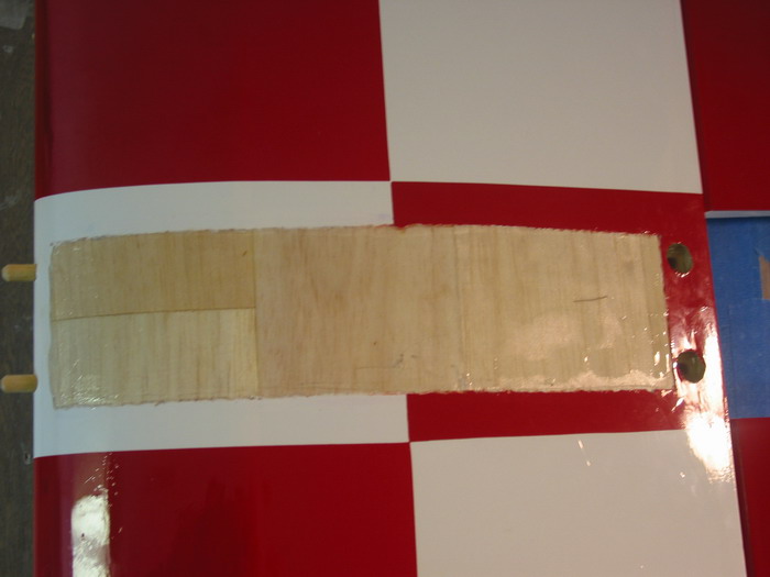

3. I also fiber glassed the wing in the middle on both sides to add strength.
4. The directions say to mount the battery and the Rx under the wing hold down. I mounted mine forward of the wing saddle behind the tank and balanced right 5 7/8" as suggested in the book. I don't see how the guy in the directions can suggest mounting these under the wing hold down. Maybe I read this wrong, but the picture even shows this.
5. Odds and ends - Put a True Turn spinner on to replace the plastic one. Also used a Sullivan 13 oz tank vs. the stock tank. Used solder clevises on 440 rods with threaded Sullivan threaded clevises on the adjustment ends for all control surfaces. Mounted a remote glow and used Slimline rubber wheels - same size. Hitec 475 servos with a 7 channel Futaba PPM Rx. Mixing the elevators on 2 and 7 and the ailerons on 1 and 6.
I'm ready for the maiden flight hopefully tomorrow if the weather is good. Been cold and windy with rain in the forecast for tomorrow, but will see.

I forgot to mention that I also put a fuel valve on that you can see in the pictures above. Below are the wing mods. I covered the top side of the wing over the fiberglass and then attached the belly pan over the fiberglass on the bottom side.

kroflite54 - I did epoxy the stab in place with the bolts as well. I pealed back the covering and then applied epoxy top and bottom. I had a bad experience with the Giles with a wing that sheared. Also many thread comments on wing failures with the Giles. I just always add this step as a mod in any ARF I put together these days. Interesting though, when I pealed the covering back on the wing I had a crack in the balsa right where the fuse would make contact with the wing in the wing saddle. This is why I do this now. Not aware of any history, but didn't want to take the chance. I learned this from 'Geistware' on an RCU thread. I also added thin pieces of tristock to the formers around the wing saddle. The fuse on this airplane, like the Giles, is very narrow in this area. With the long fuse there may be flexing that did happen in the Giles. The Giles has also broken in half at the formers fore and aft of the wing saddle because of this flexing and lack of strength in this area. Just an added precaution I chose to make. Yes, this all adds a bit of weight which I realize you don’t want in an airplane like this, but feel the weight is minimal vs. the added strength. Keep in mind that I still have not done the maiden on mine, but she is ready to go. Using an APC 14X6 prop. I have provided another picture of the remote glow set up from the back side. I used a piece of brass that is tied into the cowling mounting block and also one of the engine mounting bolts. This one will hold.

RFW, Of the 1000 + posts on the UCD this is the first mention of an aluminum engine mount. The supplied mount, aside from offering vibration isolation, also enables you to tap out for the engine mount bolts and drive them right in to the mount struts, resulting in the option of not useing the supplied nuts, realizing a weight savings. Small, but it does add up. With the supplied mount, you can still get the engine back to the firewall. On the canopy the only way to go is with the canopy glue. Unless a pilot is installed, many have just sprayed the inside of the canopy first with paint and the glue is not visible. I tried the screws, what a mistake. Although you did a beautiful job with the pin stripeing. As far as the wing, with a one piece spar its very tough. I have destroyed a fuse with no damage to the wing. On more severe impact the part of the wing that does survive is the center, due to the rib doublers in that area. I have a few. Radio gear placement is always different for balance even though this plane is a production line clone. Out of five of these they were all slightly different. 4/40 rods is surely the way to goe. I used a quick fueler but chose not to go with any more optional conviences for weight reasons. I did do a pull/pull on the rudder. Good luck on your maiden, you will love this plane!

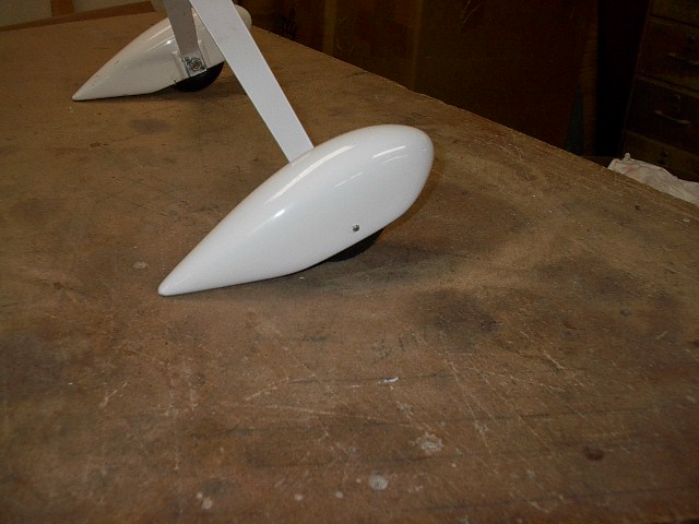

Kroflite, Unlike the forgiving wire landing gear of trainers which kept me in the air long enough to learn, any bolt on gear can get knocked off. The mount block is enginered as a shear block in the event of a rough landing, it will pop off without damaging the fuse too much. This plane lands like a feather and I have found that compared to other aluminum gear, the UCD gear is very forgiving and flexible. I havn't even had to bend one back into shape. ( even when destroying the plane) One tip that really works. Don't shorten the length of the axles. Drill a hole on the outside of the wheel pants inline with the other side and let that last 1/8" of axle stick out. Havn't lost a pant yet. Joe

cumn thru - I saw the post on the mount options. This is just a preference of mine. I really dislike adjustable mounts. Also, the O.S. mount I used allows the engine to actually sit closer back to the firewall than the stock mount. This did cause a problem with the striping alignment to the cowling, but then it was off regardless on mine with either mount.
I agree the gear is not mounted very well. Like you, I learned to land properly with wire gear on a trainer. If you hit the ground hard with this set up the gear will certainly go. From the flights I have seen on this airplane, it appears to land much slower than a trainer. Should be ok unless it's slammed in. As for glassing the wing, well, I'm certain mine won't come apart in the center.
Here again, I personally didn't like the canopy glue though your suggestion to paint the inside is a very good one. I wish I had thought about this idea as well before mounting. Would have saved me 27.00 in pin striping tape since I didn't use a pilot.

Joe, A pictures says a 1000 words. Very Nice job. I like how the canopy finished out. Wish I had painted mine. I noticed you mounted your antenna on the outside. Hm....I didn't. I know there are different schools of thought on this one. I mounted mine inside the fuse. I used an antenna tube and made two 'small' ply formers to add to the wing saddle formers to hold in place. Felt this would also strengthen the fuse in this area. I know, weight! Very small pieces of ply. You seem to have much experience with this plane and those of others. Anyone else do this with bad results? I am just a bit concerned about the antenna running through three servos in the tail. They are very close to the antenna. I have done this many times in larger airplanes with no problem. I did a range check and didn't get any noise, but still thinking about this one.

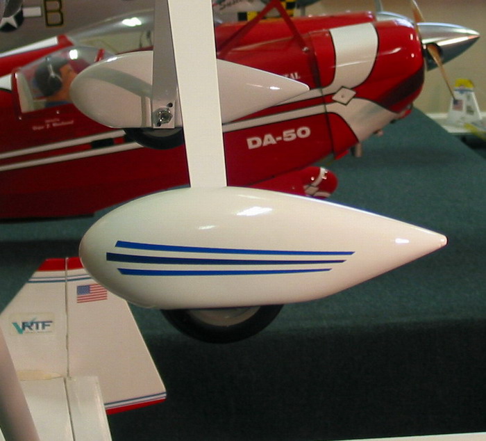

I did cut the axles and used 256 machine socket head screws with small washers and 'Team Associated' minature safety nuts. Very small and probably about the same weight as leaving the axle length as is but you have a clean finish to the wheel pants.

Roger, nice touch with the stripes. Here is a pic from a totally destroyed UCD that went in at about a 30% angle. The main gear was right in the impact zone and look at the pant. Didn't budge. Joe

I have to agree with Roger on the engine mount situation. I got a Jtec mount with pre-drilled holes for the mounting screws. Makes life anlot easier doing an engine install with it.

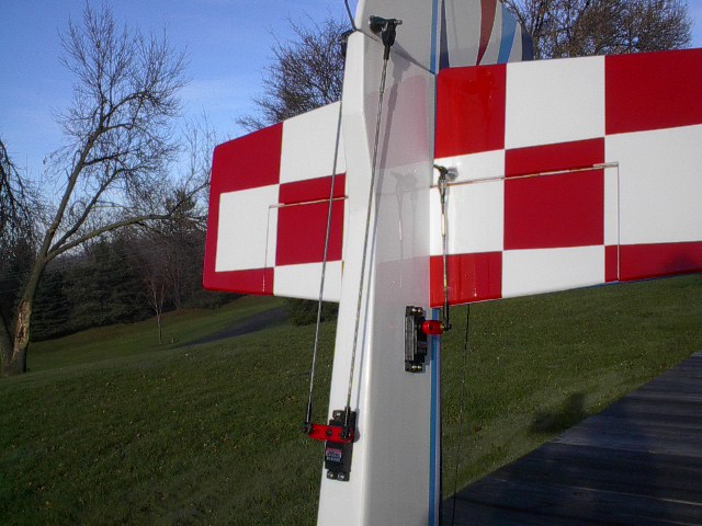

Joe your servo in the belly mod is outstanding and I am jealous. Setup looks clean and straightforward but I have to ask about the hole you cut out to get the servo in. How was that accomplished to be able to secure it place without sacrificing structural integrity?
As far as the ucando Roger/Joe how much right thrust did you put in?
Posts: 2,279
From: Clarks Summit, PA
Matt, It fit in nicely between the glue blocks that run the length of the fuse. Once cut for servo I install two 1/4" X 1/4" glue blocks inside, front and back for the mounting screws. Granted when I mess up the only thing left is the tail, but never any failure in this area. I could give you dimensions for the cutout. If you go too far back towards the rudder it gets narrow and you could cut into the glue block stock. If you go too far forward you will be into the former.
