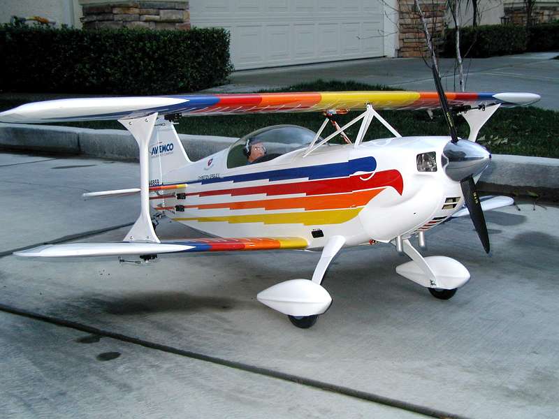

Mine is at 16# with G-38. I have not flown it yet
