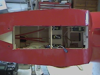

gfpierce,
Thanks for the answers! Yes, that helps.
On the engine mounting-bolt spacing, I mean the space between the blind-nuts on the firewall (assuming a person wasn't going to use the factory mount). I guess what I'm really asking is with the RCS140's rear-induction and different throttle and choke geometry (come through the firewall inside the bolt-pattern), will the mount that comes with the ARF work? I used a Dubro 688 aluminum mount on my other RCS140 install.
It has a wider stance that I thought! That's a good thing. I've seen the GP Ryan STA fly and it seems squirrelly on the ground, with a tendency to tip over and scrape a wingtip now and then. Sounds like the GeeBee should be better.
I've been thinking about the tailwheel. Not very scale... though I don't know if I want a wheelpant on the tailwheel. That would be too strange. It's just that it looks so small in the pictures and I'm worried about it holding up on our rough grass field.
Thanks for the landing-gear-strap idea for holding the wing together! I really want to keep it removable, as I don't have an easy way to transport an 82" wing in my truck.
Anybody have more pictures?

pacific models gee bee-Y arf
Your welcome!
Yeah the ground handling is very good. It does like fast throttle on takeoff tho! Slow advance seems to result in a ground loop!
The roll out on landing is great. You wont need any wingtip protection on this bird!
The faired tail wheel is scale. Its just a little too far back because of the spring coil. It should be just aft of the hingeline.
As far as the engine mounting goes, I stand corrected. They do provide the holes drilled with blindnuts installed. I had removed them, drilled the holes to 1/4" and inserted 1/4" dowel 1/4"long to fill them. Then I relocated my own! Sorry, I dont remember the spacing.
I used the LG strap Idea on my 80" World Models p-51 Which is basically the same. I was afraid it would separate to but the flightloads wont allow that to happen especially with the wing bolts and the keying of the LE wing location. Its on each wing half and they both go into the former as dowels! If they come apart....
Youre already in the ground
Oh I Was able to use my camcorder
This is one Bird thats definitely worth the bucks
